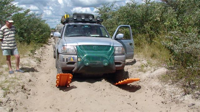

Dieselfan this is what those sandy roads look like: The sand from the tracks pile up just next to the tracks, and there is actually a hollow in the middle.dieselfan wrote:Hi JG
Just to comment on your opinion about the D3 lowering at 45 over sand...the D3 has IRS and IFS, looking at Patrol WHY is it the the front and rear diffs don't line up like a LC? Surely the Diff's are low too for a Patrol and would cause issues with Middle Mannetjies? The LC has the diffs neatly on the side.
Cars with both diffs on the side actually struggle more under these conditions.
The other thing you need to consider is that while ground clearance is only measured in one spot under a car, under conditions like this that is not the only place that may cause problems.
On paper a Pajero has more ground clearance than a Patrol, but anybody who has ever been on a rough trail where both these were present will tell you that the Pajero dragged everywhere while the Patrol almost never touched. This is because cars like the Pajero and D3/4 have virtually flat bottoms, but on the Patrol the diff pumkin is lowest, and every other part of the car has 75-100mm more ground clearance.

Dieselfan, I can not comment on the position of the diff pumpkin relative to the front and reas diffs of the Patrol vs LC. Only the design engineers will be able to answer that question. What I do know is that the solid diffs makes driving in deep sand (other than dunes where the "road" profile/surface remains fairly constant) tracks such as northern Botswana much easier than independent suspensions. As for the picture above of Jaco's Hilux, the problem with his IFS lies in the bulldozing effect of the IFS of the sand. Once a little bit of sand starts to accumilate in front of the suspension, your trouble is booked.
In my view a contributing factor to the problem lies in the fact that the entire middle portion of the suspension lowers (variable ground clearance of the suspension) under load and bumby conditions such as these sand tracks. A solid axle ground clearance remains constant. The D3/4 is the same than any other independent suspension vehicle although it has the option of a raised suspension to compensate for this problem. In fact it works very well since the suspension's ground clearance remains fairly high which makes driving in sand a pleasure. Unfortunately it is limited to a maximum speed before it lowers itself. The design is good but the practicality of the speed limit is stupid. We all know that the D3/4's "mommy goes shopping" mode/profile is very low. When the D3/4 is used in the "mgs" mode in sand, the belly becomes a road grader.
