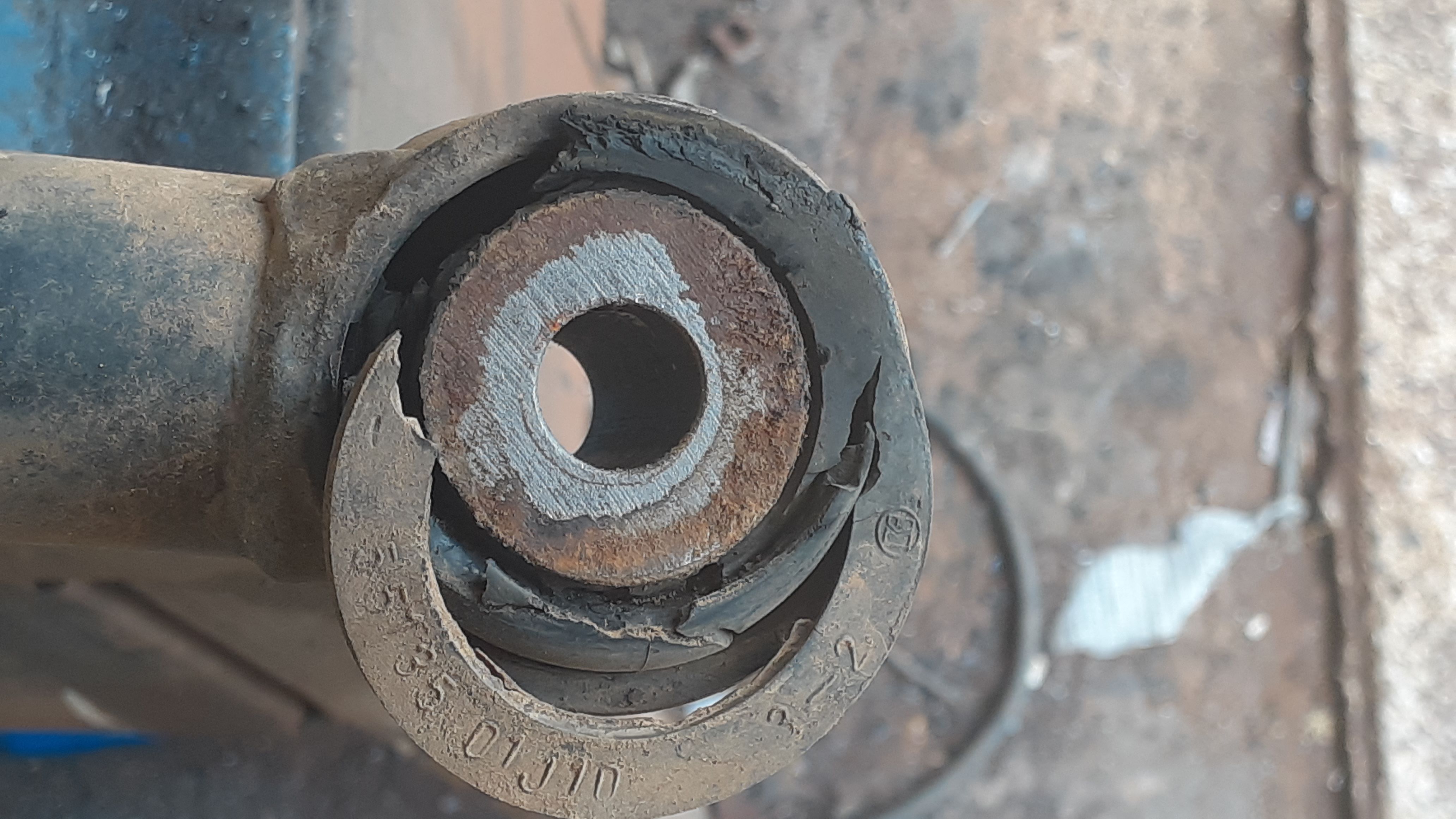

Our cars are well known for death wobble, but I am pretty convinced that they are actually very forgiving in this regard.
Mine recently started throwing the odd tantrum, to the extent that I didn't feel confident to just accellerate through the wobble as I usually do. Even so, it would only pick up a wobble about onc3 every third drive.
Pulled out the front panhard rod this afternoon, and this is what the chassis-end bush looked like:
I reckon that's pretty amazing. Fortunately I had a set in the garage which I had bought a year or two ago when I replaced the rear suspension bushes.
Keep in mind, I believe these to still be the originals, which are now 24 years and 415k km old...
