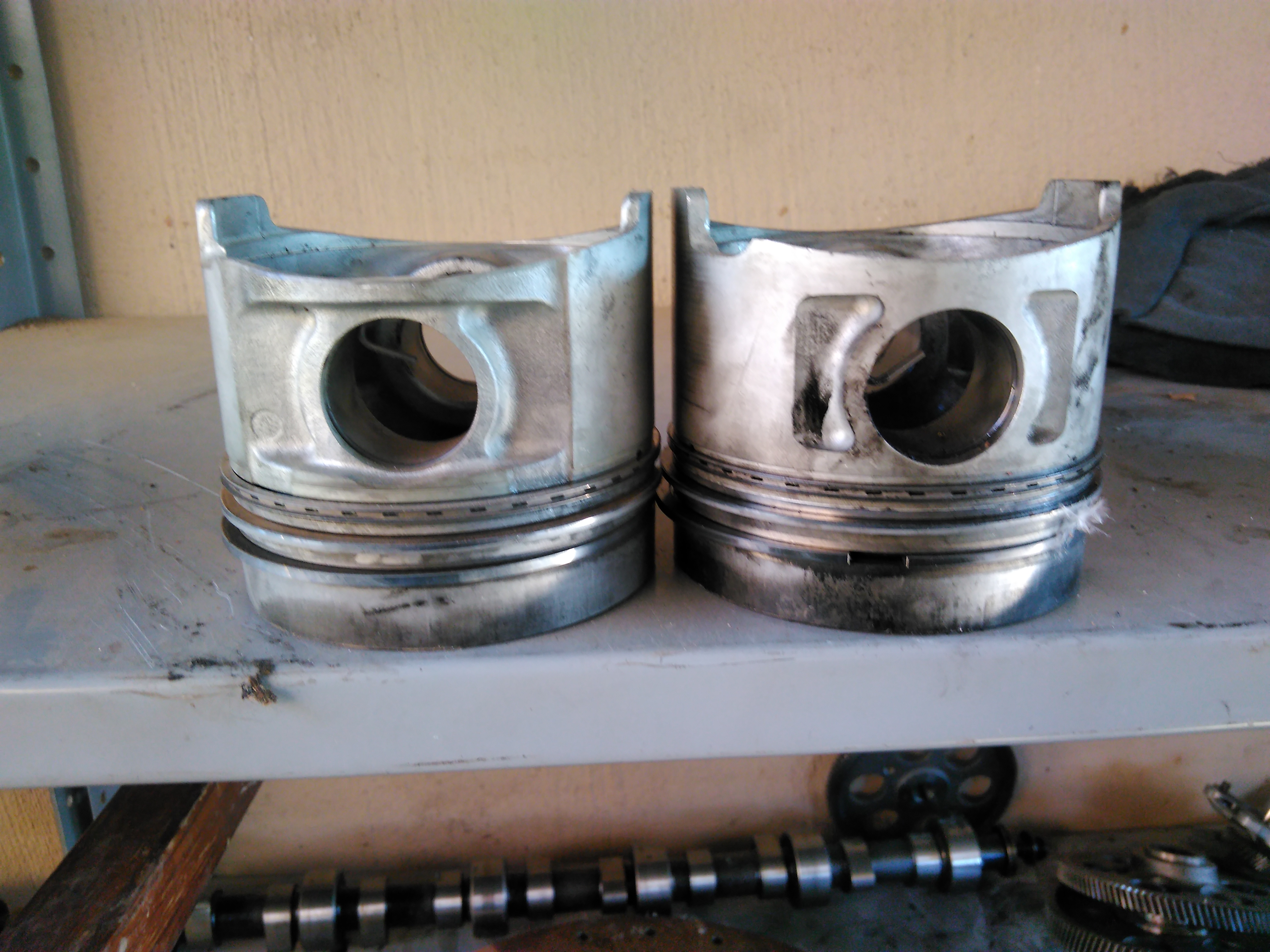

This conversion was just aimed to get his Patrol out of "donkey mode". The engine is in a really good condition and after a compression test and noticing the very elusive silvertop pistons I think the engine will give him many happy km.

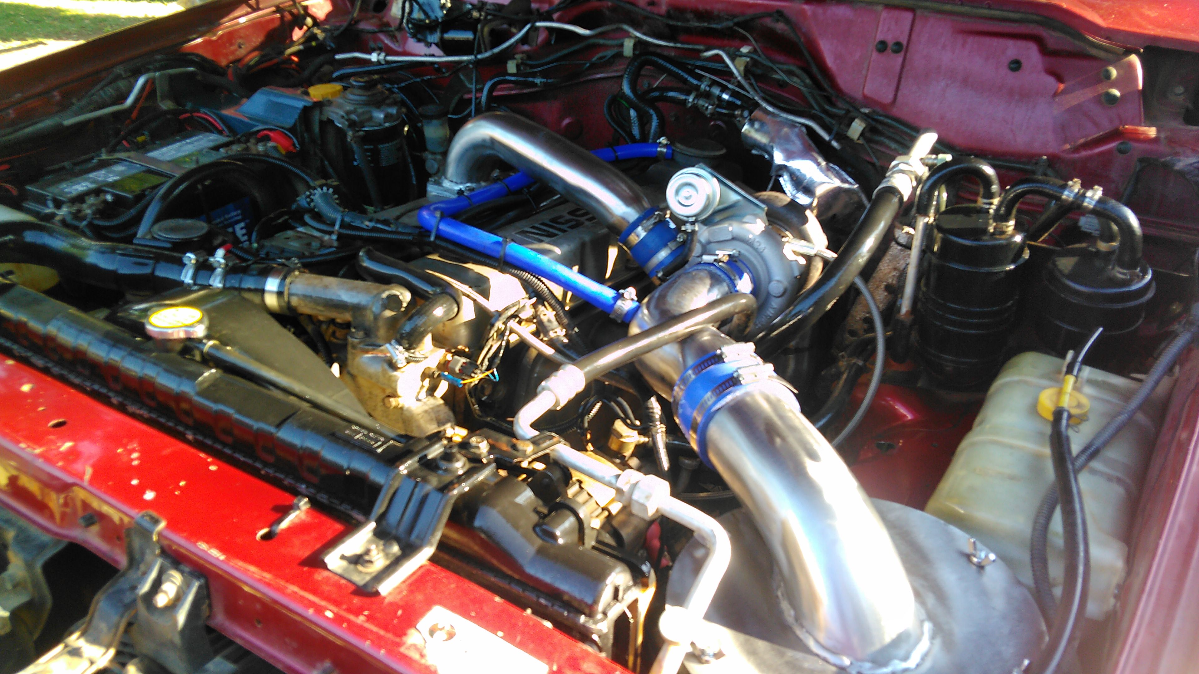

turbo setup
turbo setup

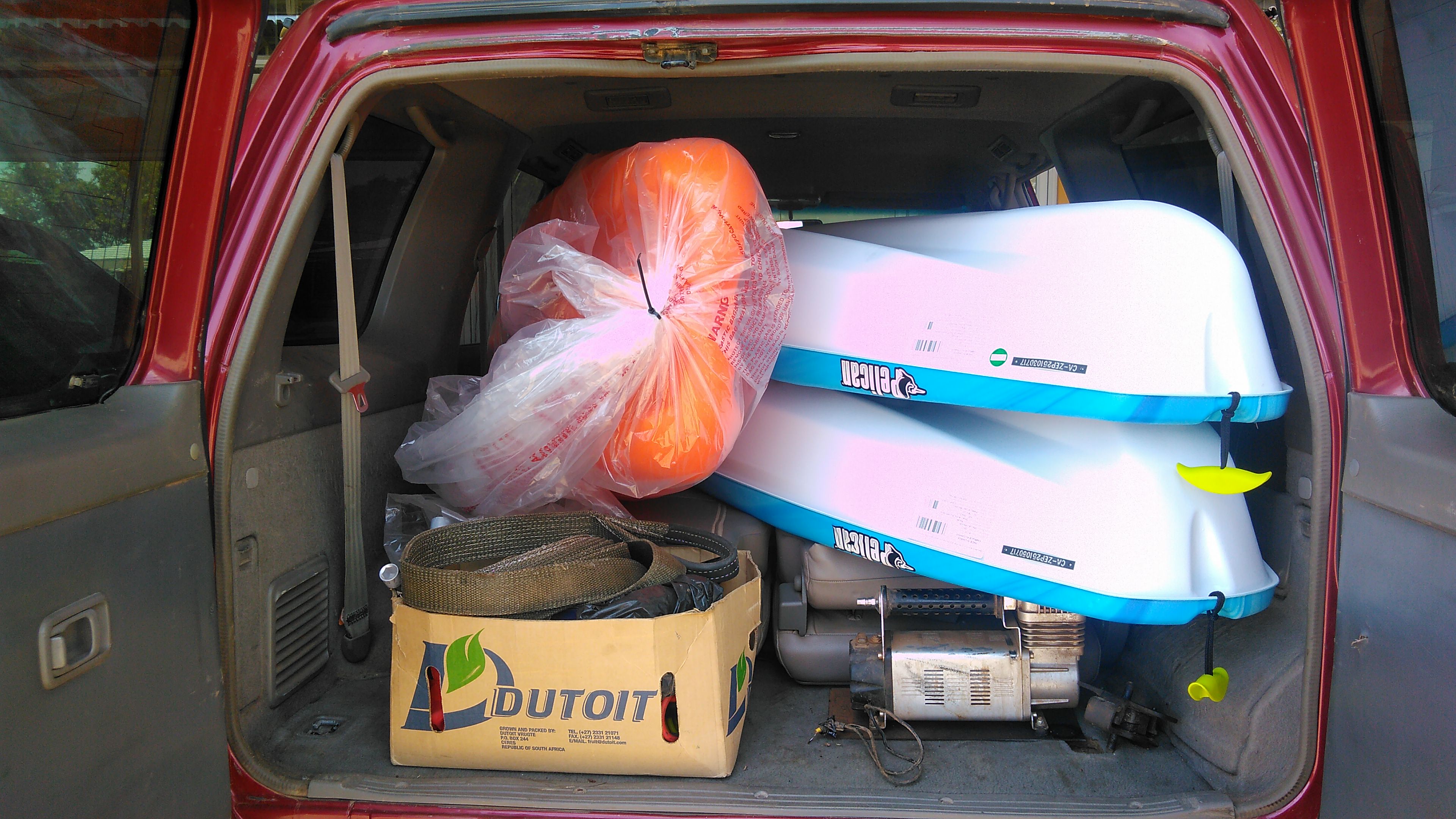

'n Patrol kan sluk! - onder andere 2 x 3m kajak
Standaard piston vs Silwertop

That motor is looking GREAT Chis :thumbup:
P S ever heard of a roof rack for the boats?? :rolling: :rolling:

Looking sweet ! :woo:
Michael does some awesome work :thumbup:
