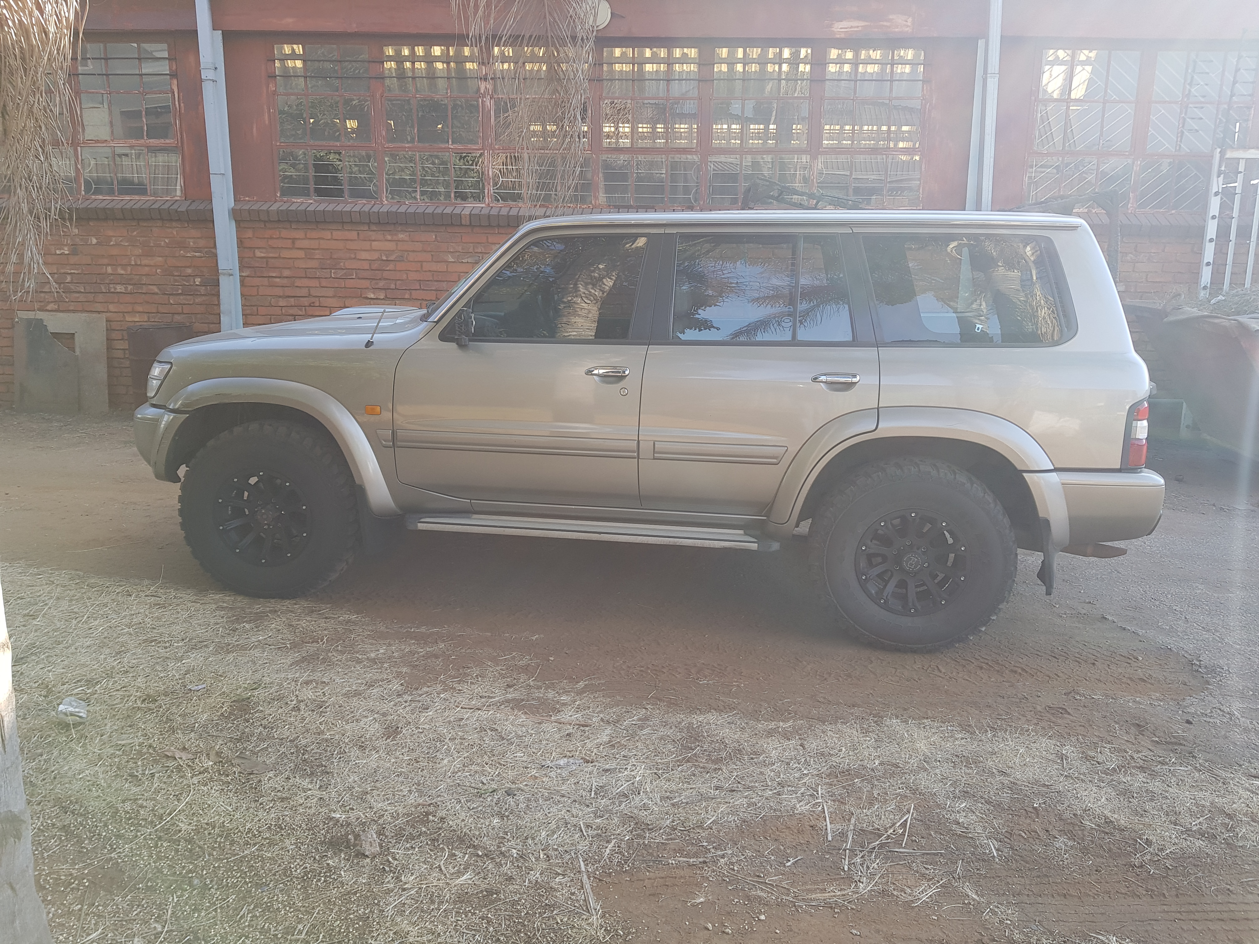

My 4.5 GU officially a 4.2 Diesel now

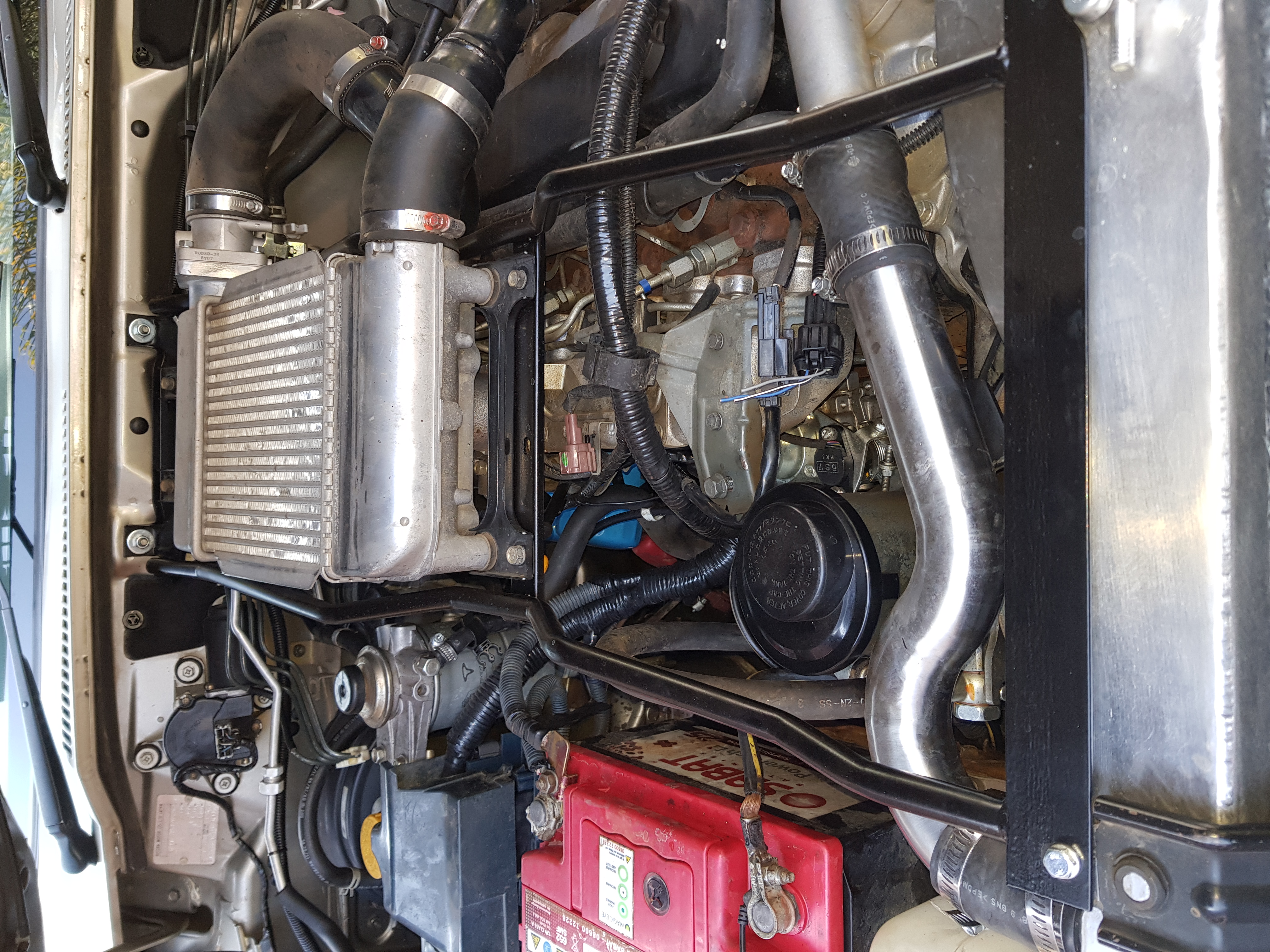

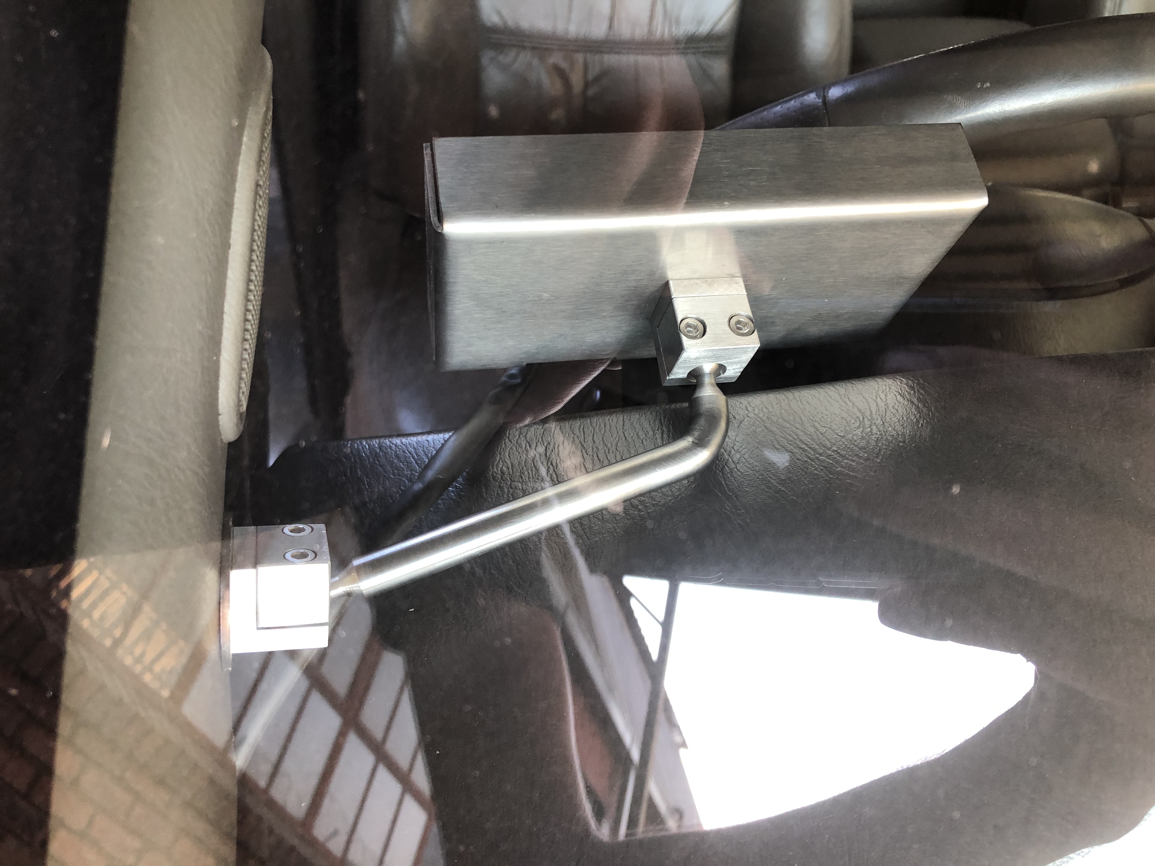

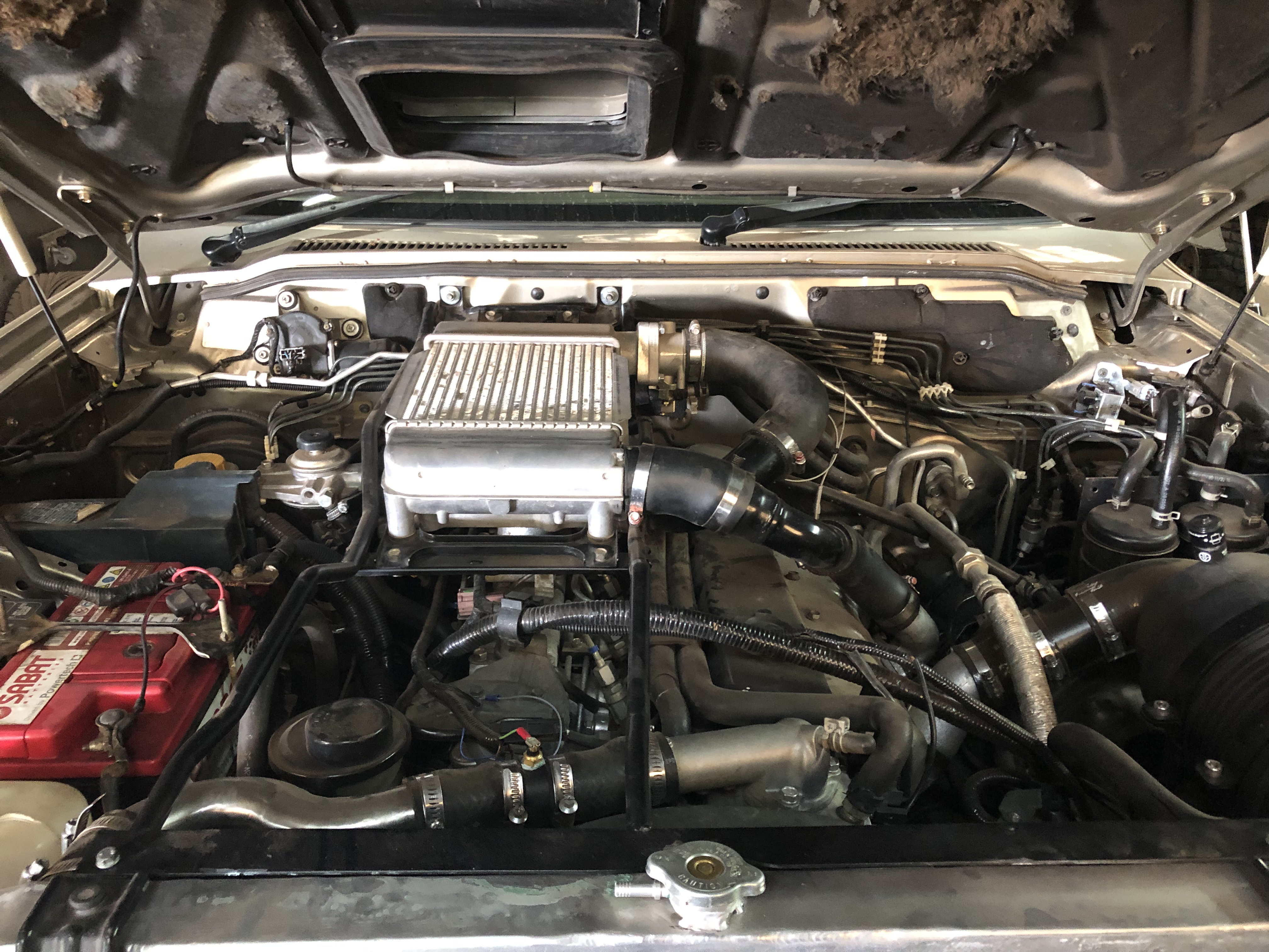

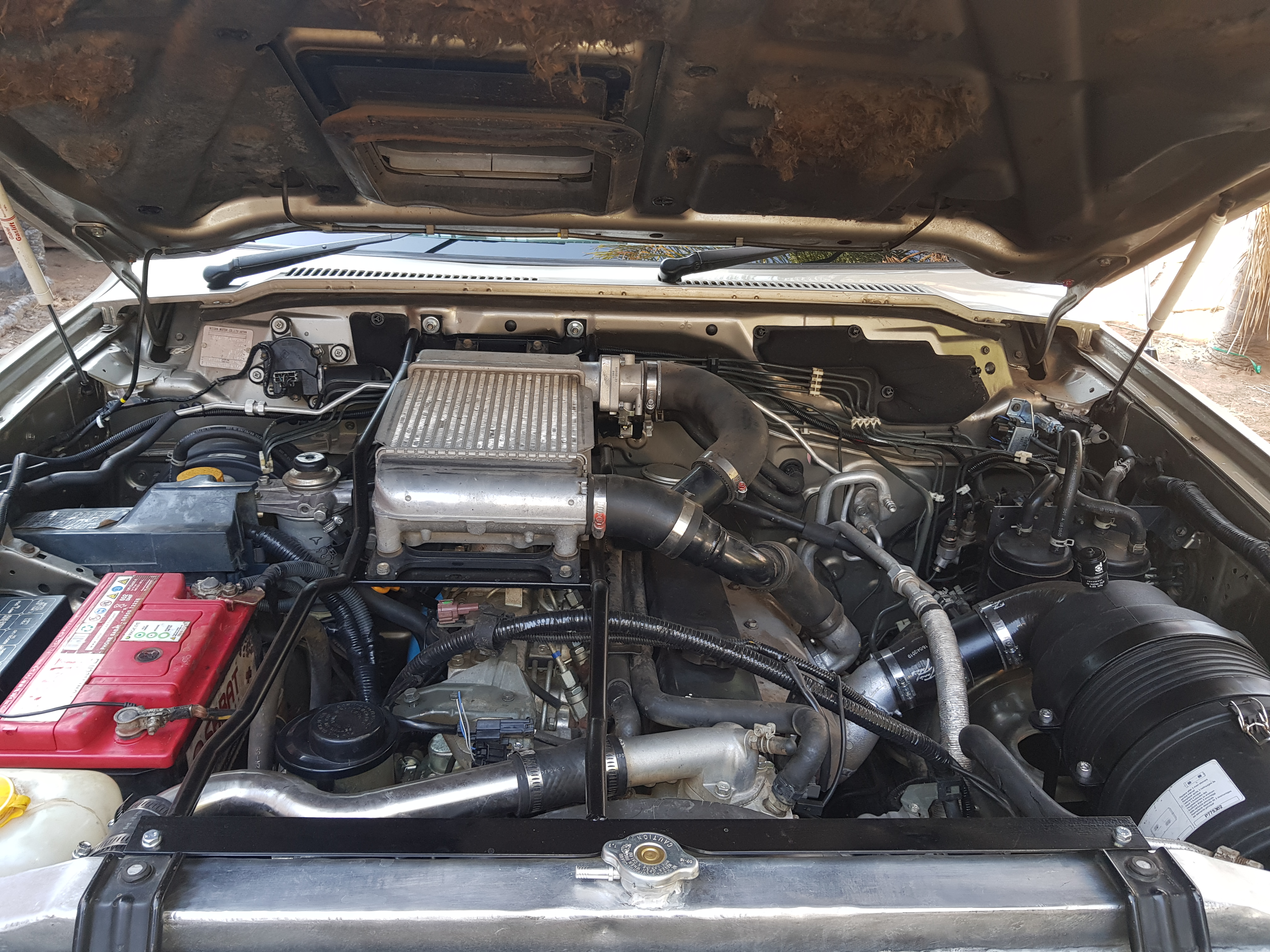

Finally had some time to take a few pics next week the madman will go in

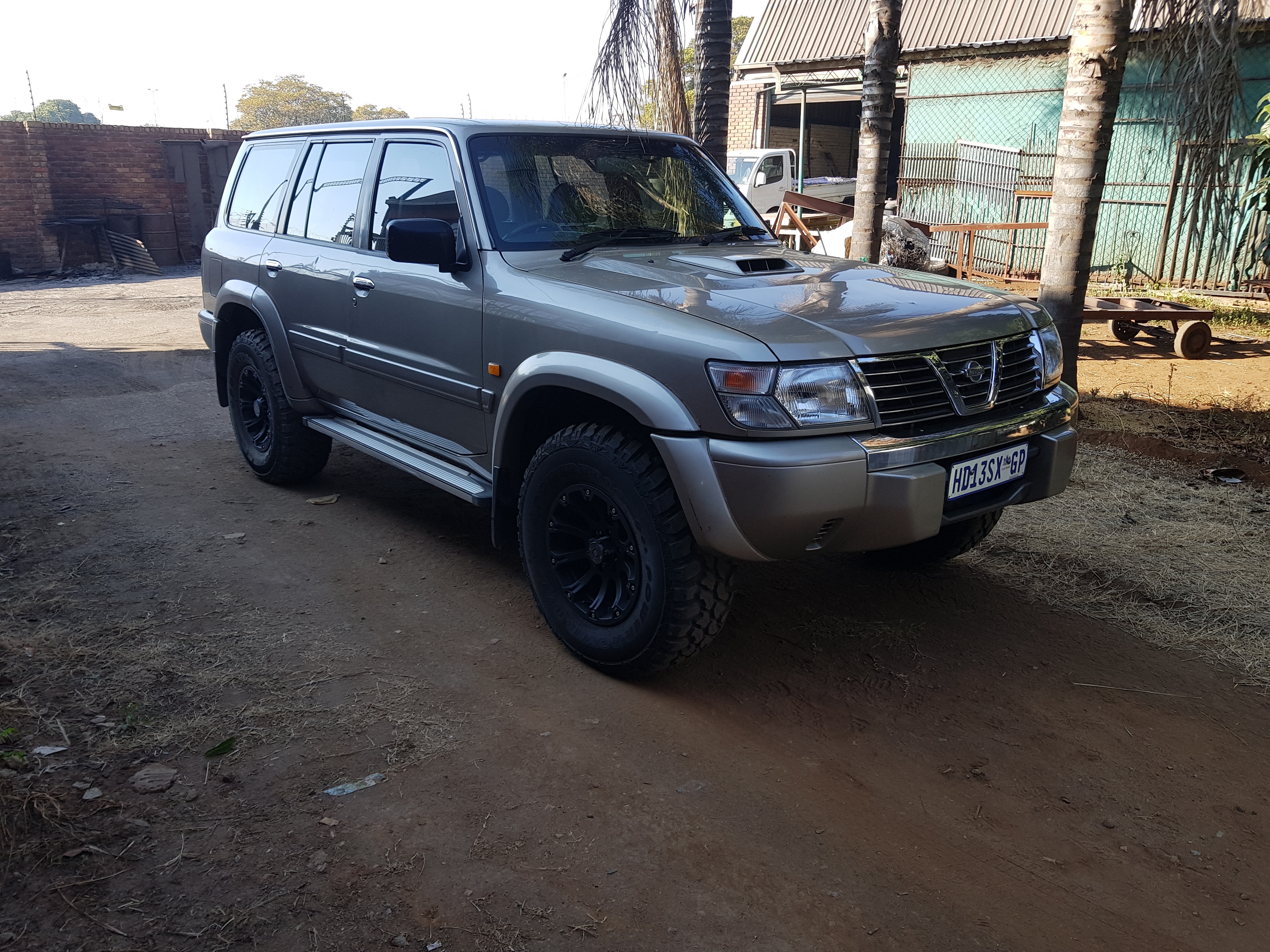

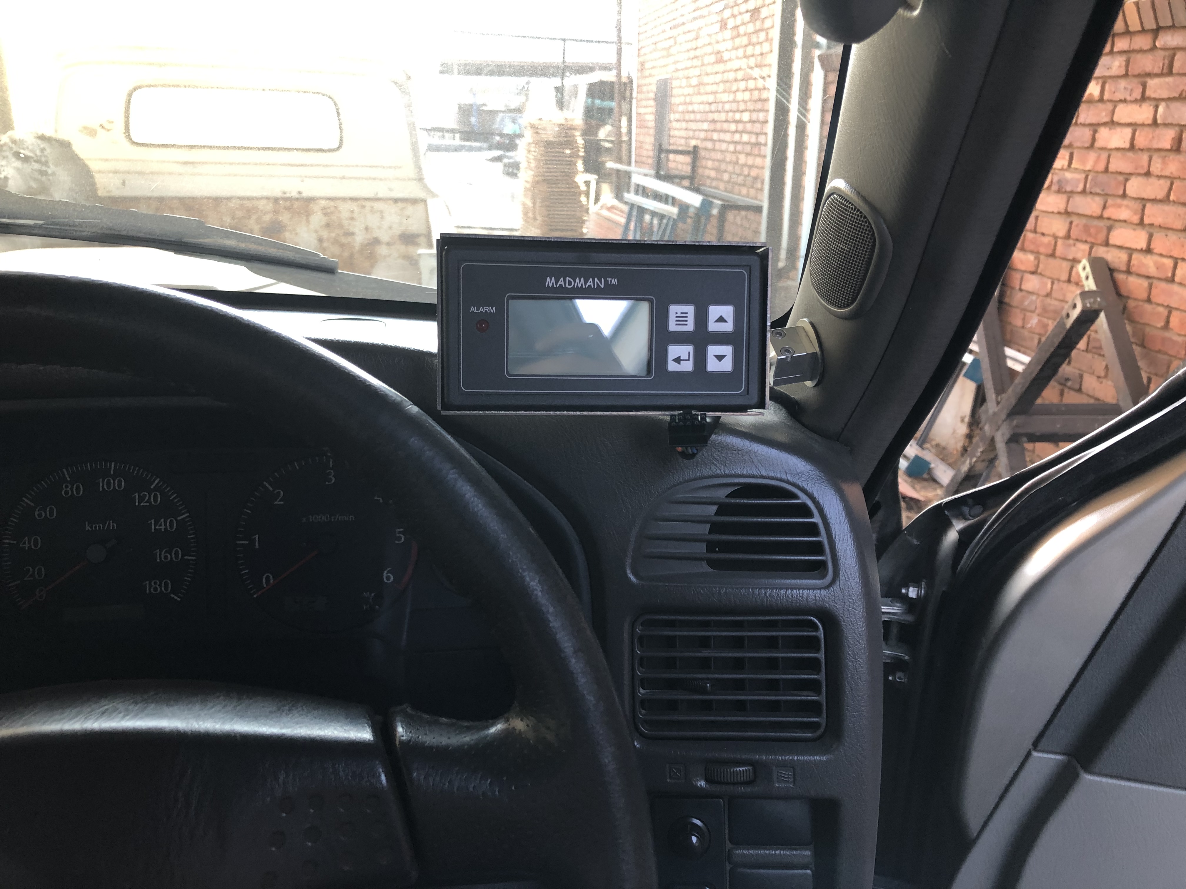

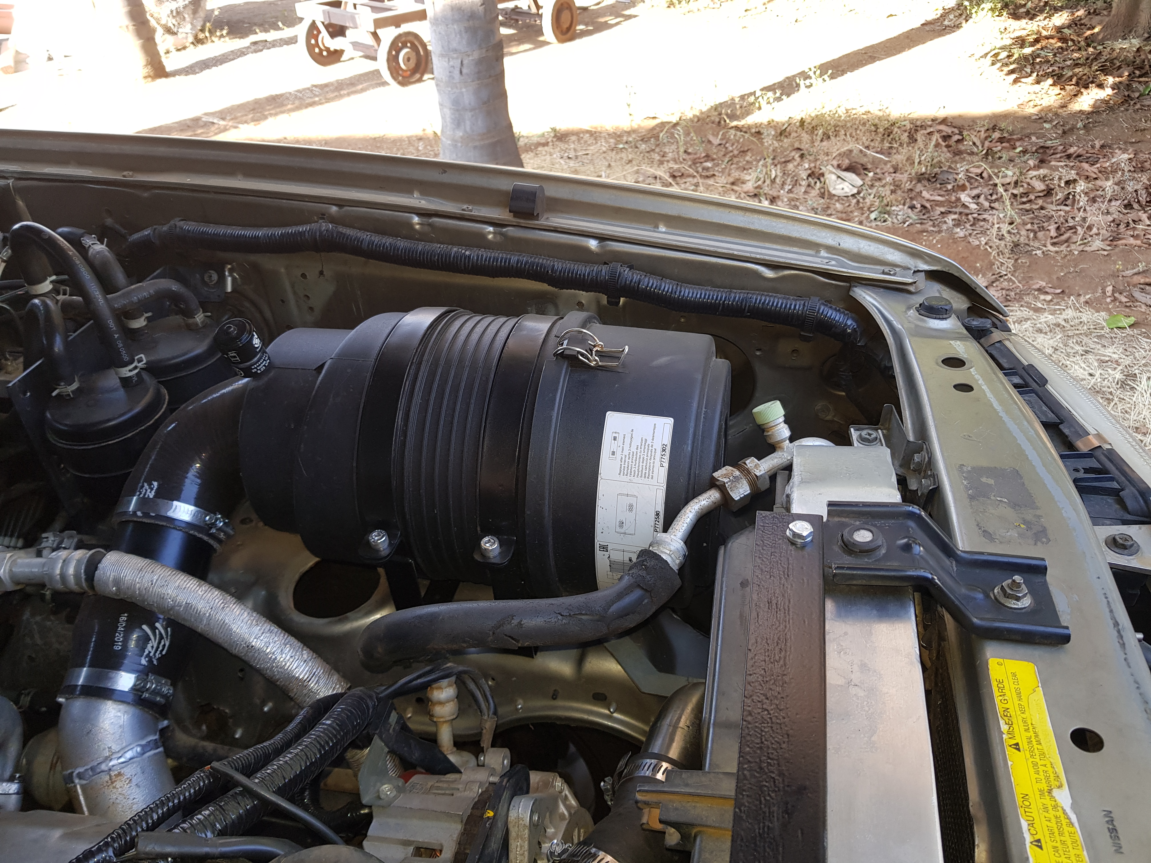

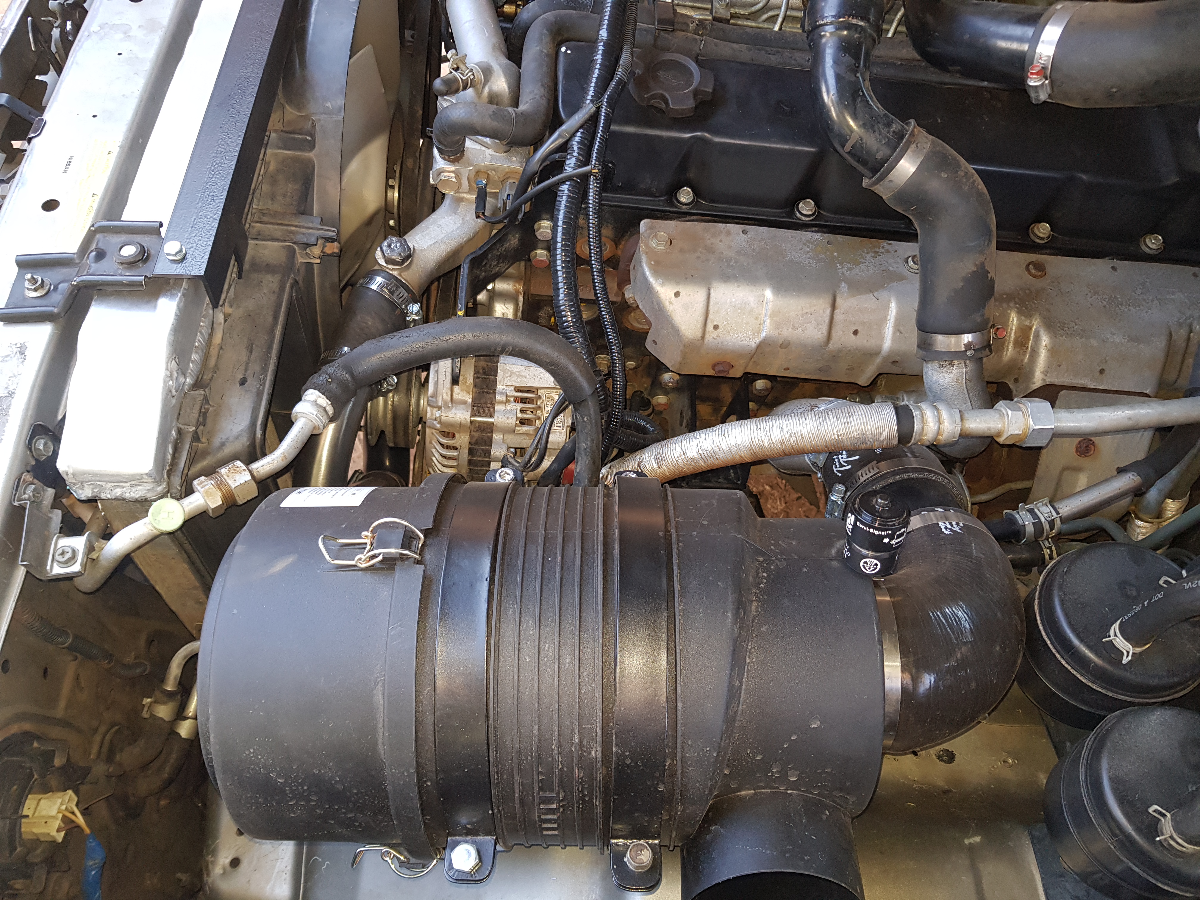

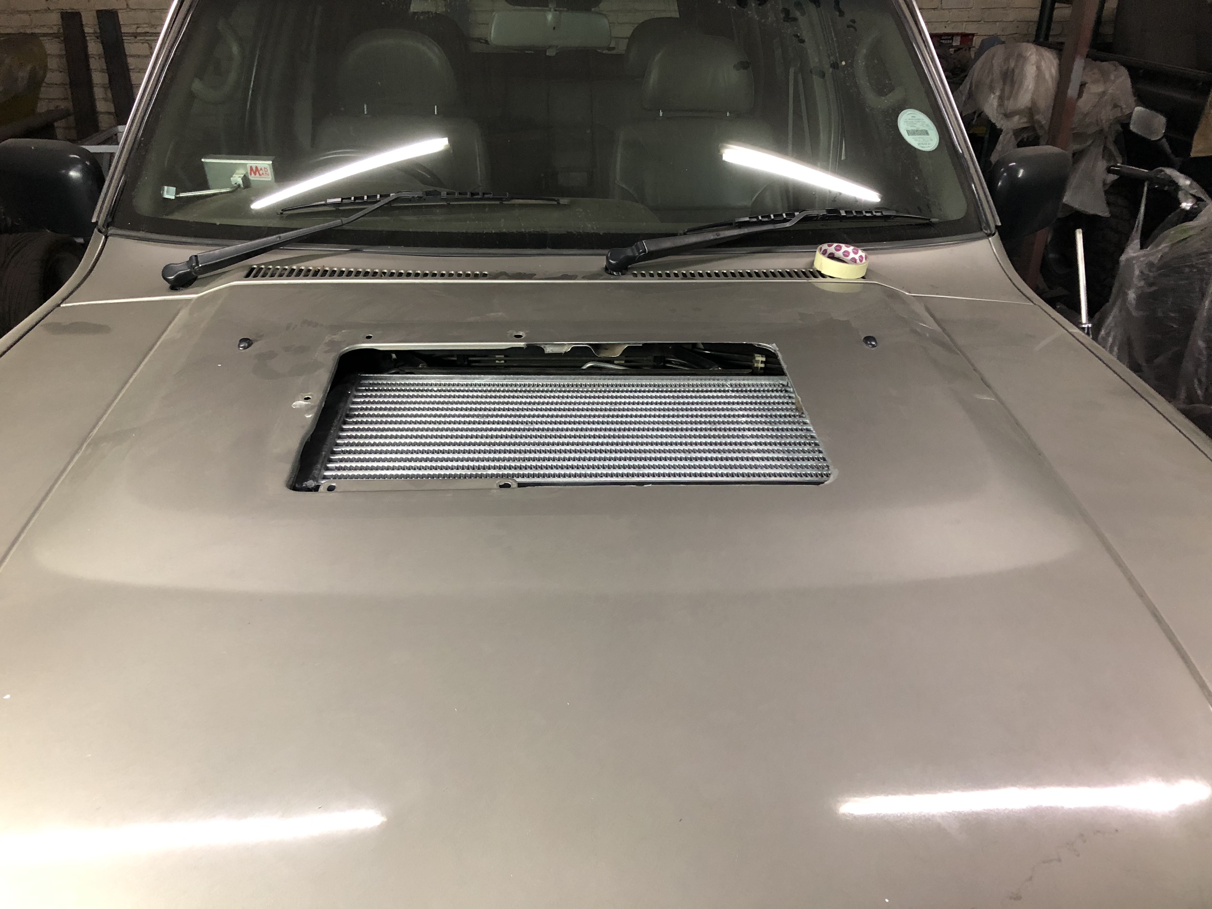

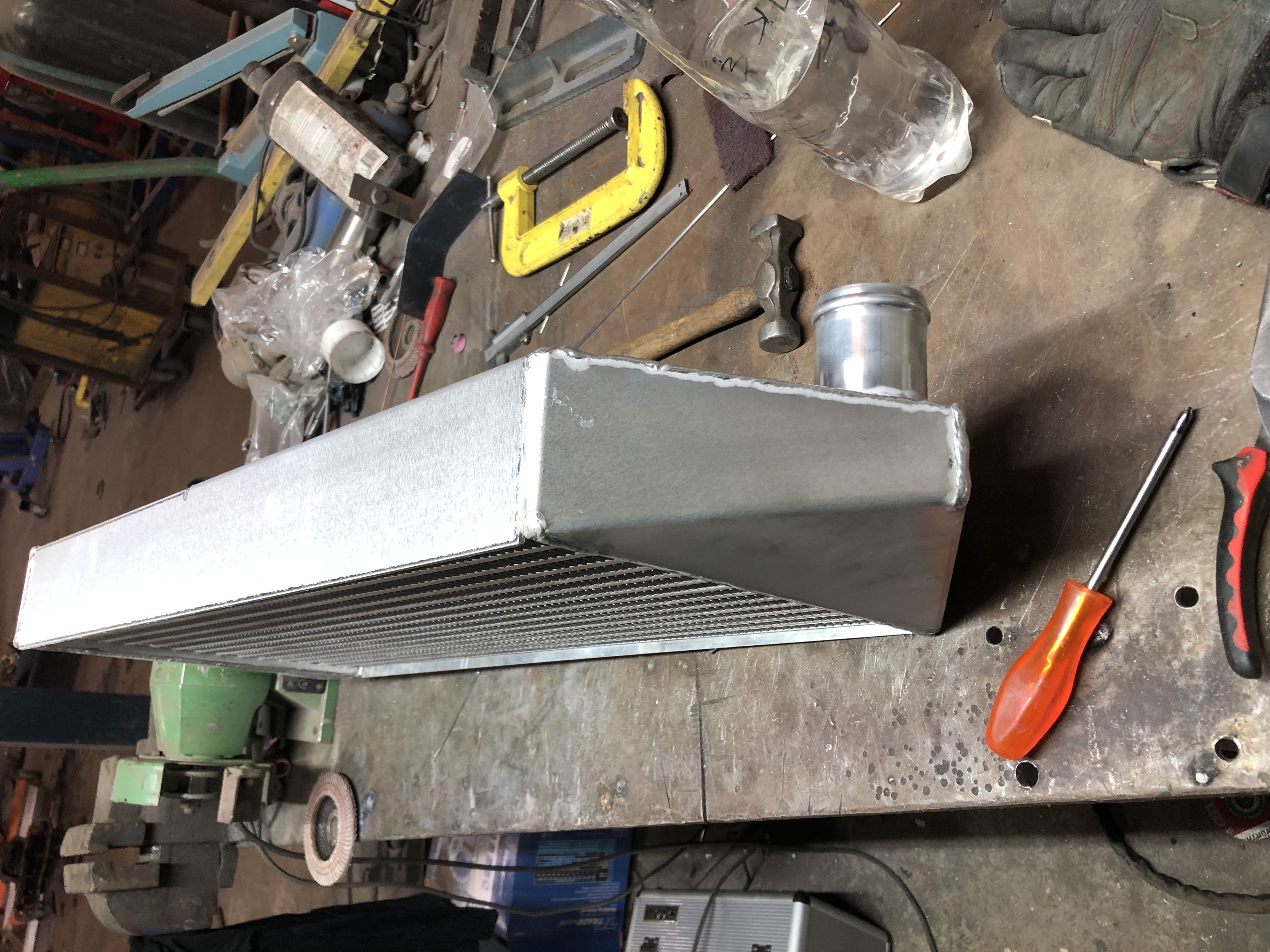

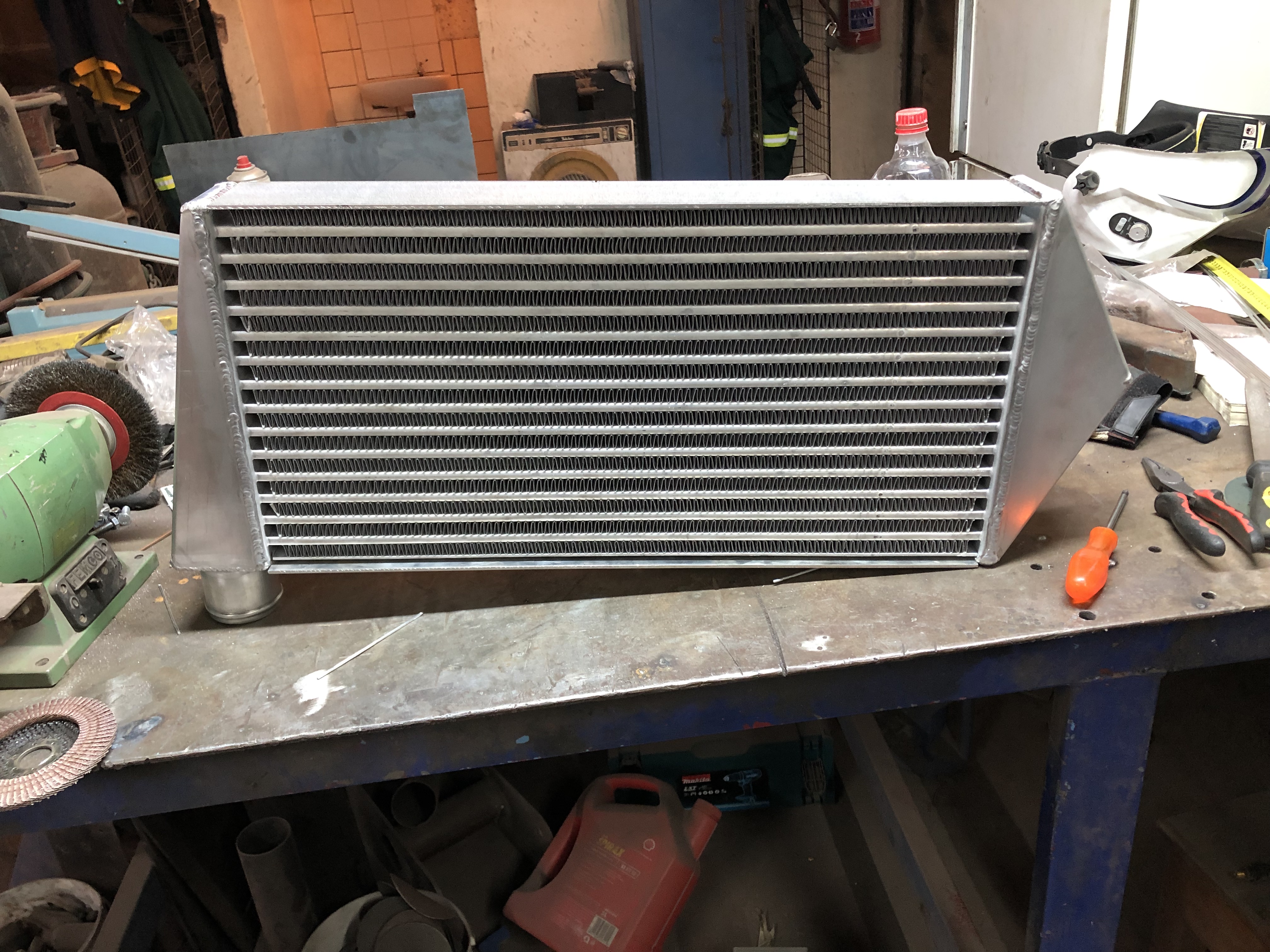

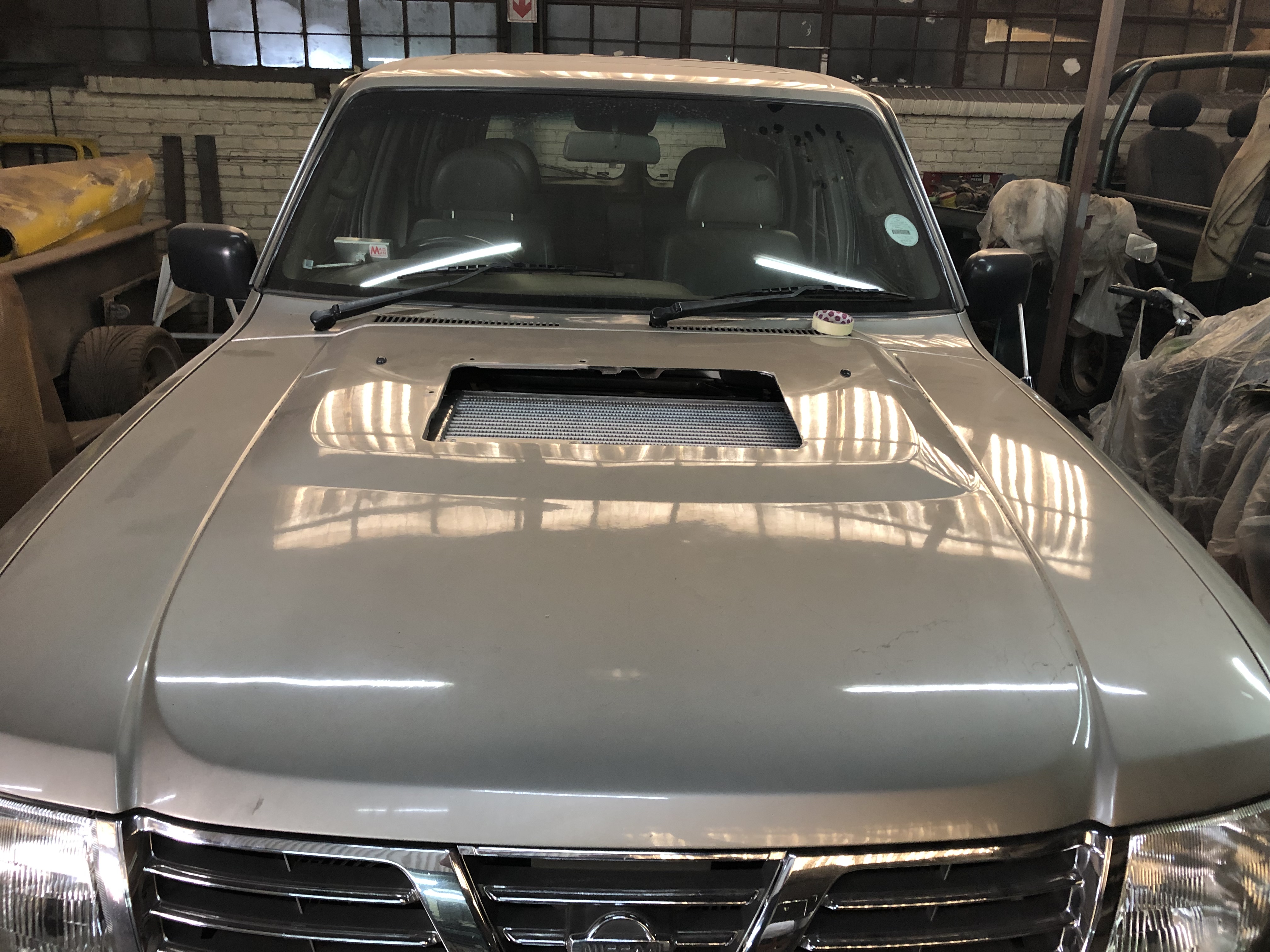

It’s been a while since i posted something.But here it goes.Since the last time i did manage to install my madman after some brackets where made.

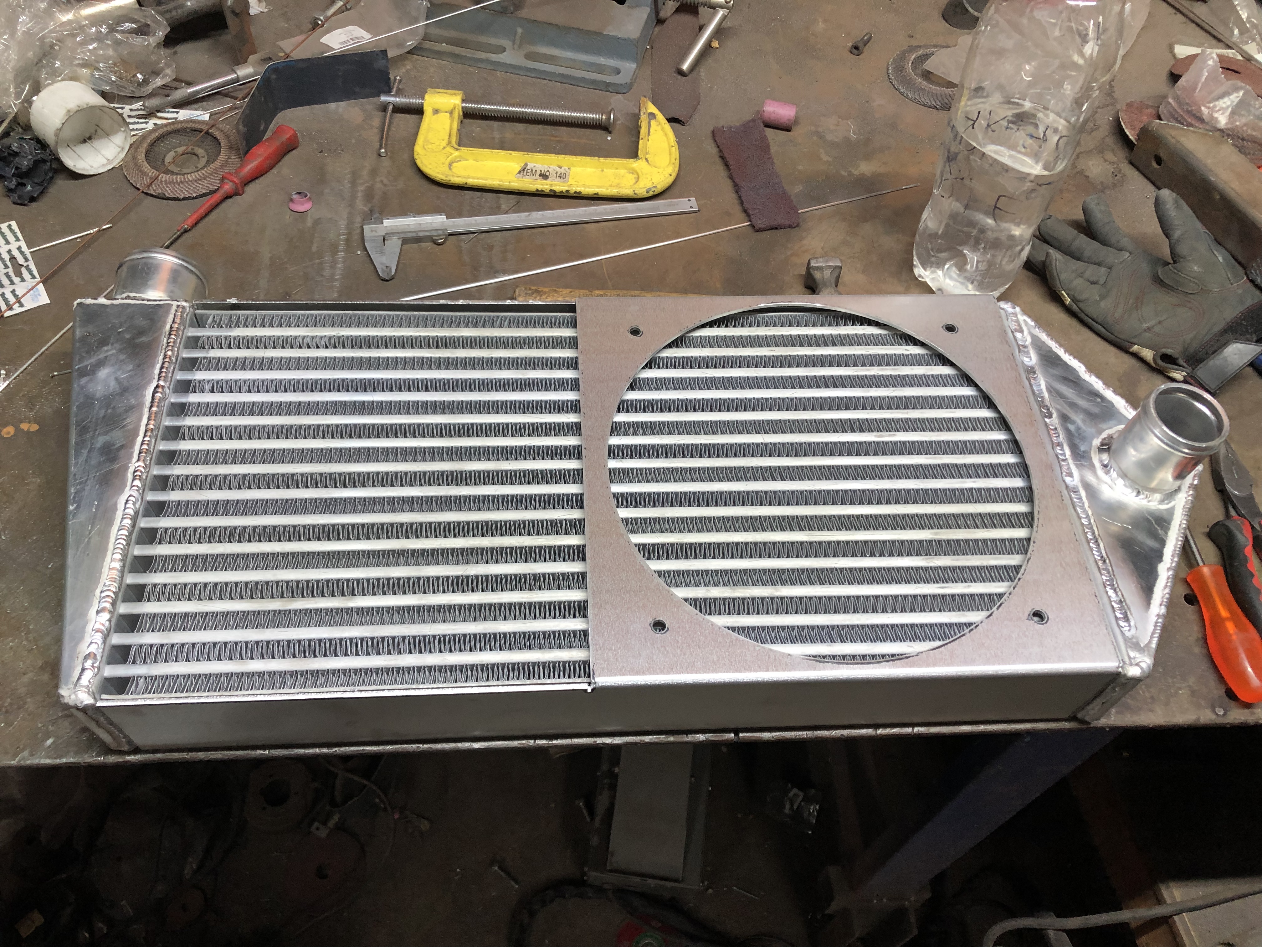

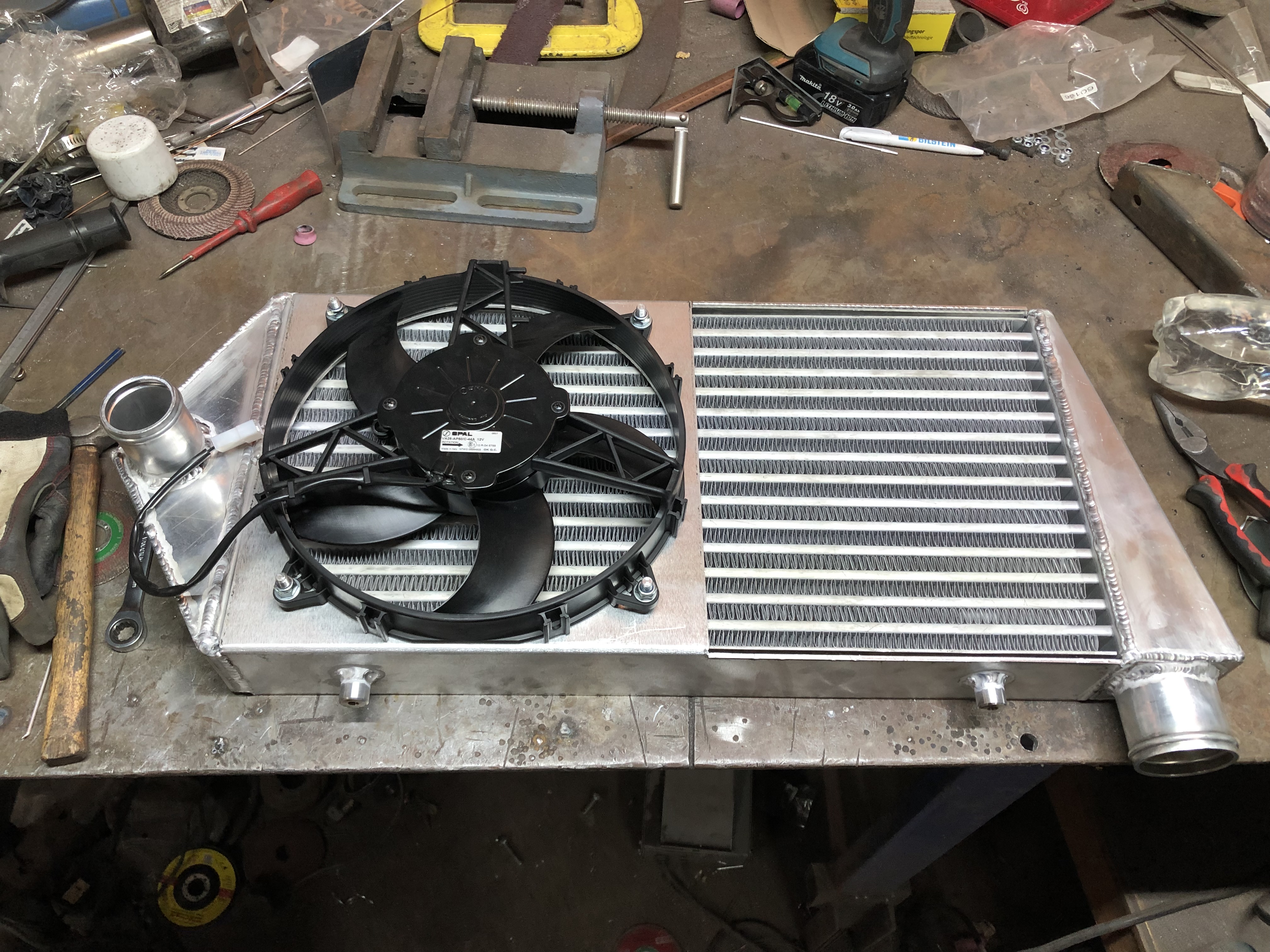

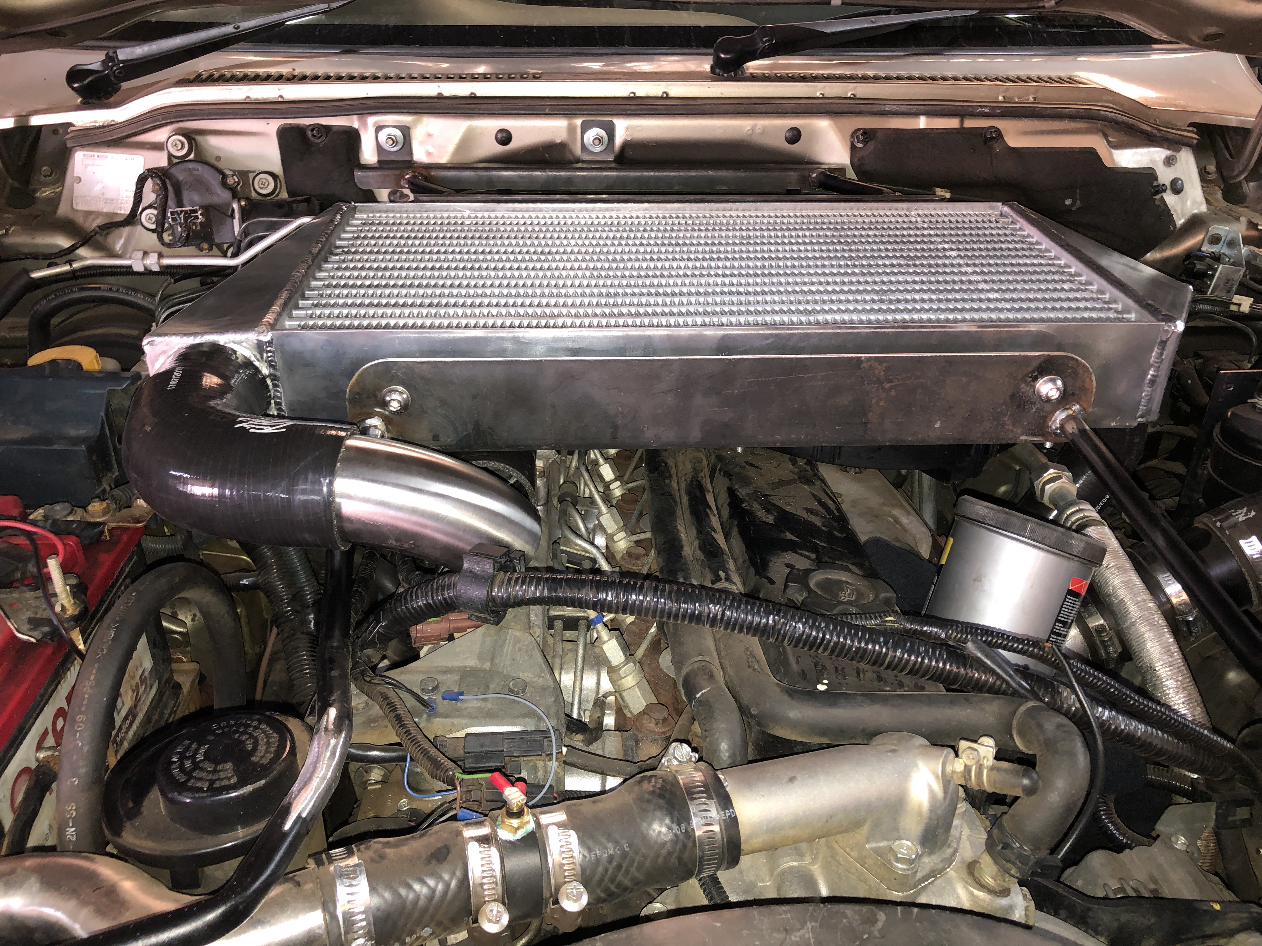

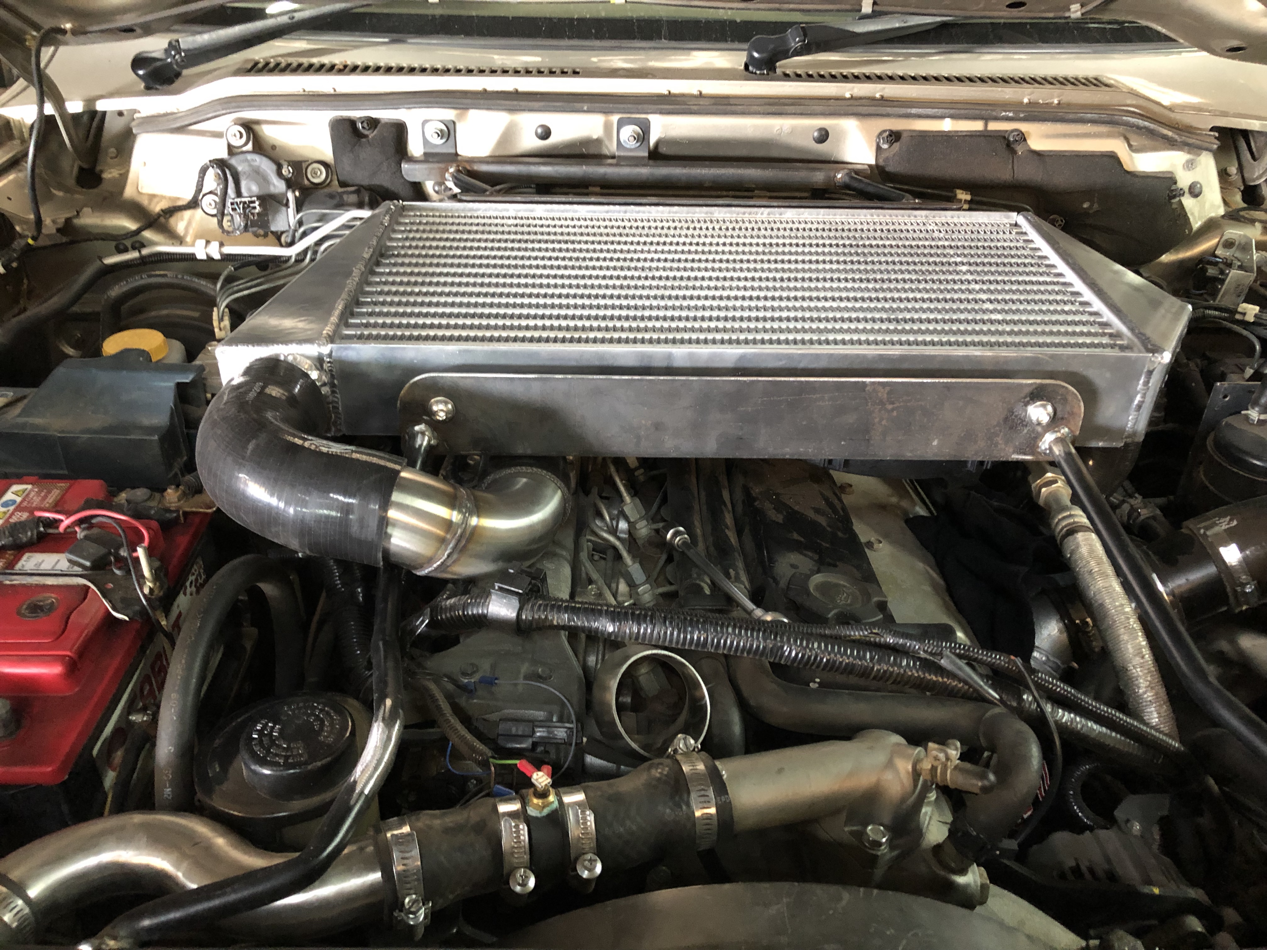

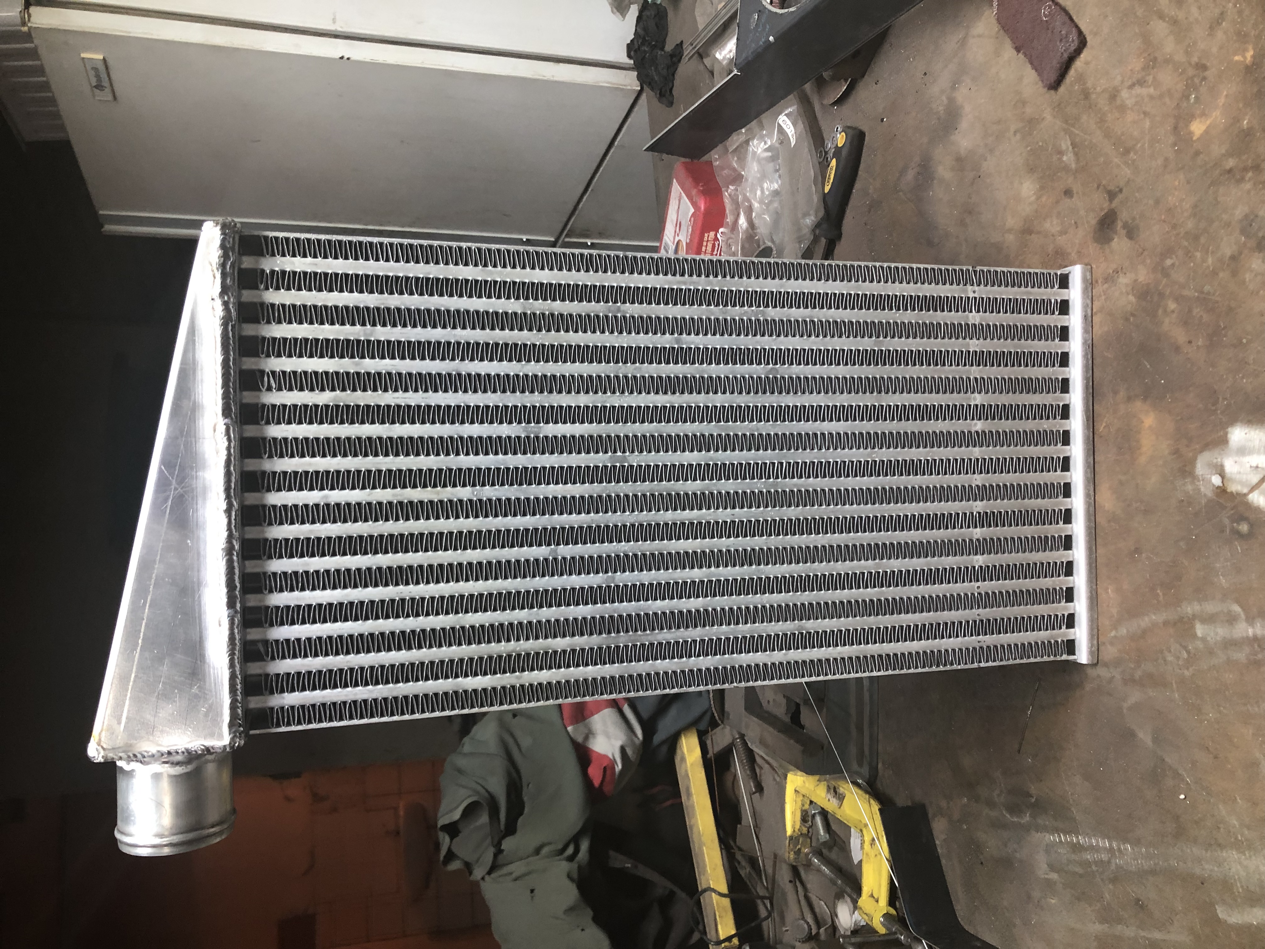

And then on the next topic which some will probably tell me it isn’t effective enough.But since the aussie’s use them and get good results from them,I bought myself a leke big intercooler core made up so 3mm tanks and cut a gigantic hole in the bonnet.The bonnet scoop will get made up with in the next couple of days and will post some photos of it.
Re: My 4.5 GU officially a 4.2 Diesel now
Mooi gedoen makker
Now THAT is a sweet intercooler ... I like it !!! :thumbup: :thumbup: :thumbup:

Well done and I like it! What size fan is that you put on the intercooler?
Seandp
Posts: 61
Joined: 30 Apr 2019 13:46
Full Name: Sean Du Plessis
Nickname: Sean
Current 4x4: Suzuki sj 410(toy)
Gu Patrol 4.2tdi GRX (Also on the smokers team now)
Has thanked: 9 times
Been thanked: 60 times
Post by Seandp »
It’s a 12inch spal fan best fan money can buy on that size sucks about 1250cfm must say its worth the money spend if you compare it to any other fan of its size
