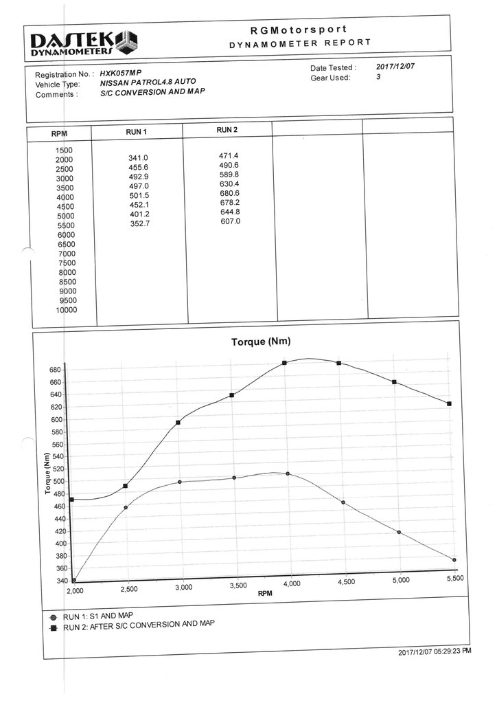

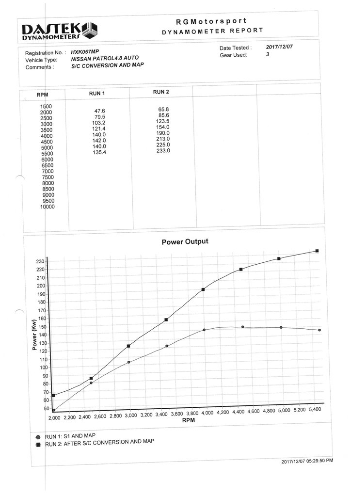

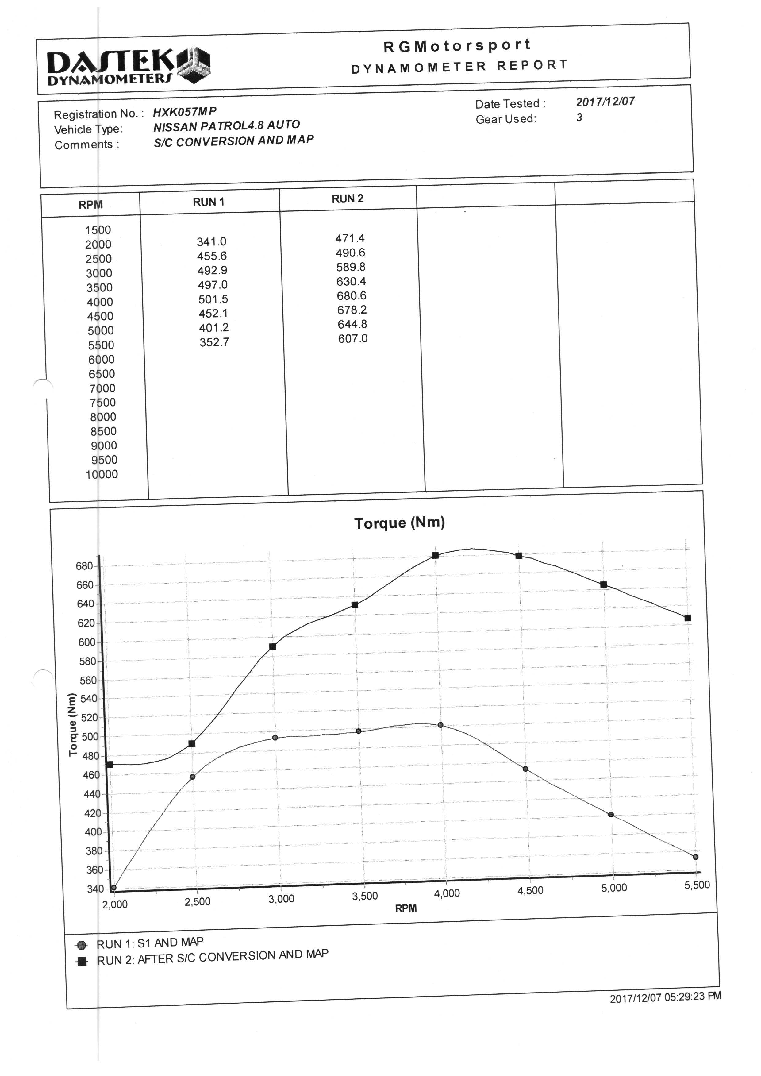

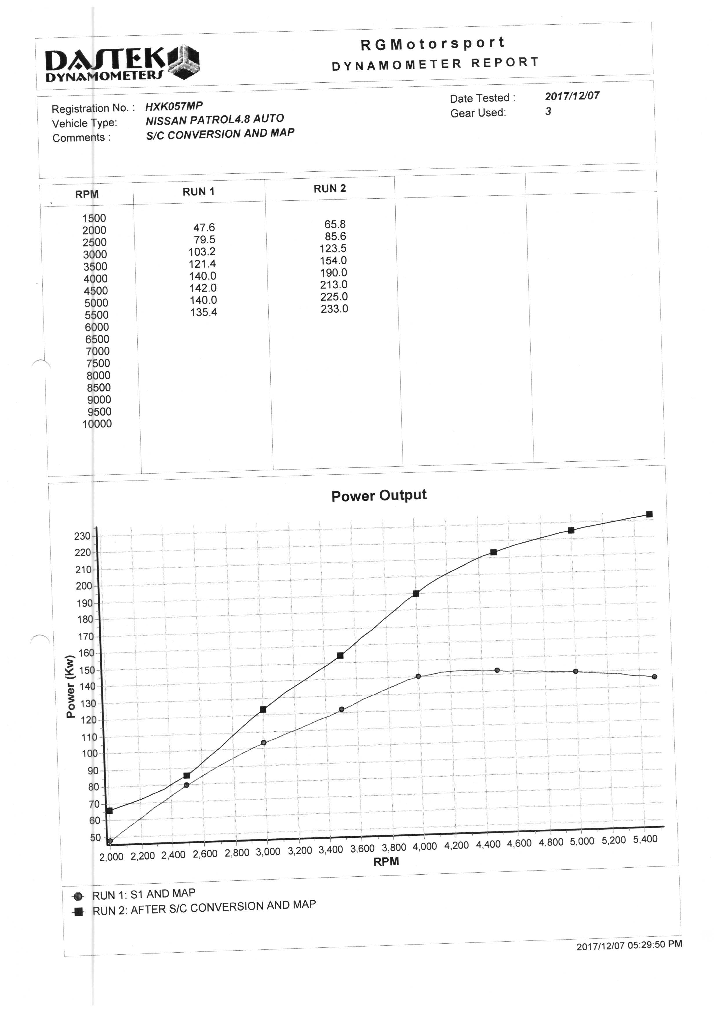

I have just dyno'd my Patrol to get base results before super-charging.
I don't have the graph but my readings off a standard Patrol, standard exhaust etc were 134 KW at the wheels.
My previous Patrol Stage 1, similar to what you have just had done, figures are pretty much in line with what you got.
You need to look at run 1 as that is stage 1.
The Run 2 is after super charger.
I don't think RBTS is too far from reality if you compare your graphs with mine.
Although I cannot vouch for them or SAC having used neither.
I maintain that on a NA motor your biggest improvements will come form an engine that tuned optimally.
And then those results again will differ dependant on the skill of the said tuner.

So if my current standard run is 134 kw,
After stage 1 on the previous patrol i got to 142 kw
That is a mere 6 % improvement, I've always understood that around 8 % is the best you can hope for with exhaust and chip.
Although I'm taking results from two different vehicles, I would imagine they would be reasonably close in stand rad from.
My new Patrol however does feel stronger standard than the one I had before ... standard

I looked initially at the KW graph
But if I look at the Torque graph the numbers look poor.
Is that because they calculate figures back to the wheels or are those flywheel values?
There is another thing here, is your petrol pump delivering enough fuel?
I know a lot of people dont like RGM, maybe its their pricing, I'm not sure but if they break something they will fix it and if your readings are not what they should be they will investigate why.
I suspect your exhaust system has lost all your torque, in that it is 76 mm all the way through, so you have lost the low down and only have power at the top.
Ideally the down pipe should be around 57mm to provide a bit of back pressure and then go to a larger pipe after the first box.
I'm no expert but that's how I understand it, in that you need a bit of back-pressure to give you the low down torque.
Rather than straight out power at the top.
In you current scenario, I dont think youre going to be happy should you tow.

Thanks for that info. I was also expecting about 5%-10%, which is makes me doubt the 30% increase quoted by RBTS. In any event they are what they are.Mystical_Beast wrote: ↑17 Jul 2018 16:59
Interesting hat after your stage one you peaked at 500NM and 142KW whereas the highest i seem to read is around 318NM and 131KW. Surely that torque difference points to an issue?

Mystical_Beast wrote: ↑17 Jul 2018 17:15 I looked initially at the KW graph
Those are back wheel numbers
I actually agree with you but had both the guys at SAC and Viper insist that they needed to be 76mm all the way through (after the branches). RGM did explain the way you did
and that was the only reason i was doing this....
