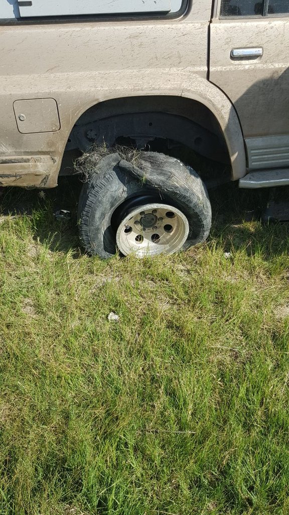

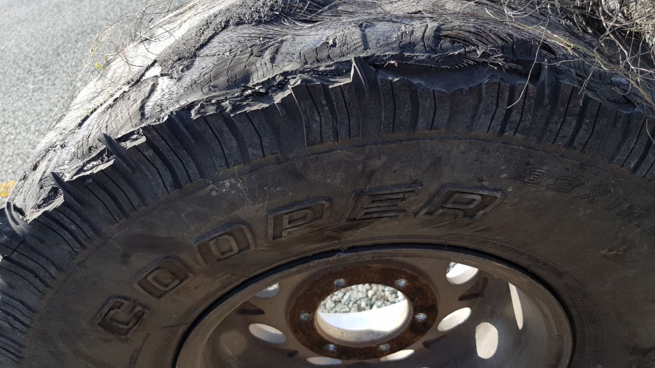

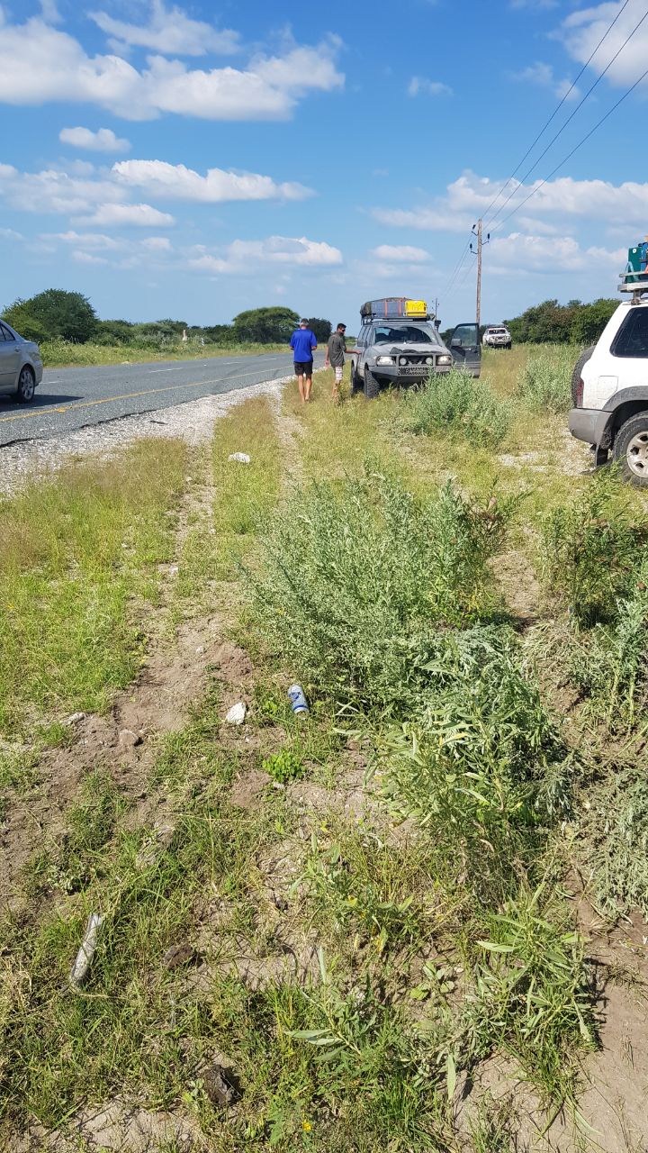

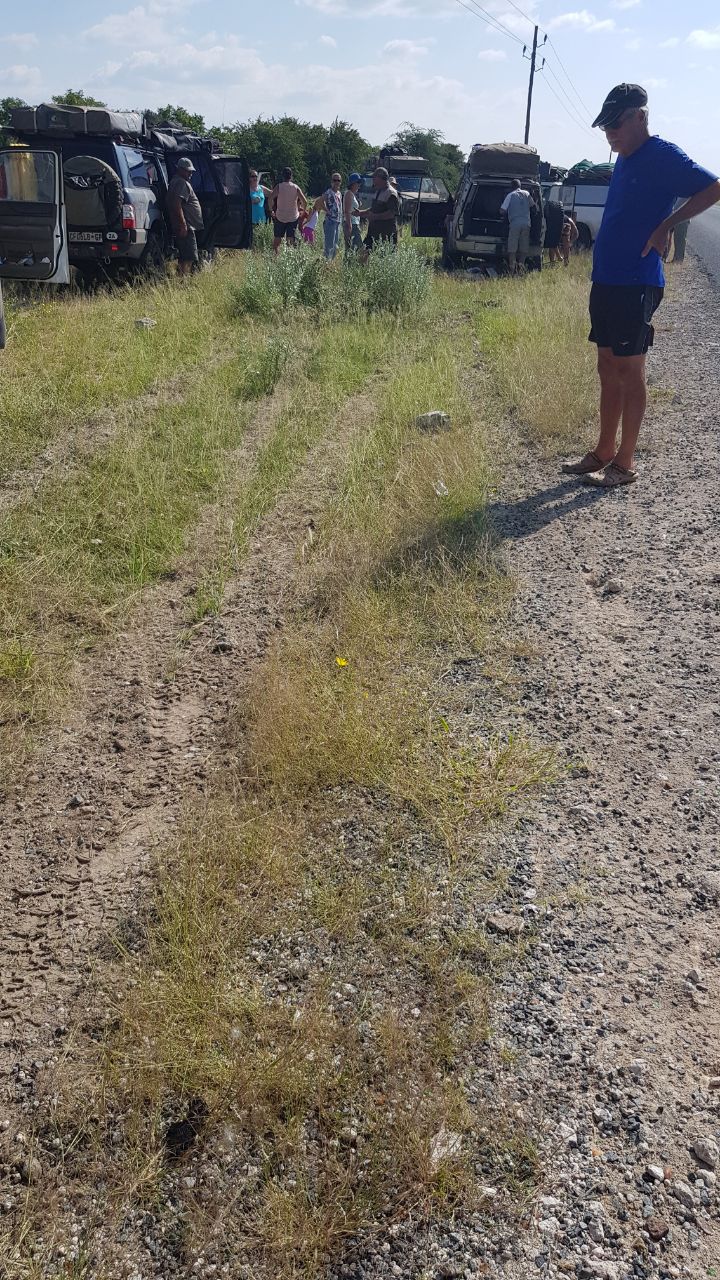

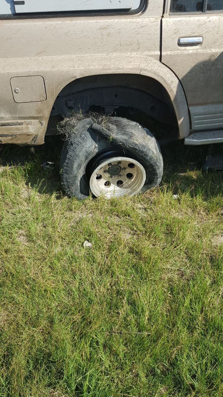

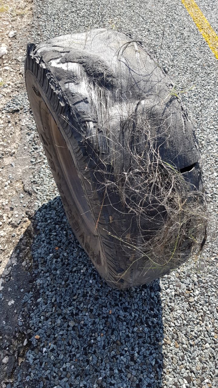

This is where my tire ended up:
The TPMS did not respond quick enough. In fact the alarm only when off after I got the car to standstill.
I am replacing that system before the next trip.
Graham used his car and winch to lift my car up from the back, since the ground was not firm enough for the bottle jack on its own.

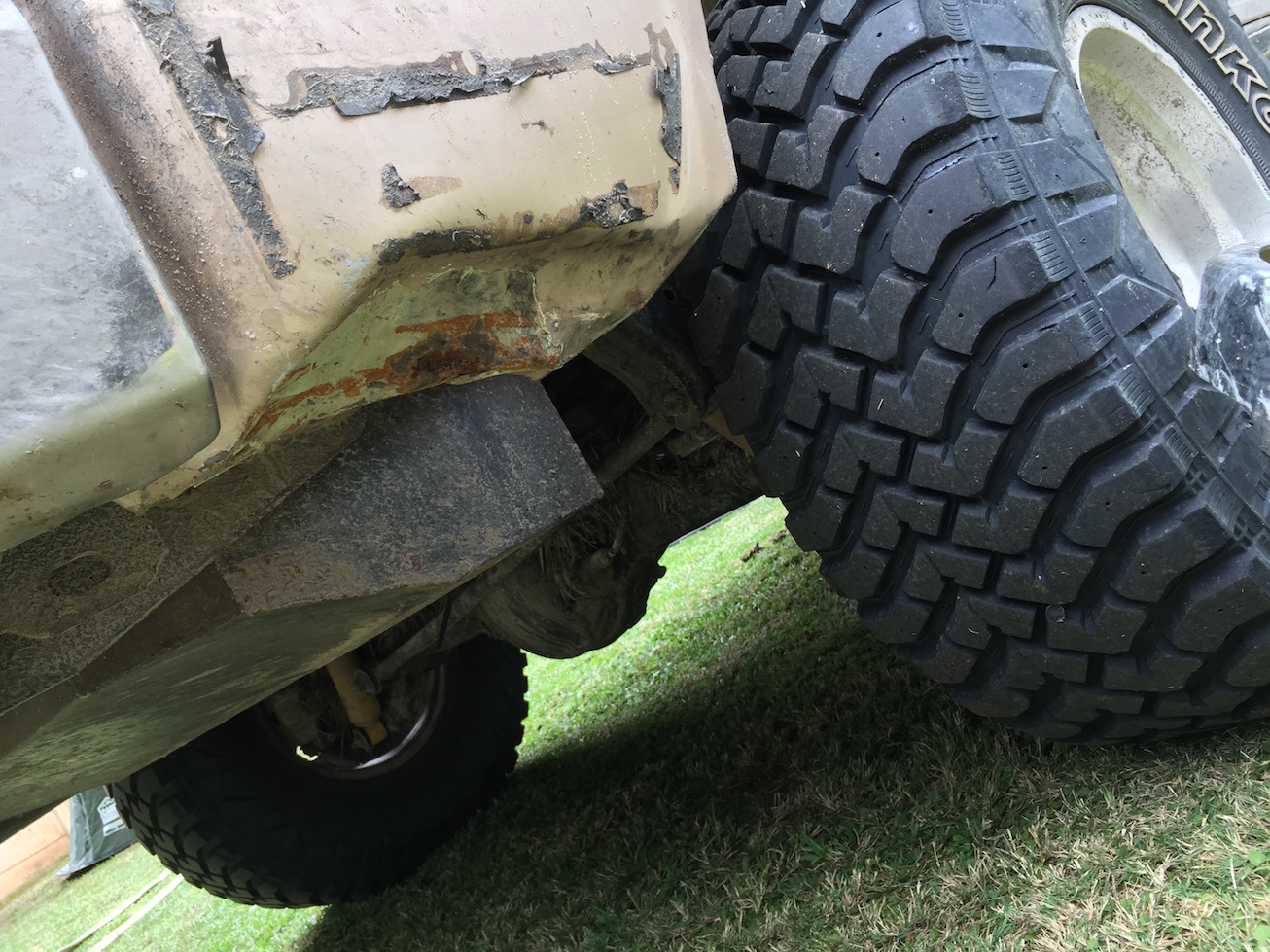

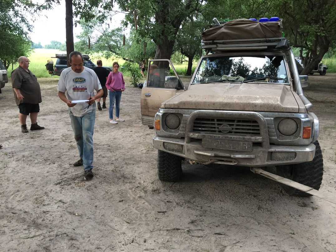

One lesson learned:

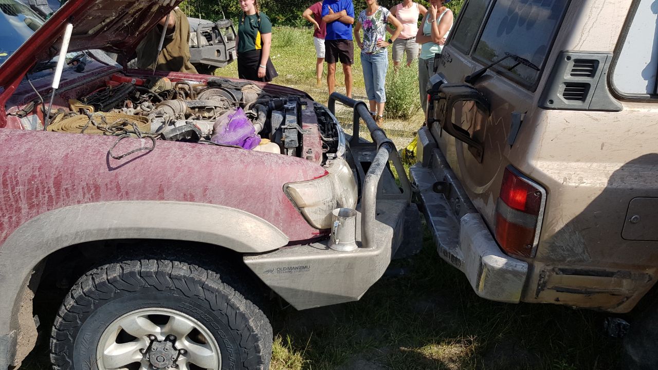

When getting towed by Michael I used the recovery point that Piet supplies. It has three bolts that screw into the chassis.
When finally getting back to Maun, we found that the bumper was loose. The three bolts had loosened. Two of these could not tighten any longer, as the thread seemed to have damaged (either from the bolt side or the chassis side).
Three days of 3.5 tonnes being yanked around eventually took its toll.
note these are all high tensile bolts.
Going forward, to make this point stronger and more secure, I would used longer bolts, and tighted them with nuts on the opposite side, and then tap weld them.

Re: 29 March - 09 April 2018 Botswana Explorer's Route
Alex, twee dinge:
Eerstens, geen TPMS gaan vinnig genoeg reageer om jou van so 'n blowout te waarsku nie. Die band het effektief van buite af uitmekaar geval, en die TPMS het niks daarvan geweet totdat een van daai dwars skeure gebeur het nie, en in ek reken die banddruk het in minder as 2 sekondes van vol na zero druk geval.
Om die stelsel te ruil gaan niks help nie. Mag ek vra wat die band se temperatuur was die laaste keer wat jy daarna gekyk het?
Dan in terme van die boute:
Wat waarskynlik gebeur het is dat die boute gerek het. Langer boute gaan vinniger rek. En om hulle te tack weld gaan ook net probleme veroorsaak, want dit keer nie die rek nie.
Die antwoord is om die gate groter te boor en die volgende groter grote boude in te sit.

Peter Connan wrote: 13 Apr 2018 12:27 Alex, twee dinge:
Ek sal nie vir jou kan se presies wat die temperatuur was voor die band ingegee het nie.
Die temperatuur kon nie meer as 40 grade gewees het nie. Ek het nog nooit voorheen meer as 40 grade gelees nie, behalwe vir die twee vorige kere wat die alarm wel afgegaan het.
Ek het ander issues met daardie TPMS stelsel. Van die sensors moet ek gedurig uithaal om weer kontak te bewerkstellig. Regsagter was egter nog nooit een van die punte wat gesukkel het nie.
Wat boute betref:
Wat van as mens die herwinnings punt vas sweis na die boute vas gedraai is?

Alex, is jou TPMS een wat buite op die valve stem opskroef?
Myne, wat binne-in sit, lees gereeld baie hoer temperature as dit. Op daai selfde dag wat jou band gebars het, het ek op pad na Maun toe op 'n stadium 62 grade gesien...
Maar selfs temperatuur sou waarskynlik nie oor die failure gewaarsku het nie.
Die materiaal waarvan die recovery points gemaak is, is tegnies 'n koolstofstaal. Met ander woorde, die hardheid daarvan word deur hittebehandeling geaffekteer. Dit is gewoonlik nie raadsaam om sulke stale te swys tensy jy hittebehandeling kan doen na die tyd nie.
Maar ek het hom so ontwerp dat daar baie vleis om die boutgate is, en swyswerk daar behoort nie regtig die punt swakker te maak nie, solank jy nie na die tyd water op spuit terwyl die metaal nog warm is nie.
Net nog een ding: ek sou nie die recovery punte direk aan die chassis vas swys nie. My rede is dat jy die roesbehandeling aan die binnekant van die chassis sal beskadig, en daar is geen manier om dit weer reg te maak nie, maar as ek reg onthou monteer jou recovery point eintlik aan die bosbreker?
Probleem daarmee is, jou bosbreker is vlekvrye staal, wat weer sy eie probleme veroorsaak. Weet jy dalk watse staal Charles gebruik het?
Ja dis reg, dit monteer op die selfde boute wat die bosbreker aan die chassis vas maak.
Ek sal uitvind watse staal Charles gebruik het.
