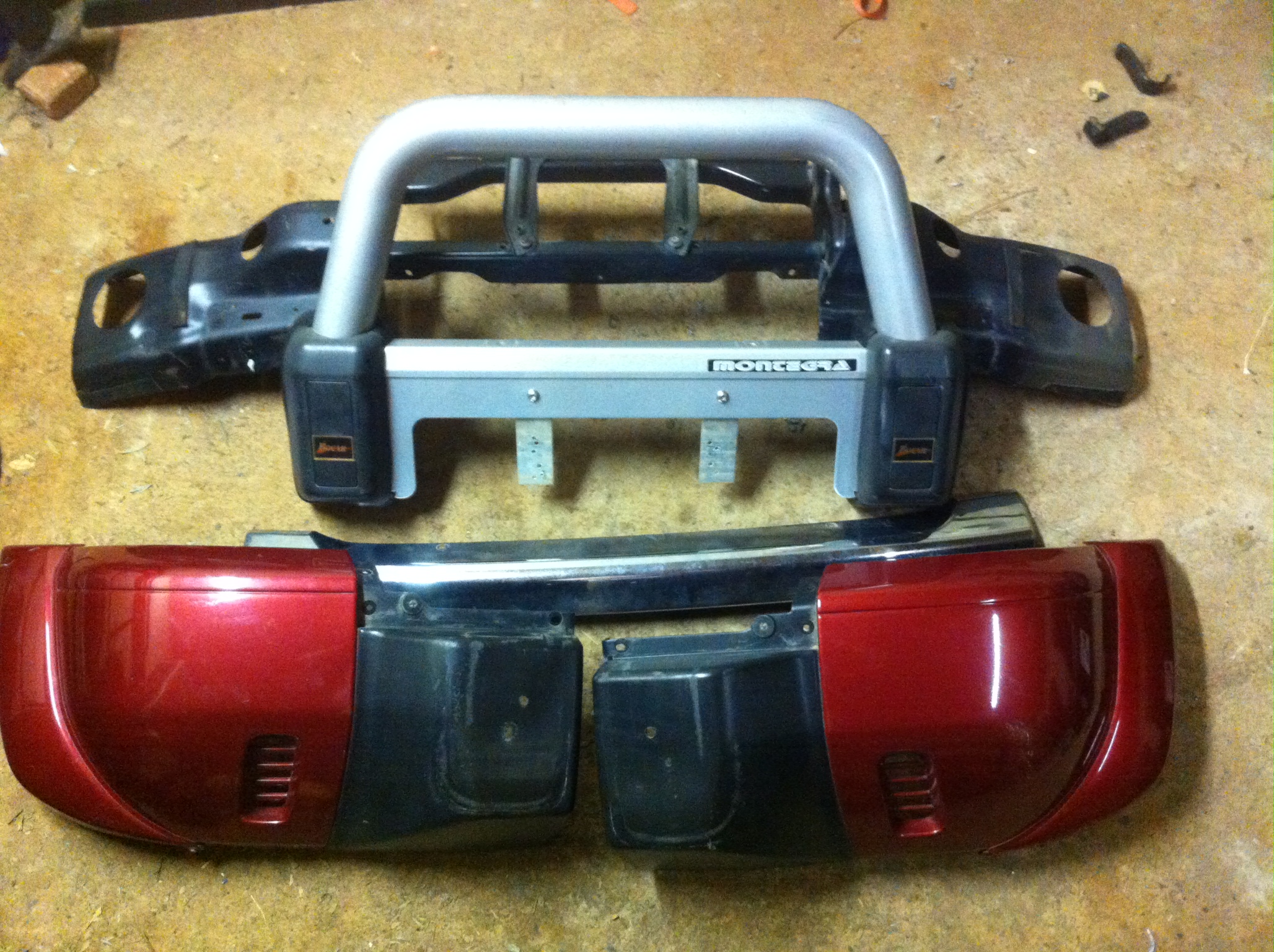

PaulvdMerwe wrote:Baie Nice Fanus,
Sal die Nudge bar op 2002 GRX pas?
Indien wel stuur bietjie foto van hom vir my en hoefeel jy in gedagte het.
Baie dankie
Skuus dat ek nou eers terug kom. Die bumper/nudge bar is dieselfde as Ian se pa sin in hierdie thread:
http://www.patrol4x4.co.za/viewtopic.ph ... 0&start=30
Sal later foto van myne neem.

Naand Fanus ,wat is die kleur van die standaard bumper?
Posts: 3369
Has thanked: 248 times
Re: 4500GRX: Nou het ek twee Patrols...
Dis color coded: rooi.
Posts: 3369
Hier is die bumper. Het dit gou bymekaar gesit vir n foto. Eks nie heeltemal seker hoe dit alles aan mekaar pas nie. Sal more kyk.

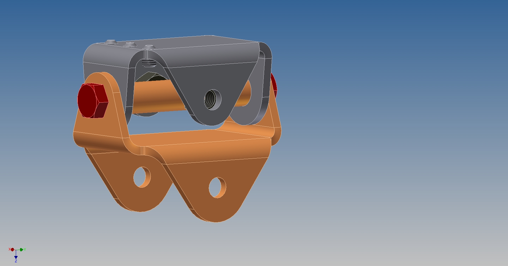

Peter Connan wrote:If you extend both front and rear shackles, you get rid of most of the drawbacks of extended shackles.
However, it means that the place where you bottomed out on the river trip last year is no better than it was.
Peter, how does one extend the front shackles without loosing its function as an "anchor point" for the diff?
What will hold the diff from moving forward and backwards?

Michael, the attached pic is a swivel shackle designed to work in conjunction with revolver shackles.
It is over-complicated (unless Fanus wants to try revolver shackles, which I think may be an excellent option considering what he wants to achieve).
It gives a 2" lift, but braces against the chassis such that it can't pivot, thus retaining axle location duties.
sh2.pdf
