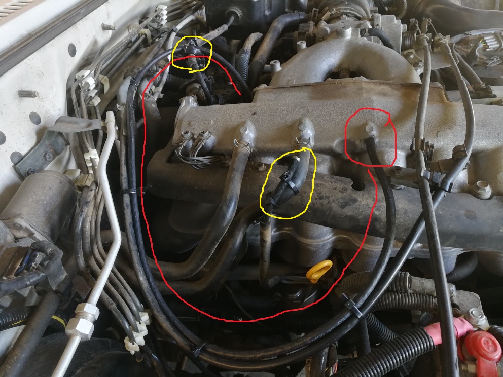

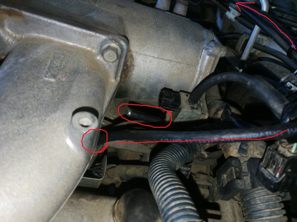

Summary of the mods:
Version A: (Bypass solenoid and lock the flap closed)
Unplug the solenoid
Disconnect the activator arm and cable-tie it fully turned clockwise
Version B: (Bypass the solenoid AND vacuum canister and run the actuator off engine vacuum)
1. Leave activator arm connected
2. There are two pipes at the bottom of the solenoid. The top one of the two is for the activator (the other comes from the vacuum canister on the drivers side of the motor, see step 3). Blank off the end going into the solenoid and connect a new long pipe to the steel pipe going to the activator
3. On the top of the engine, drivers side, there are three vacuum hoses connected. Two thick ones and one thin one. The thin one goes down to the dedicated vacuum canister. Disconnect this thin hose. Blank it off and tie it somewhere safe. Take the end of the new activator hose and plug it on the motor. You basically bypassed the solenoid AND the vacuum canister
I hope that attempt at describing the steps is not too complicated
For a first attempt I'd say go for Version B first. Changing the pipes is easier than messing around with the circlip on the actuator in Version A, and if you decide to try Version A later the changed pipes don't matter.
Edited to add photos.
Red shows the new pipe routing
The yellow in the one photo shows the old pipe tied up and the solenoid wires tied up
Unplug the solenoid

Ok so I've driven a fair bit and I'm sticking with the "B" mod, in other words bypassing the solenoid etc and connecting the actuator direct to engine vacuum.
Works great for me.

Hi Spike
I did your option B ,and love how the Patrol drives now in town ,open road revs are alot smoother,open road fuel economy is good/better,in town i dont drive too nicely so havent checked that out

I was just communicating with a Patroller about this mod and it occurred to me that I should put a clarification here for guys who may be apprehensive.
This so called "Option B Mod" that has been advocated here doesn't disable the system as such. The PVA system of lengthening and shortening the inlet length remains functional. The mod basically just entails bypassing the input of the ECU involvement in that decision, thus removing the erratic activation/deactivation of the system.
