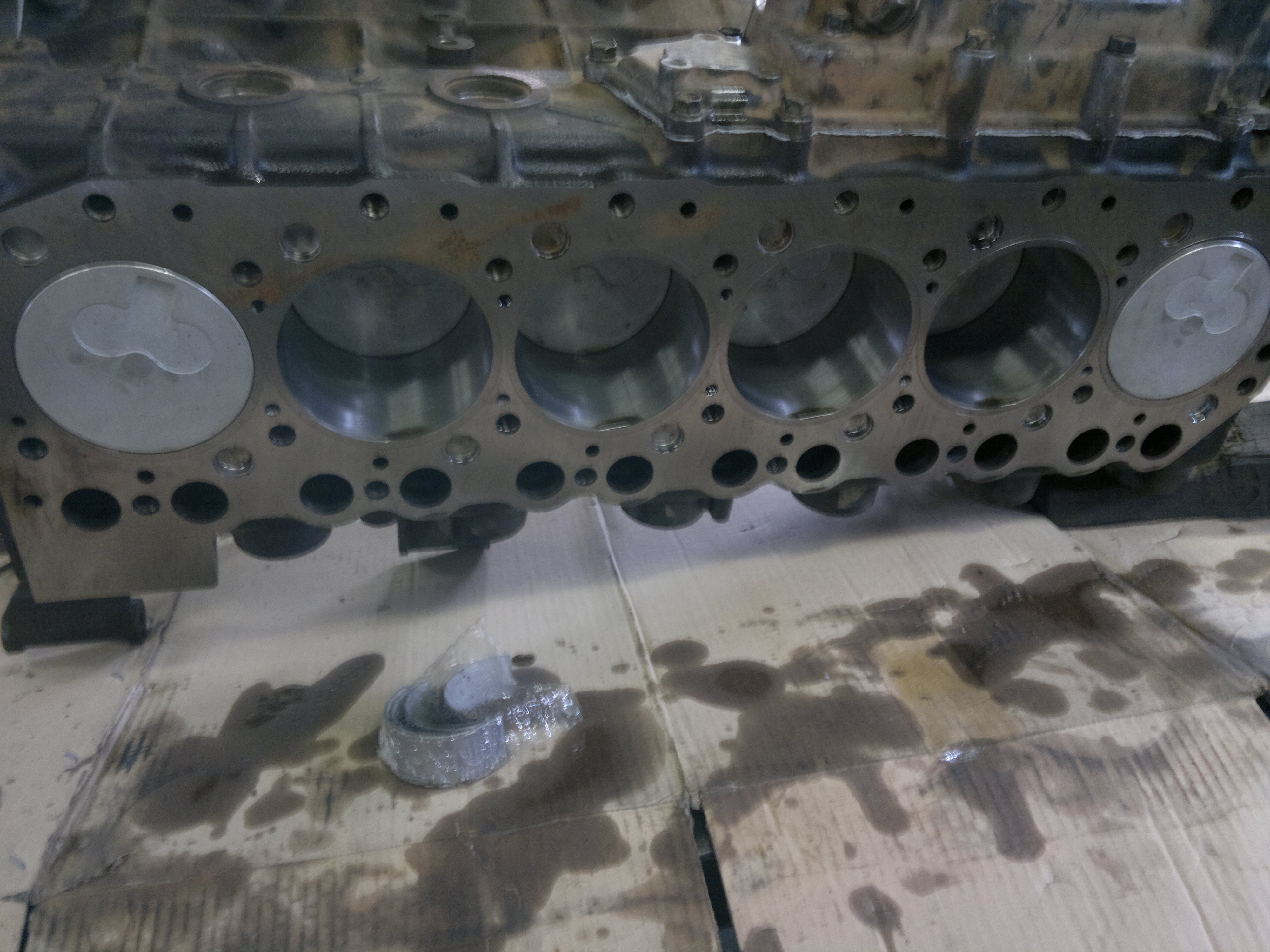

Right so new pistons in with new sleeves and the block and sleeves skimmed completely flat with each other and a piston protrusion of .025-.03.

The head gasket I'm using according to my supplier is a 1.6mm victor reinz apparently the best of The best! My engineering guy says with me wanting to turbo the motor we should try and get the compression lower, is this true and even possible? And how?
Re: 99 td42 head cracked
ANDRE !!!!!!!!!!!!!!!!!!!!!!...... before you assemble the block...... those sleeves should protrude the block, by I think 0.07mm. This will make the gasket seal perfectly, especially with 22-23:1 compression ratio !!!
Possible solution for this.... piano wire the block. Or what I did was i bought some stainless steel shim stock and cut rings the size of the sleeves and then placed the head gasket on top the ensure they stayed in place.
