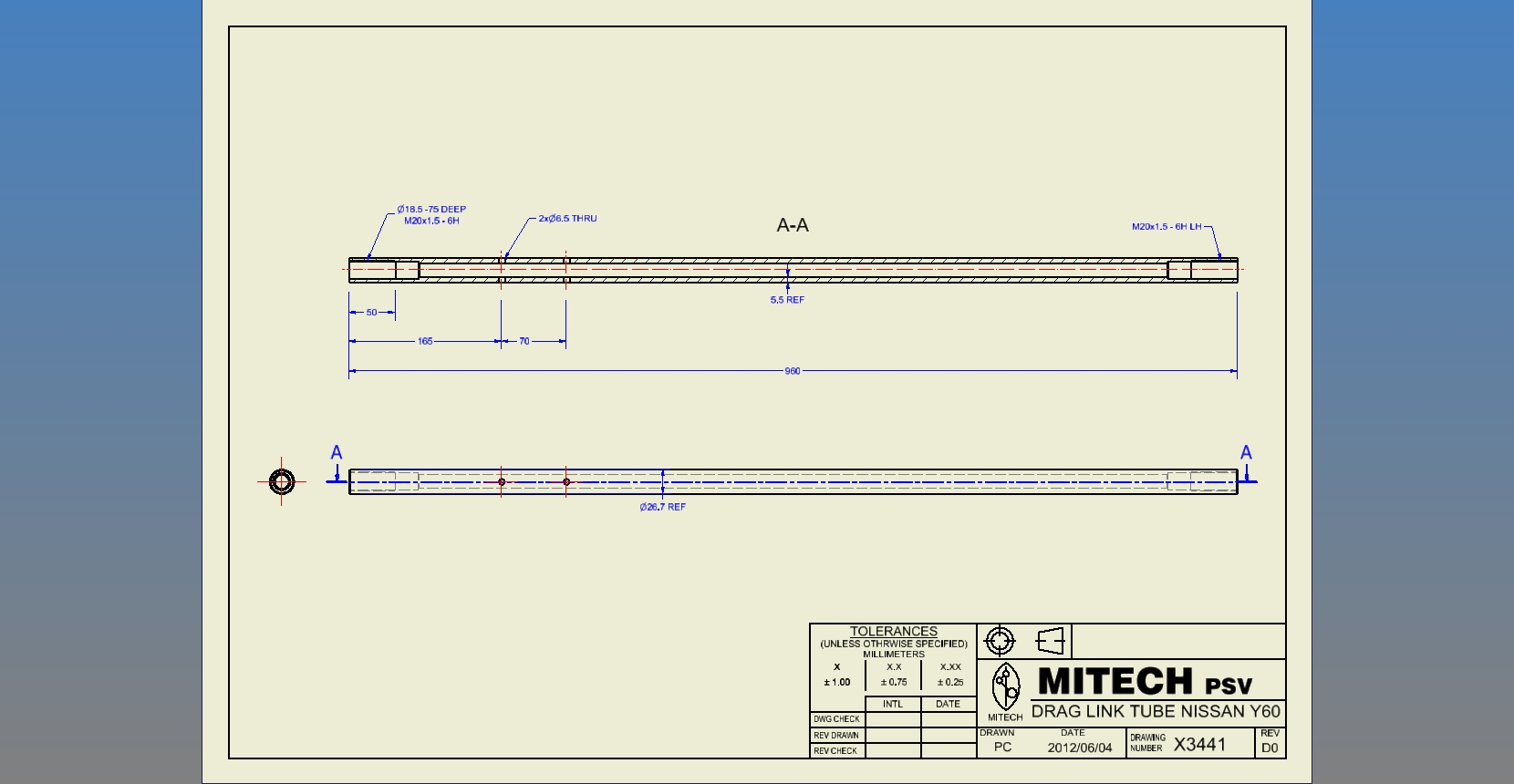

Dungbeetle, we are going off-topic here, but my drag link died a short while ago.
I tried to have it repaired, but the repair didn't work, twice in a row.
I sourced ball joints, unfortunately I have lost the part number but they come from one of the Nissan Cabstars and cost me R157 for the set (both left and right). I then had a piece of 3/4" Schedule 160 tube (available from process pipe suppliers) machined according to the drawing attached below.
I had a bracket made up to hold the steering damper. The cost was the same for two as for one, so I have a spare, if you want it you are welcome. This just bolts on through the two crosswise holes, using 8mm bolts.
I was lucky in that I got the tube for free and paid only for the machining, but the whole lot cost me about R600.00, as opposed to Nissan's R4628.40.
However, just make sure the length is the same as mine, I believe there is some difference between the Y60 and the Y61.
