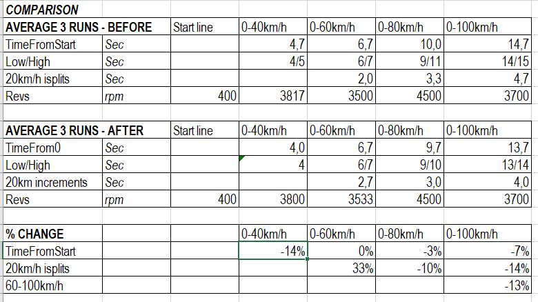

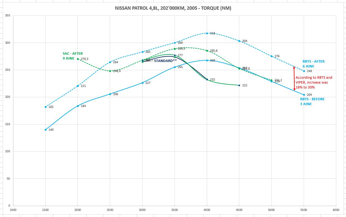

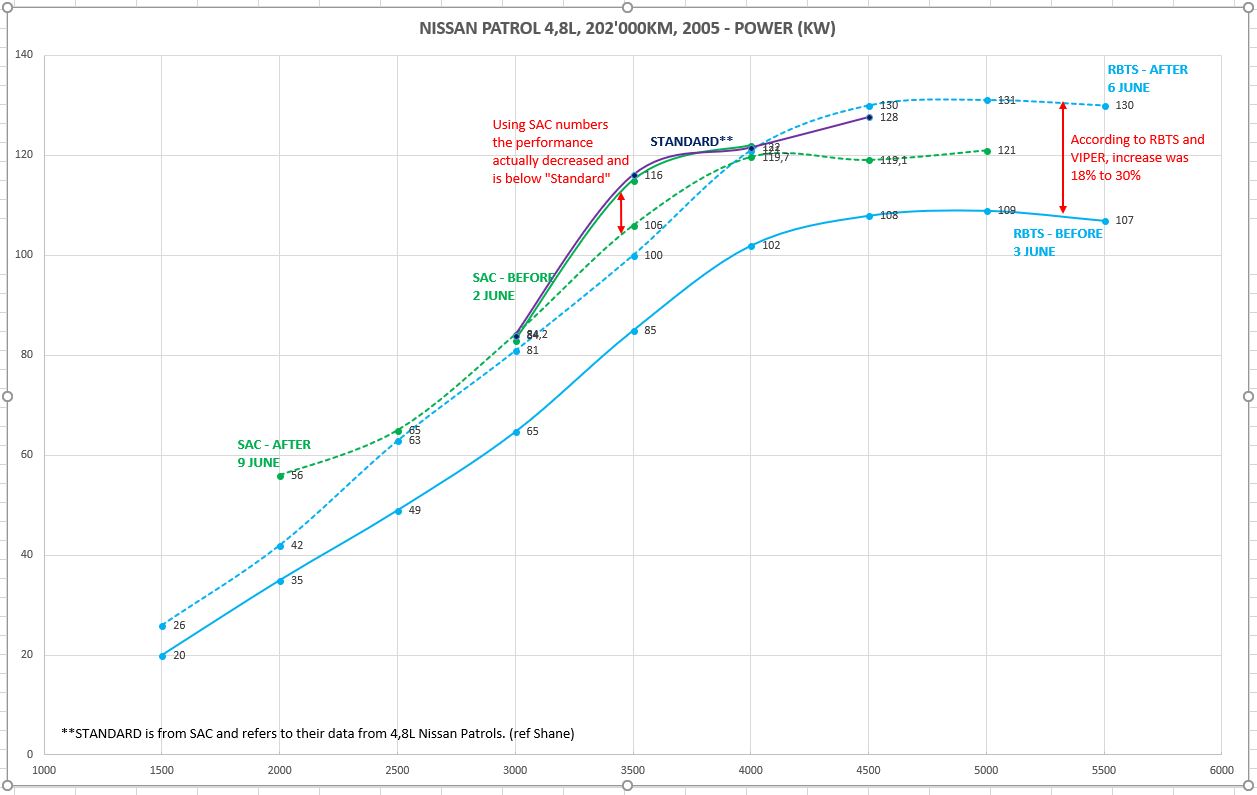

So .... I finished the stage one enhancement - in search of some kilowatsies... bottom line is that i don't think I found many, but i'll leave that to you to interpret the data,
WHAT I DID
1. Changed the complete exhaust to a 76mm free flow stainless exhaust;
2. Changed the branches and manifolds as well, including ceramic coating them, as per advice on this forum.
3. Installed a Dastek Unichip (the Q4 version). This chip was wired in (not plug and play) as the harness for the Nissan patrol doesnt exist. I asked to have a bridge plug installed in the event I want to disconnect the unit for the purpose of troubleshooting a problem out in the wild.
I got quotes from Dastek directly (they offer an amazing 3month no questions asked money back guarantee), Rob Green Motorsport; Steves auto clinic Kyalami; TNT Exhausts; Van Der Linde Exhausts and Viper Performance Exhausts.
I went with Viper after meeting Abel - aside from being a nice guy, his pricing was mid-tier and he came recommended. Looks like he manufactures the exhaust right there. He however outsources the dyno work as well as the installation of the Dastek and the mapping thereof. In my case he used RBTS Racing (although I was originally told he would be using SAC in Alberton).
WHAT WAS THE OUTCOME
I used three baselines measurements.
1. I personally took the car independently to Steves Auto Clinic in centurion where they did three dyno runs on the Monday, recording tyre pressures, ambient temp and of course the results. After the fitment I took it back them where they repeated the runs.
2. I also did some of my own "timed runs" on a flat road from 0-100, videoing the runs and recording the RPM and KM/h at 40, 60, 80 and 100km/h. I repeated this 'test' on the same stretch of road, with simialr weight and tyre pressure.
3. Viper (through RBTS) also did a 'before' and 'after' dyno run.
Unfortunately in my case the results are difficult to interpret as the baseline KW and NM numbers from SAC Centurion and RBTS are materially different with RBTS being much lower. According to RBTS (and Viper) as they managed the process both KW and NM INCREASED by between 18%% and 30%. I doubt these baseline numbers from RBTS for a few reasons:
1. I was not there
2. They are markedly below the "Standard" number for a Nissan Patrol. SAC Centurion apparently has a decent database on Nissan Patrols and they included this figure for me when did my DYNO run.
3. In third gear my car hits the rev limiter at 5200 rpm so i am unsure how they achieved 5500rpm. At Centurion SAC the dyno (both were Dastek branded Dyno's) stopped at 200km/h which was about 4800rpm in 3rd gear.
I have attached three charts below. Two compare the results (NM and KW) at the rear wheels at different RPM both before and after using both RBTS and SAC figures.
The third is the "results" of the 0-100 test I did. On this basis there was a 7% improvement in the 0-100km/h time, which is rounded to one second improvement; no improvement 0-60, but an improvement of 12,5% from 60-100.
A last point worth mentioning is that the guys from RBTS managed to break my handbreak, (yes... snap the cable) not tell anyone about it and generally did a crappy installation. So much so that I am taking my car to Dastek to confirm if it was installed correctly. While it was not Vipers doing they are the ones I paid and I expect them to do quality control of sub-contractors, not me. I did email these results to Viper a week ago in the event that they felt the need to clarify the vast difference in dyno numbers but have not done so. In my books this does not reflect well any of them.
I'll revert back after my moz tip of fuel consumption.
