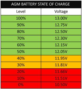

At what voltage is the AGM and or the GEL batteries fully charged and at what voltage should it sit 2 hours after being fully charged, with nothing connected?

Well on all 12v batteries - fully charged is 12.6v (let the battery stand for a few hours or overnight disconnected to normalize).
From 12.4v to 12.6v is considered "charged". 12.39v and less is considered discharged.
Lead Acid batteries: 12.2v is considered DEAD! Which would equal 50% of the voltage charge left.
Gel batteries: 12.35v would equate to 50% voltage charge left.
AGM: 12.3v as above.
BUT Gel can be discharged lower than 50% and still be able to be charged up to 100%. AGM batteries can also be discharged deeper than conventional L/A batteries with no damage, and have a lower internal resistance so can charge up very quick from empty - within a few hours, plus they have a VERY slow discharge rate.
The other benefit with Gel and AGM is that they can take a lot more abuse. Mount them sideways, take them along corrugated dirt roads for 100's km's, they will be fine.

Rhet,
Regarding my question about max voltage on GEL and AGM batteries: https://www.energymatters.com.au/compon ... discharge/
and also this on this
AGM Battery state of charge table.jpg (18.75 KiB) Viewed 6230 times
