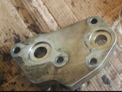

Are you talking about this: ?

Correct. I'm chasing part numbers for that as the previous posts said it was a nissan item available from an African nissan dealer.

if I am reading it right, it sound like it might be a part from a ud40 td40... :think:
Did you send Michael a pm? he should be able to help you.
You can also search Sojo Automotive. (he is also on Linkedin)
Michael wrote: 27 Nov 2016 18:23 So the oil cooler on a TD42 has been something all TD42 owners have spoken about at some point.
Im rebuilding a UD40 TD42 engine and noticed a very interesting setup they have. It seems like the later UD40 trucks powered with the TD42 engine has an oil cooler and it is a very very simple setup.
Its basically just a 12mm (I think) plate that you bolt inbetween the oil preasure regulator that sits on the exhaust side of the engine. It has two pipes on it that you can route to your front oil cooler and thats it....... cant be very expensive to buy from UD of to have them made up at an engineering shop.

I have PMd him but he's been inactive for over a month. I have also tries through FB through Hworks Fabs who has spoken about them also.
