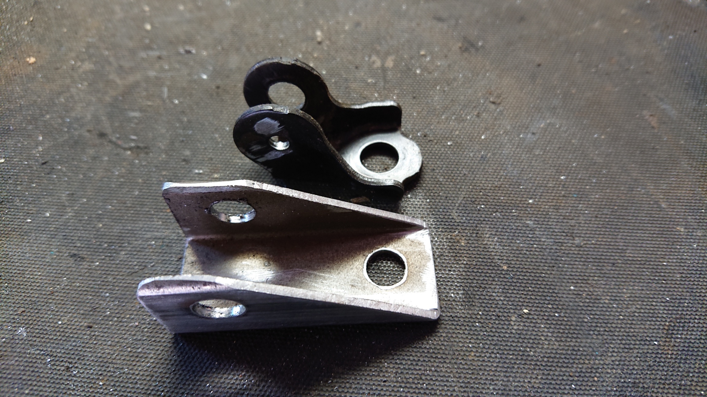

I have made an extension bracket.
Anybody close to Kempton who wants to come see if it fits?

Peter Connan wrote: 14 Mar 2019 15:28 I have made an extension bracket.
Peter, is nobody steps up, I will make the effort and come through some time next week.

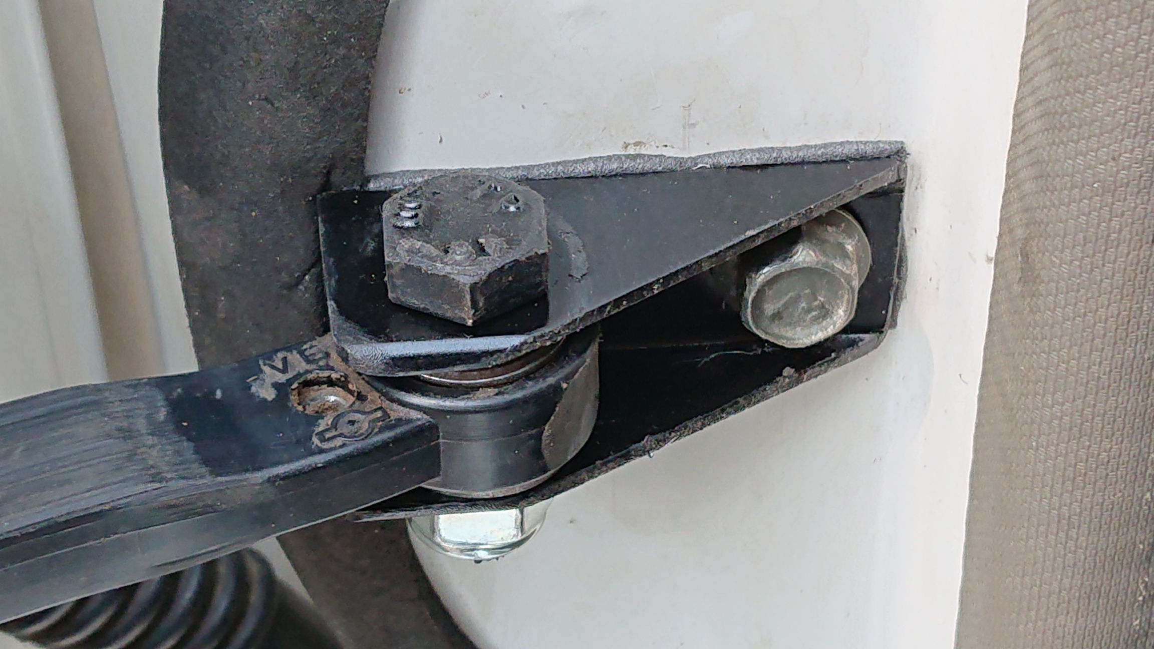

Hi Everybody, maybe the DIY'ers will find this usefull. My sunday hack on the left door stay bracket made out of a small section of square tubing. The tubing is slighty wider than the hinge section of the stay, I just packed the gap with three washers either side, 8mm bolt and a nylock nut....and a lick of paint. Sorted.
Re: Left barn door extension
:goodpost:
Well done!
What size tube did you start with?
Do you have the measurements of your final product please?
:thumbup:

Hi JP, went to go measure quick, had to use a ruler, so measurement not in microns :wink:
20mm Square tubing (OD), 50mm in lenght, holes centre to centre 30mm.
Hope this helps.
Awesome!!!
I know many will give this a try.
