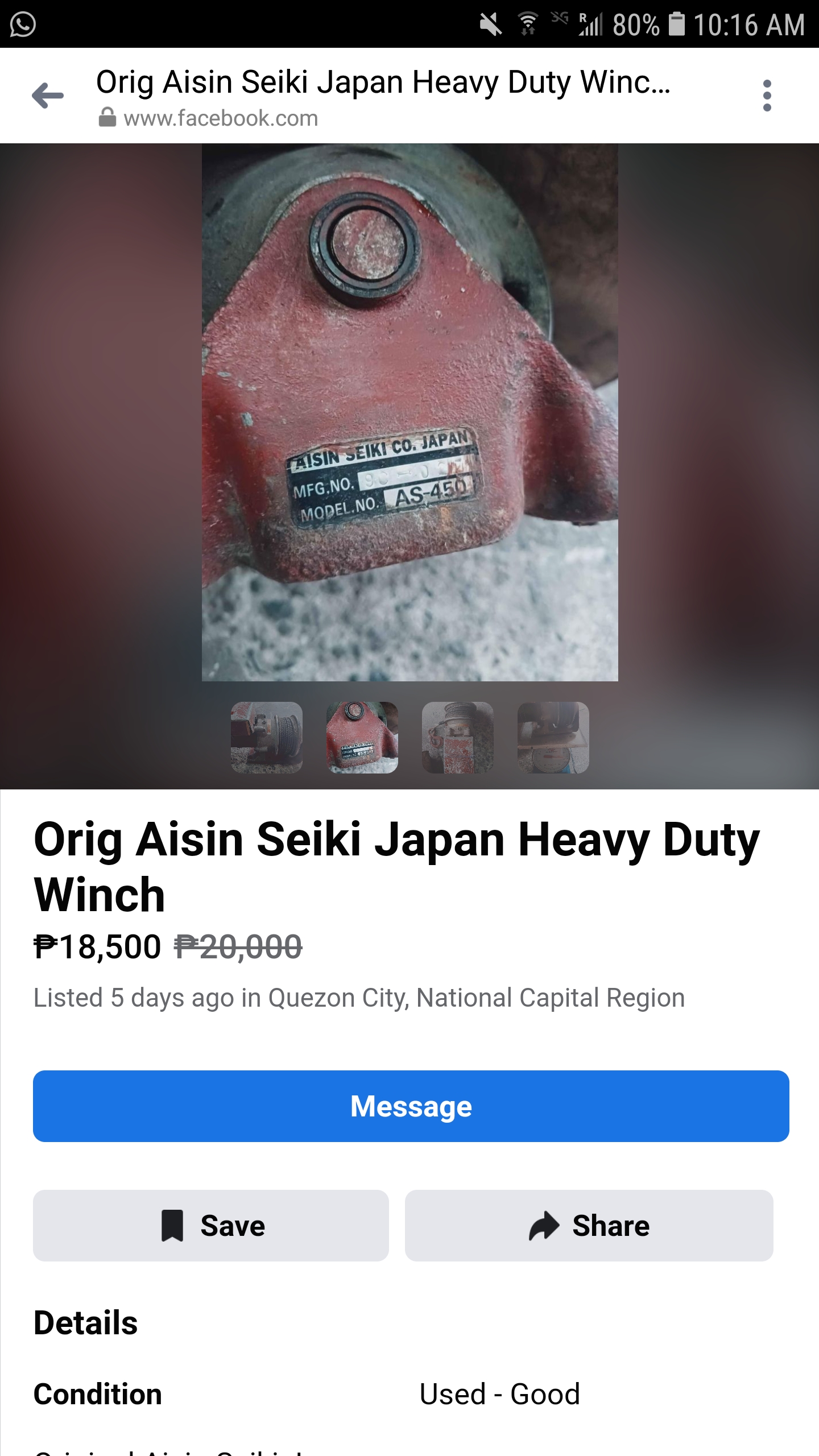

Nothing important, just a quick update
1. Shakes : I've got the steering wobbles. Starts at 85km/h. Will start diagnosing. Tires, Panhard, tie rods, kingpins, arms...
2. Driveline : seems ok just clunky. U-joints visual inspect ok I'm sure replacing would be niice. anyway, for now grease n gun on the way.
3. Winch asking price 250usd. Model any good? Worth it? Install options?
Pic of Subic bay Philippines.
G
G
Re: Too good to be true
Don't know that winch, most guys here have either a TJM or Warn, but Due to the weight of the Patrols, one needs a beefy winch. I have a 12 000lb Warn, that I've only used to recover other people, but its nice to know its there incase one day it is needed.
