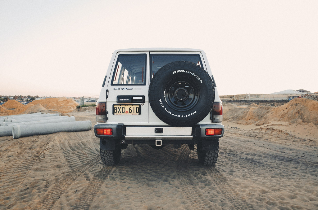

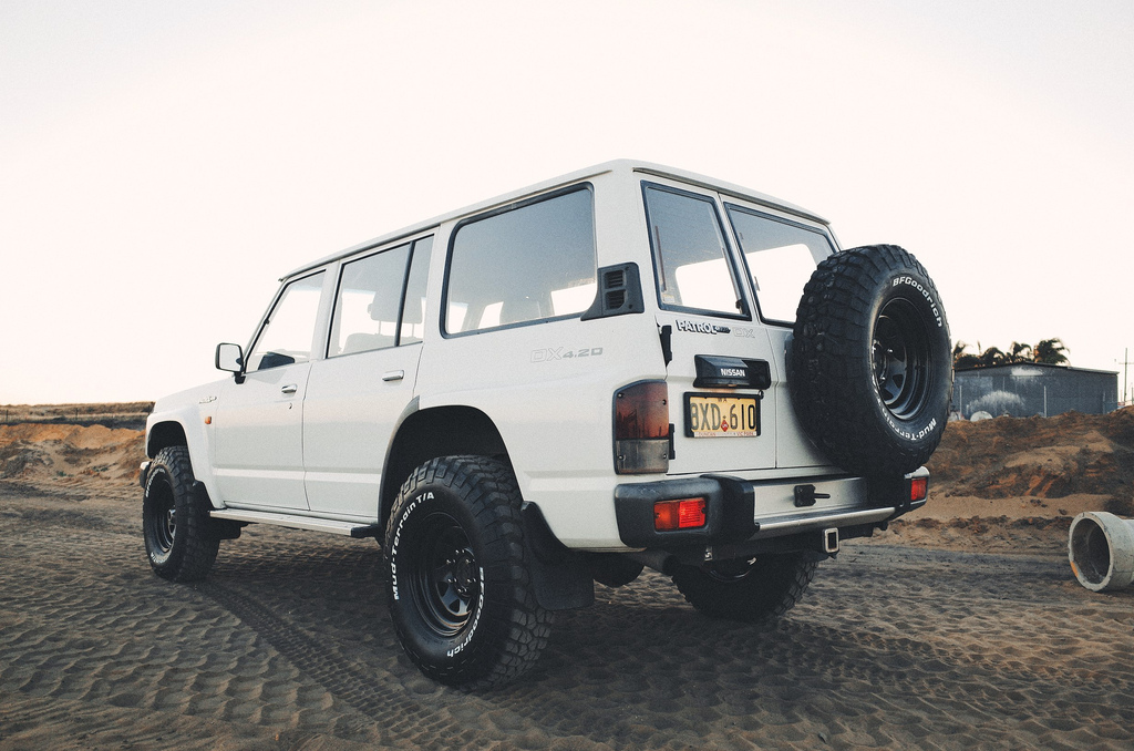

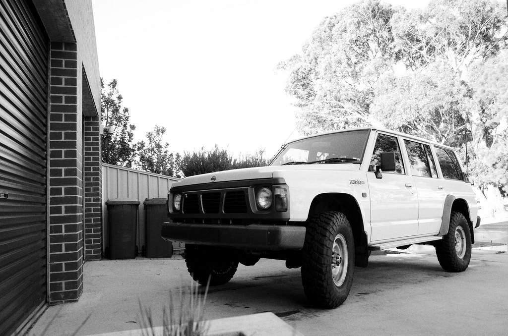

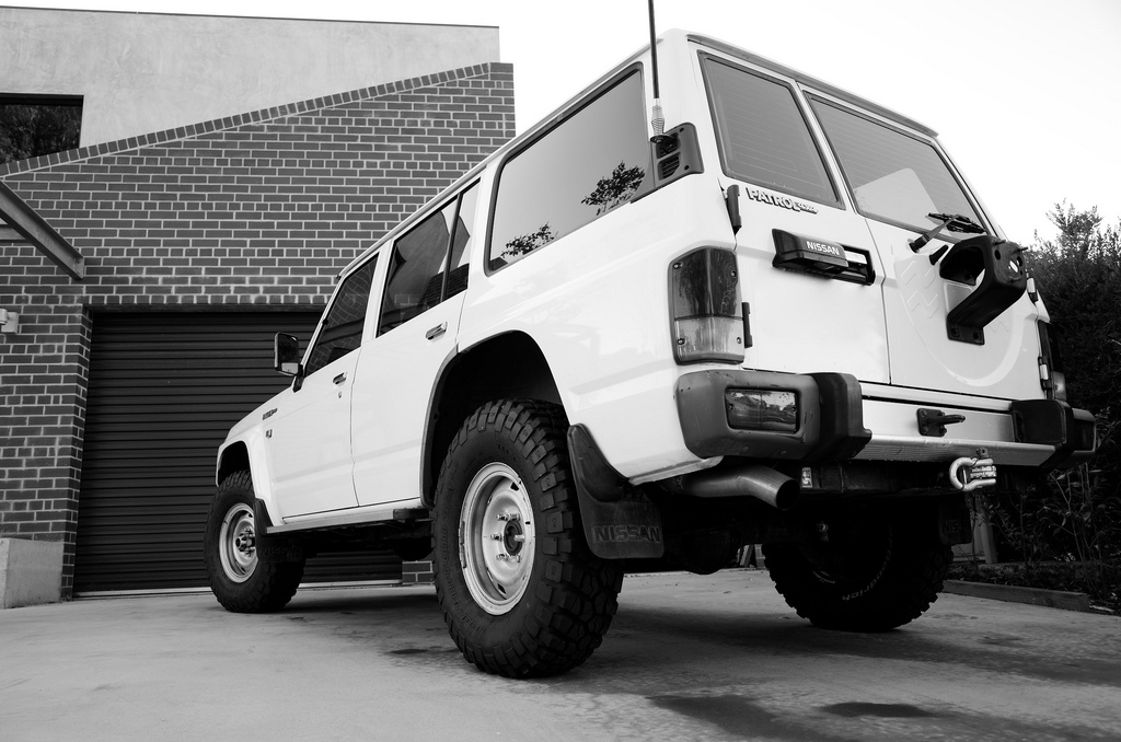

255/85r16 is also a 33", they are slightly higher than 285/75's. Must admit that I have not seen this size on a patrol pickup in real life, whish i could, i have only seen some pics. Surely they must look better than 235/85's?Tinus lotz wrote:Dude i don't run other brands down....i know the km2 got 182000 on them ....what are the sidewall specs on the maxxis ??? They are good on wet tar and the berries when it comes to mud and dirt ....stick to 33 a tire has about 7 years live depends on what you use it for but they normally start cracking before they are run finished....the thinner ones are gonna look Odd and your contact with road surface will be less
Here some pics i found on patrol4x4.com:
- 16050052166_71a69bcae9_b.jpg (301.31 KiB) Viewed 5601 times
- 15456185623_41177f5398_b.jpg (243.81 KiB) Viewed 5601 times
- 10756401466_0273ac1c74_b.jpg (340.15 KiB) Viewed 5601 times
- 10756396716_27f88cae0f_b.jpg (301 KiB) Viewed 5601 times
Re: Patrol Pickup 4.2D Tyres......advice?!
Those 255 have 30mm less rubber on the road to me it looks wrong ... when you need the grip on a rocky climb or floatation on sand it will come in handy

Been down this road, seen all the pics you shown, googled the life out of it. Had Johan Tyres give advice, spoke to possible suppliers etc,.. 285 comes out tops every time.
255 will loog good on the patrol but once you start lifting the patrol etc you gonna want to get a bit more width to offset the roll.
As for Maxxis,.. not saying they bad at all, but i can probably guarantee you that you wont see more than 60k out a set on a patrol... and i heard from G--Tech and ATS and 2 other huge tyre suppliers that Maxxis have terrible after sales service and dont stand by thier product...
I use BFG simple as that. Reliable, Robust, Proven, High Grip, good wall strength, good milage, easy to replace, fair price, best all-rounder tyre IMO,.
