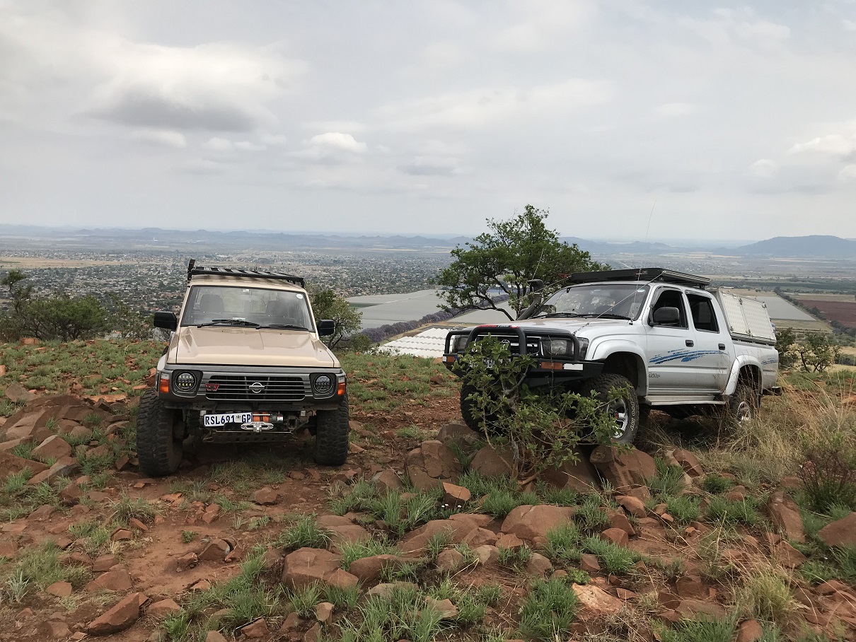

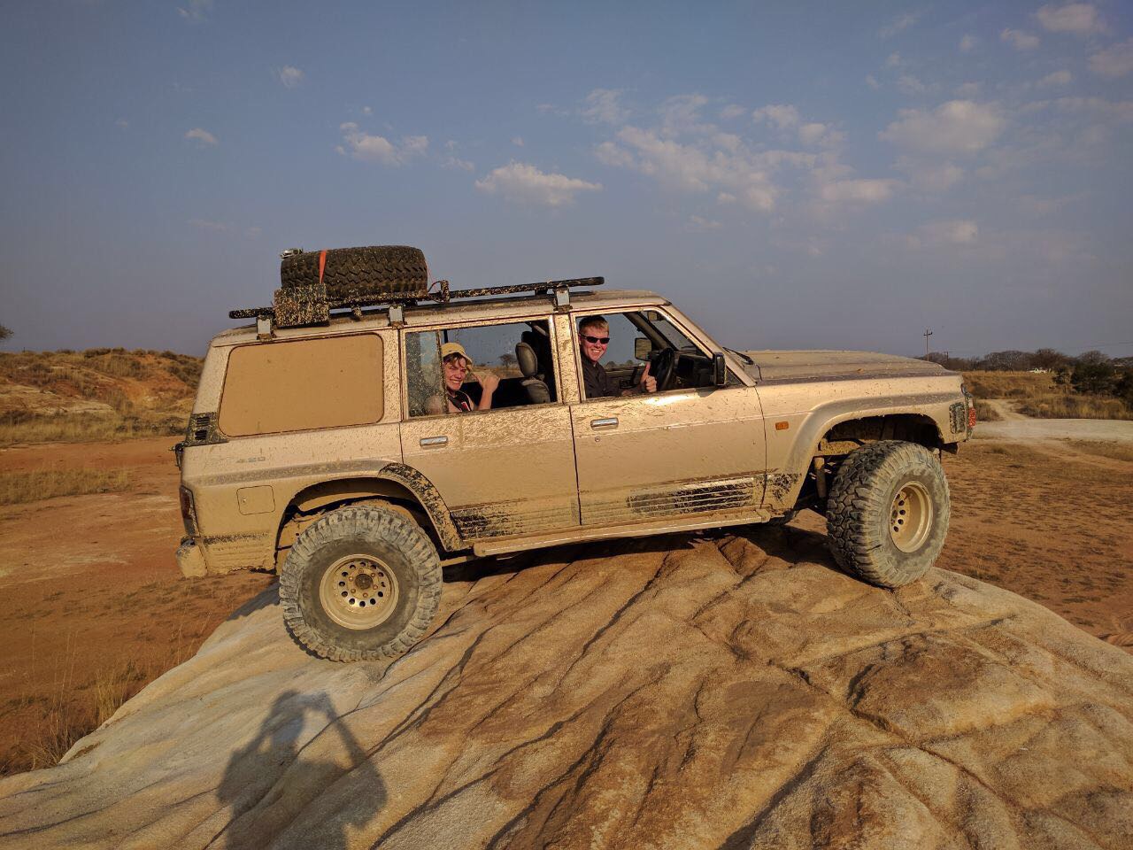

Firstly note that 35” with a N/A TD42 is not your friend. I have never before experienced an engine completely drained of power in lowrane and we have a 2.7 hilux on 33”.
On a normal uphill you put it in 3rd and hope to maintain 60km/h.
Towing uphill you put it in 2nd and try your best to maintain 40km/h :rolling:
Sandwani Klip on 35”

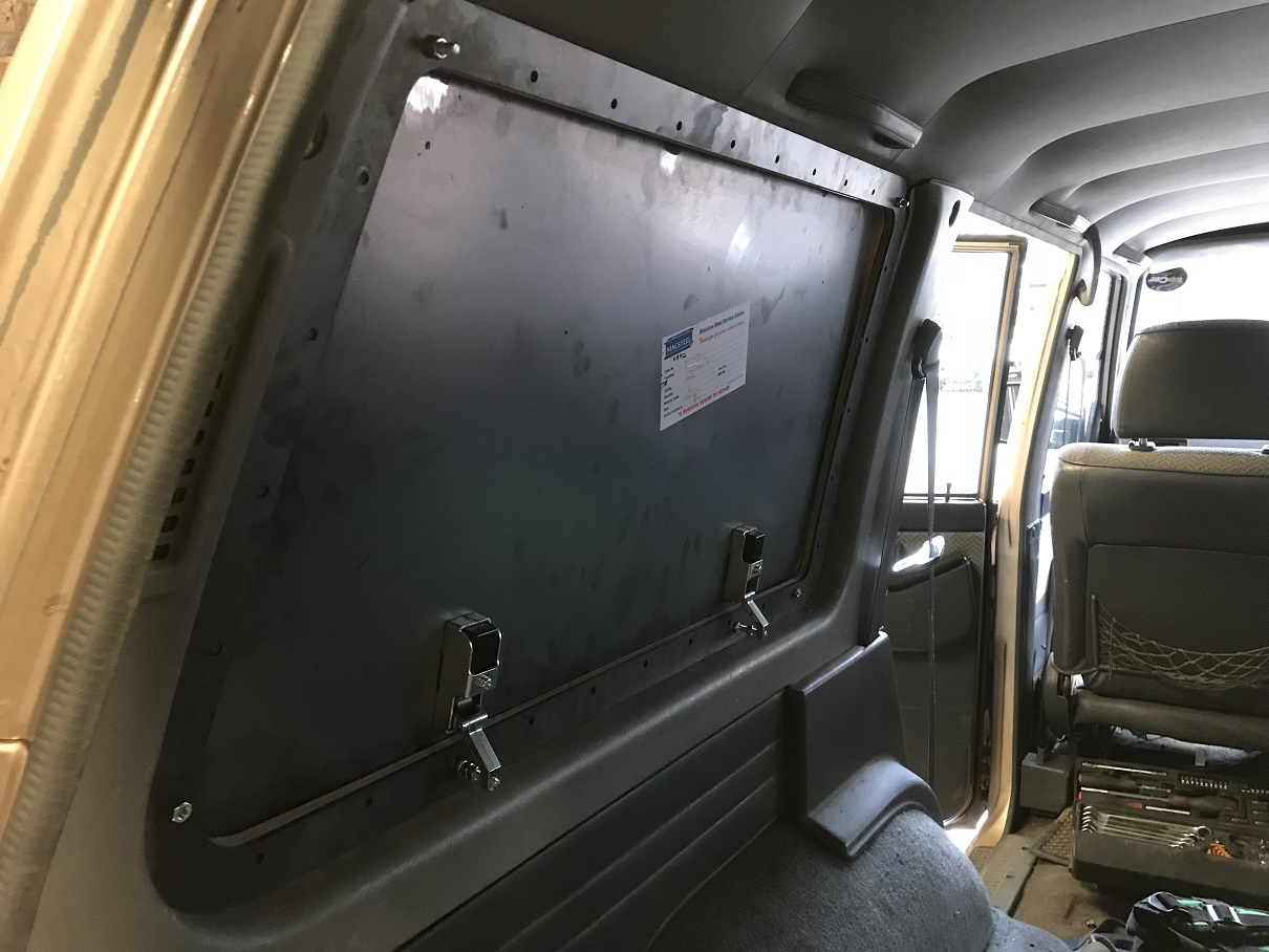

I am still busy with my gullwings and got a few rubbers an hinges after waiting a month :redface: so I will start with it soon, the mdf templates I made are busy turning into weetbix with all of the rain (which I am great full for :blonde: MUDDD!!!!) So I will continue building them soon.

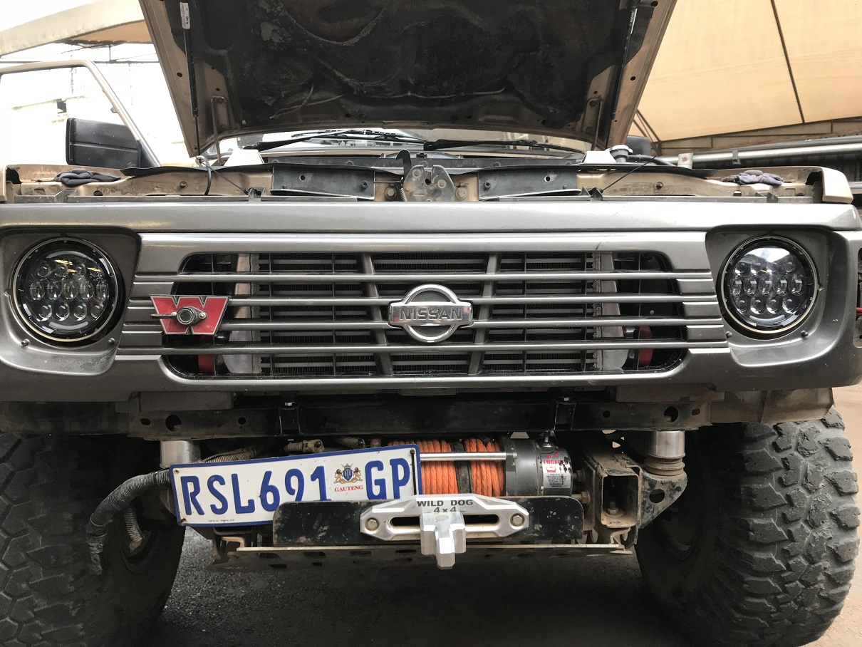

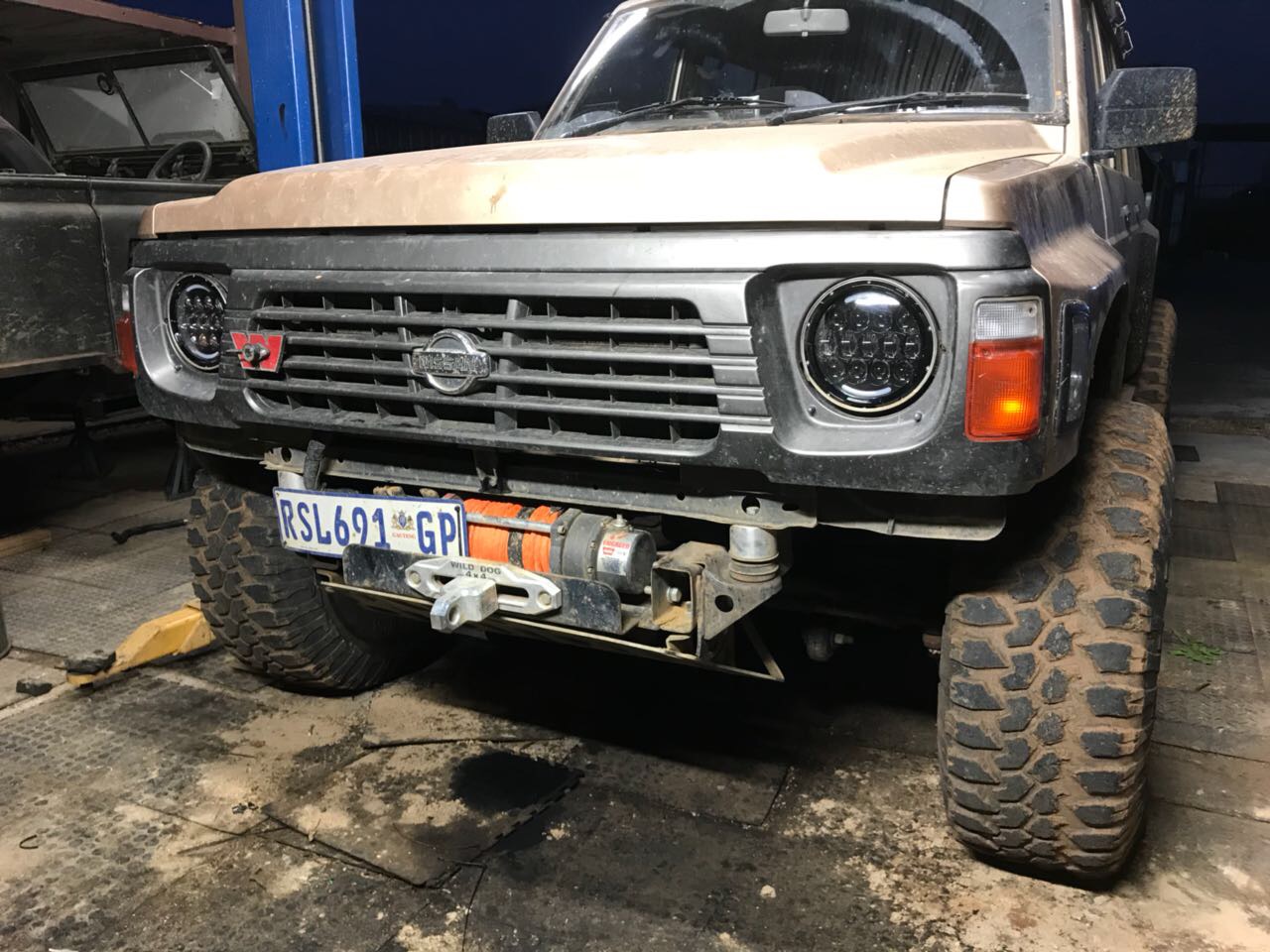

Winch and Lights
Winch and Lights
I also fitted the winch with a synthetic line and some LED ligts, I haven't been able to test the winch because the Patrol doesnt have a gray area. It either does the obstice or it doesn’t but I am sure some mud will help me :blonde:
The LED lights didn’t impress me with their lighting so I am still a bit conflicted over them :confused:

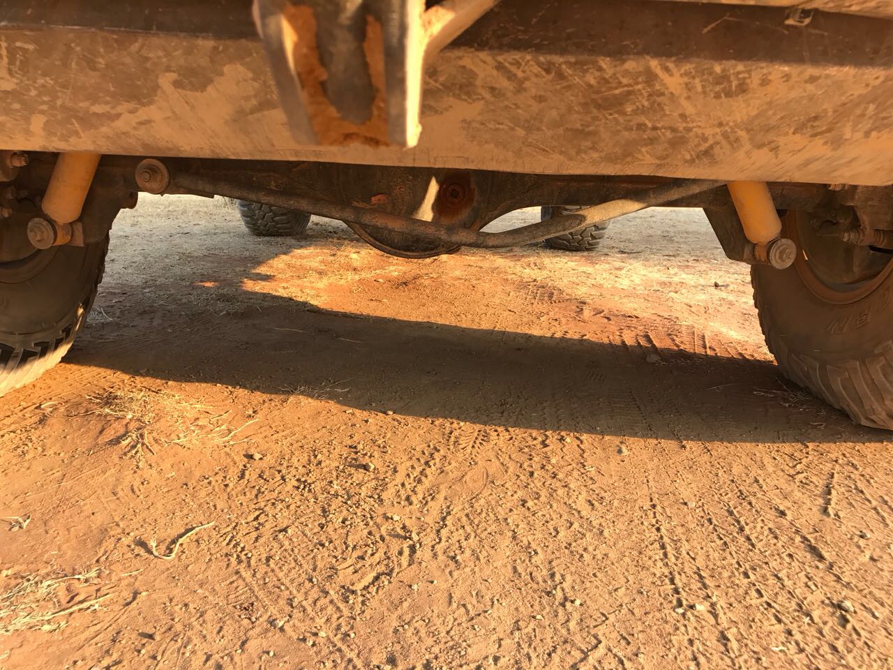

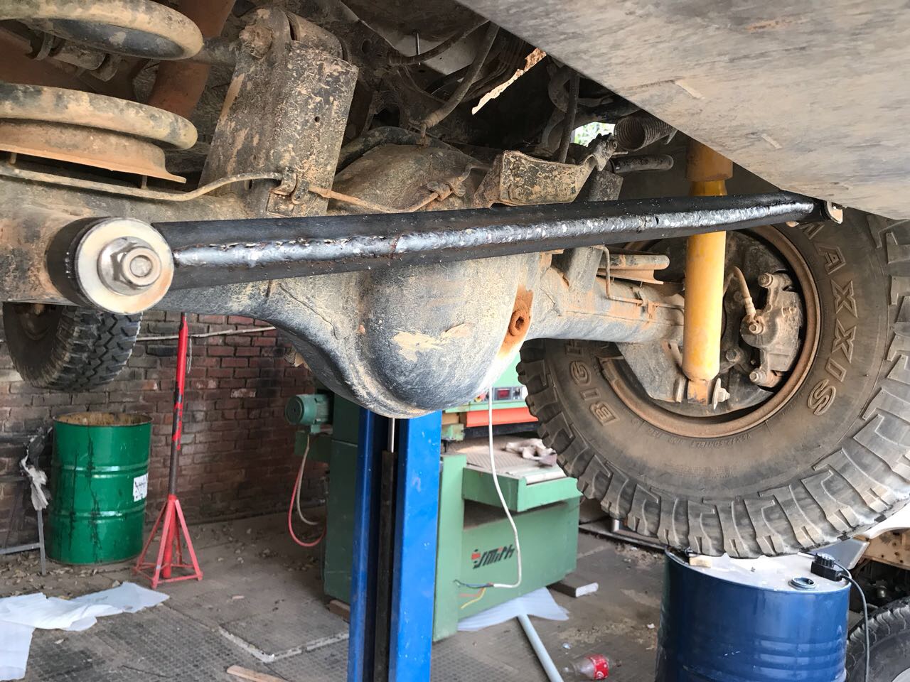

Bent Panhard Rod
Bent Panhard Rod
Somewhere at Sandwani I mannaged to bend my panhard rod but The bigger the problem the bigger the hammer. I “timmered” It straight and boxed it with some angle iron and so far so good :biggrin:
Reinforced Panhard Rod

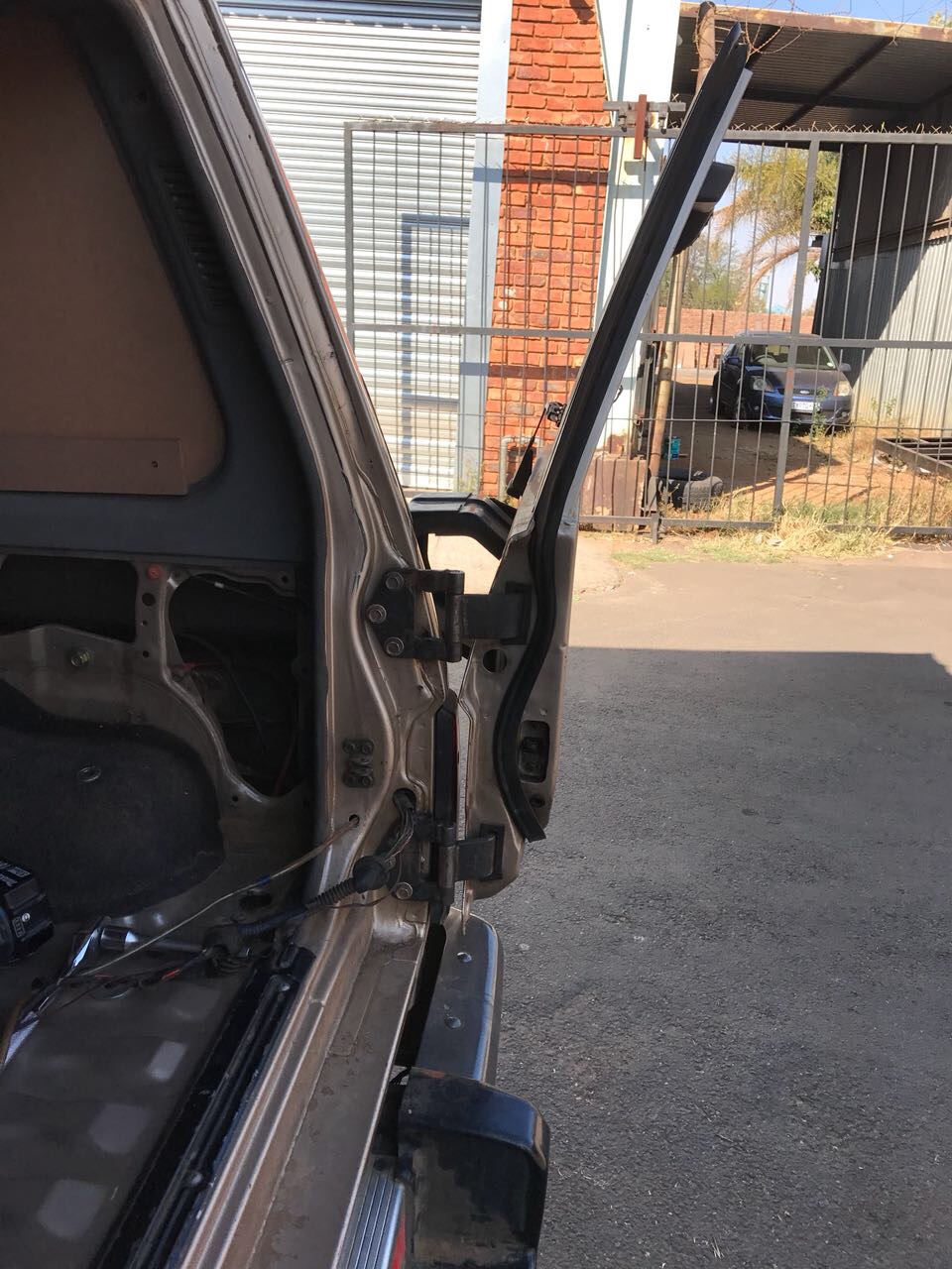

Wider opening Barn Door
I also finished modifying the big door hinges for it to open wider in preparation for my drawer system. It was quite unpleasant to do since I had new hinges made specified to open bigger but they didn’t fit even a little bit and cost a lot of time to remodify. Then I had no more motivation left to do the small door.

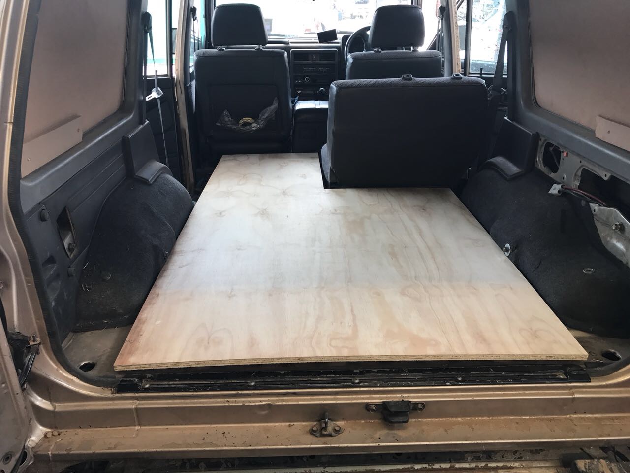

I also cut a base to start my drawer system and dual battery system.

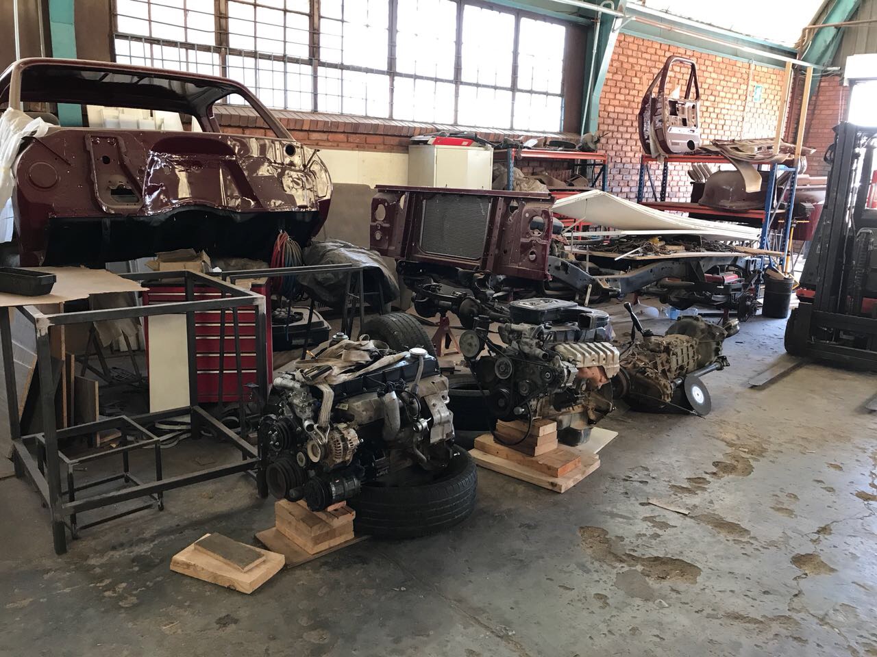

Then came POWER!!!
Tinus found a Patrol Bakkie motor and after some deep discussion with my father :pray: we bought it and Micheal did his magicianing :blonde:
Too many Projects
Too many Projects
This wat the firts time I had taken an engine out and put it in so it was quite an experience, one I would not like to do again :mytwocents: but I am glad I did because I saw a few thing that had to be done.

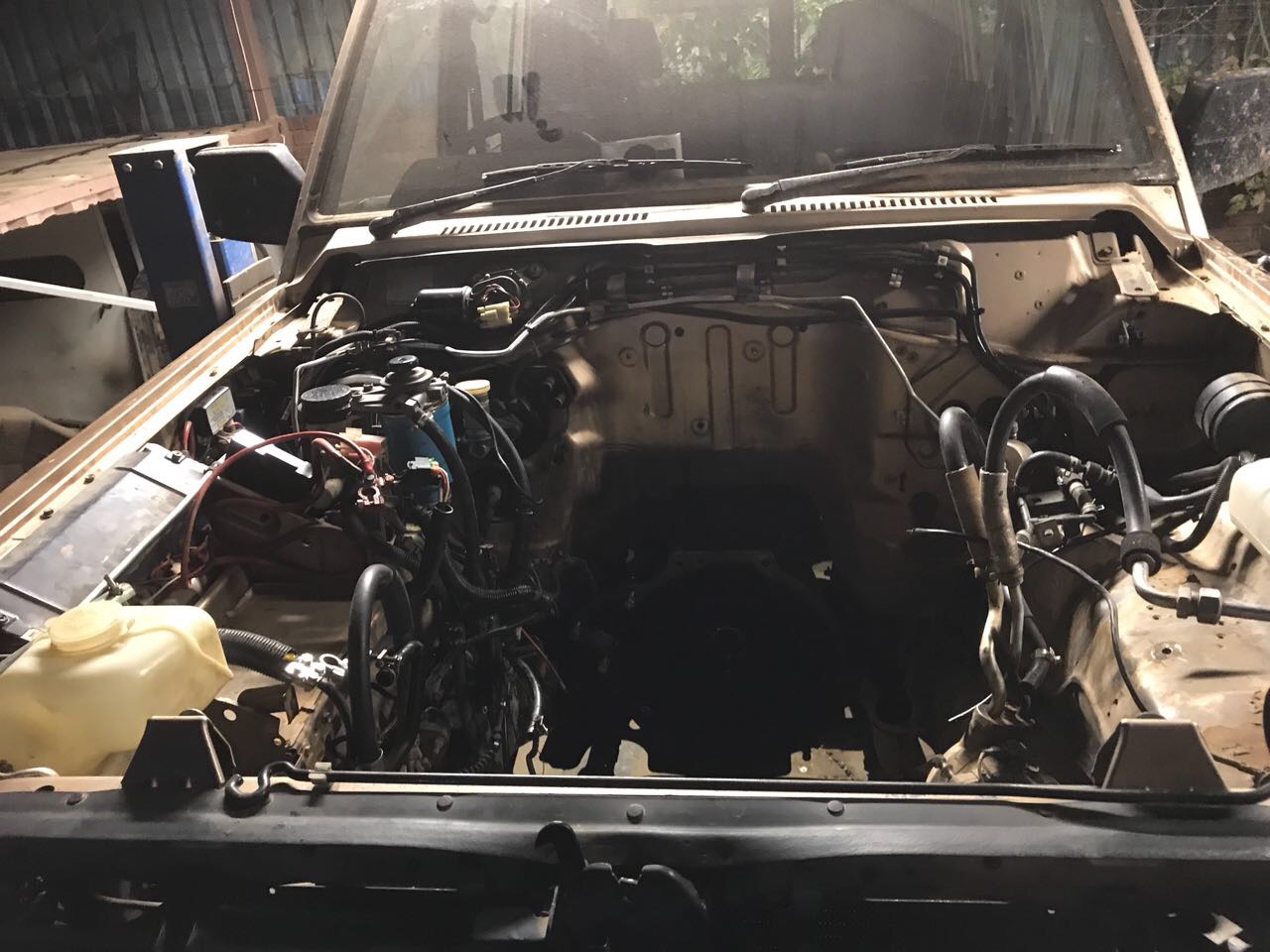

Empty engine bay
Empty engine bay
It made me very nervous to see the empty engine bay because I know how it is going with out other projects who's engine got taken out :confused:

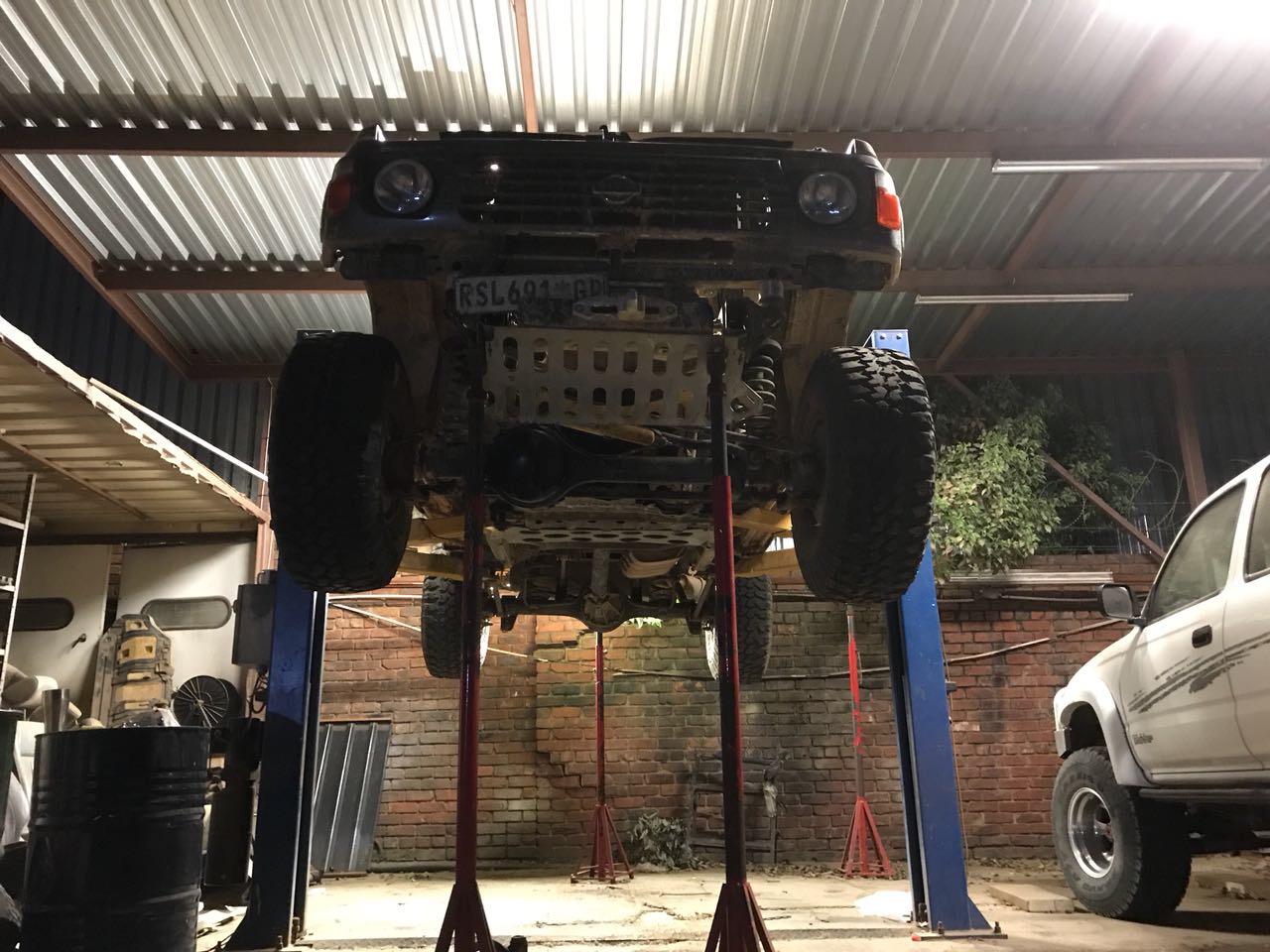

On the Lift
On the Lift

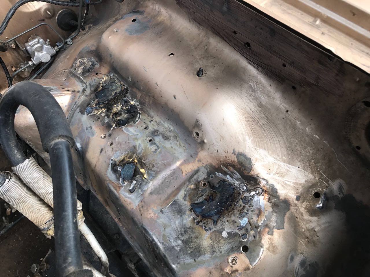

Rust Repair
Rust Repair

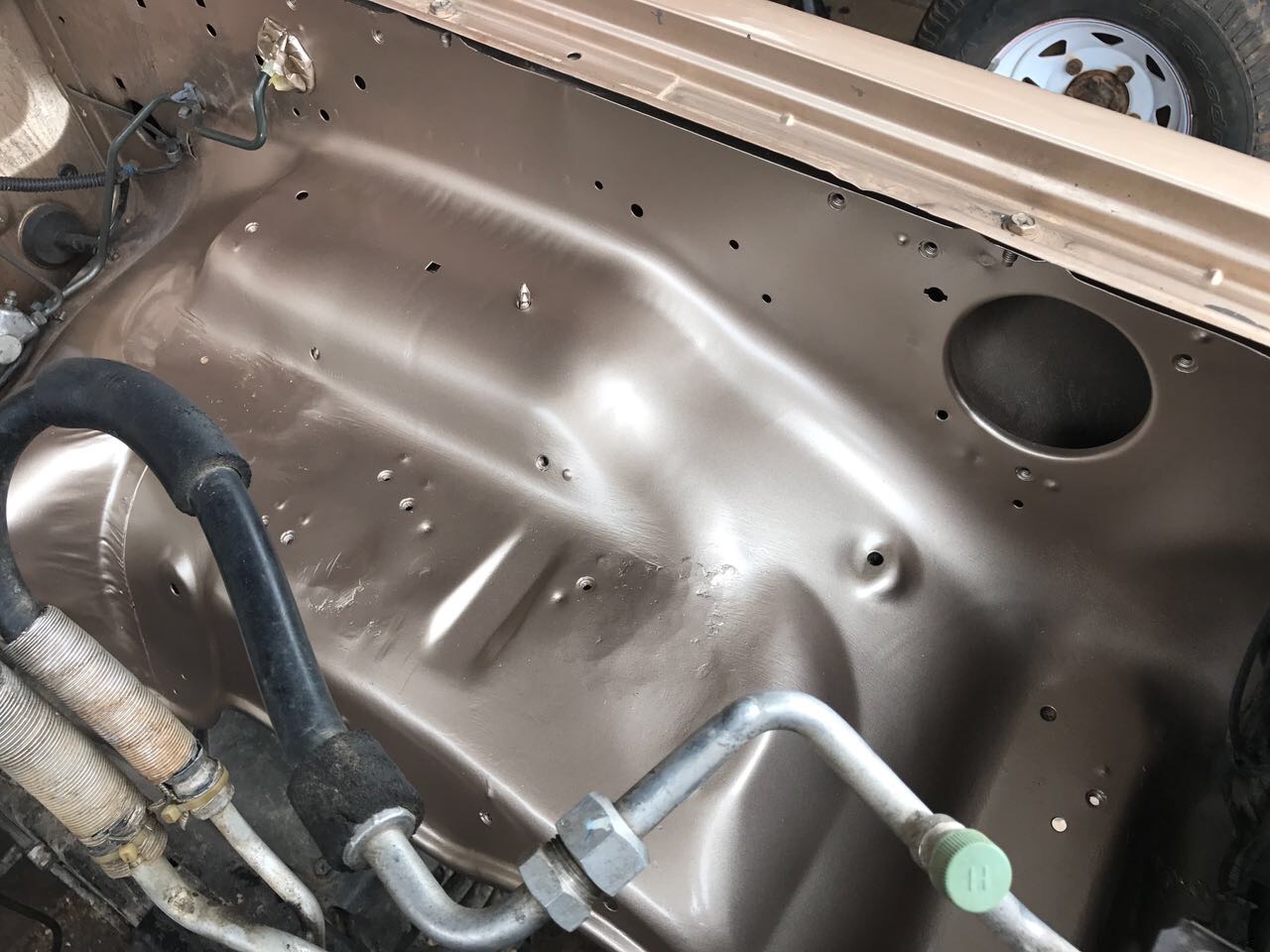

While the engine was out I welded all the holes shut due to the damage the badly mounted second battery did. But to weld a 6mm hole shut one first burn a 30mm hole and then start welding it shut :doh: :oldtimer:
Welded, grined and painted

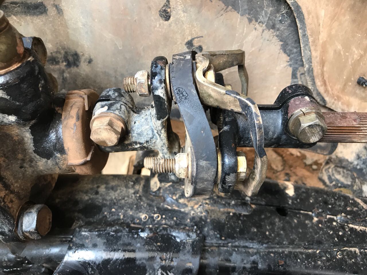

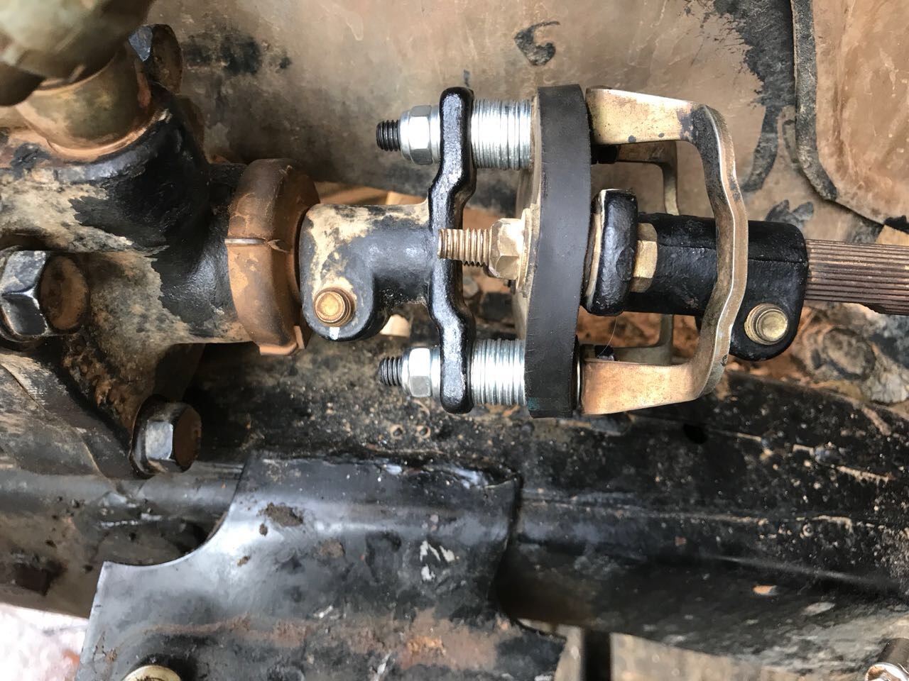

Steering rod rubber
Steering rod rubber
I also noticed that because of the body lift the rubber between the steering box and steering rod was a bit kokaai so I put a few washers in.
Close enough
Close enough

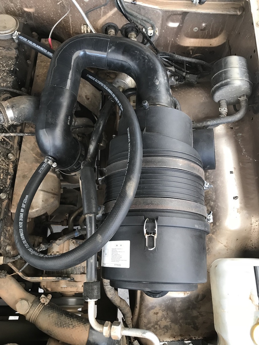

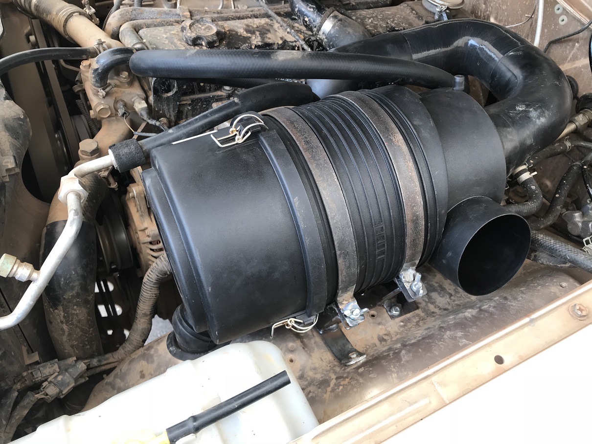

Ever since the engine install I couldn't really tell but it was losing power more and more even to a point where I was driving behind a 4.2 N/A Cruiser to Hennops for the charity day and the Cruiser was faster between traffic lights. So it got to a point where it felt that the turbo was only compensating for the 35" badly. :confused:
Even in that condition 4x4ing improved significantly and I was quite pleased, so at the end of the day just before the braai we went far a splash in the water hole, I drove through carefully because I knew my air filter is not correct as it is one of those cone type crap and was "liberated" of my cousins Land Rover, just that statement makes me kringe, should have know something will go wrong :confused: . So after driving through slowly and correctly, I stopped to check and surely some water got in. Luckily it didn't "suck" a lot of water as to cause any concern but left the filter damp. So I drove from the water hole to the lapa without a filter just to give it a chance to dry while be Braai :wink: so I decide to give it a bit of juice just to check is all is wel...maar toe voertsek daai ding. :surprised: It was the bleddie air filter that suffocated the whole system.

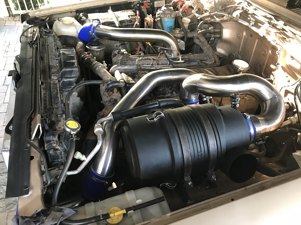

So that week I looked for the biggest Donaldson air box that I could fit under the hood and made it work, made a few brackets and had to move the Radiator overflow bottle forward a bit. It has Two filters inside. The second filter is suppose to be replaced every 3rd main filter replacement. Will see how filter life goes but the main filter is cheaper than the correct TD42 filters and is used on so many trucks and commercial equipment that it might be more freely available, but time will tell.
Donaldson 1.jpg (427.71 KiB) Viewed 7701 times
Donaldson 2.jpg (407.34 KiB) Viewed 7701 times

With the new airbox there was at last real Power :woo: and EGT's lowered considerably.

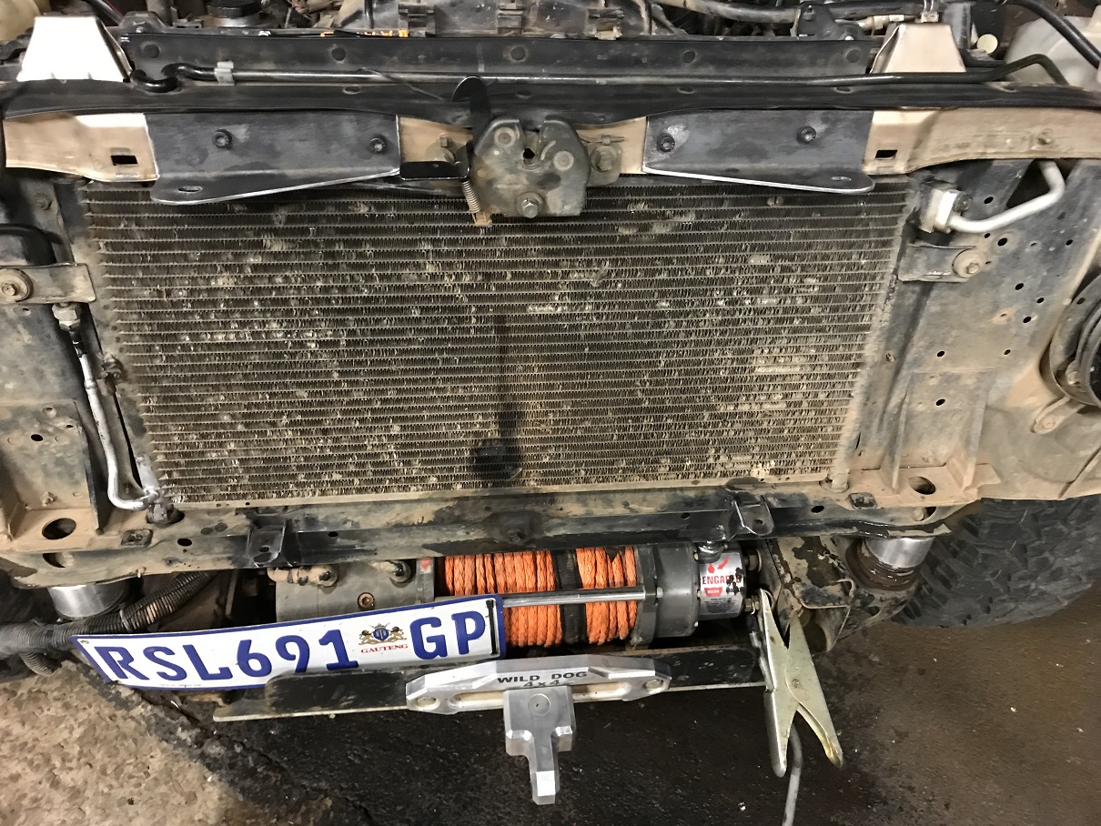

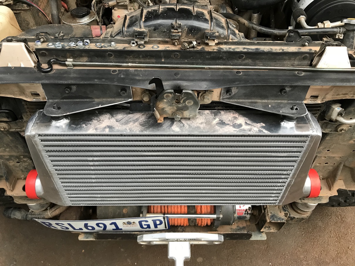

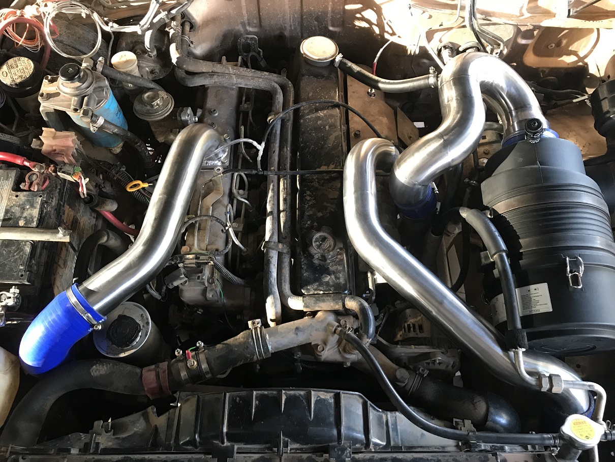

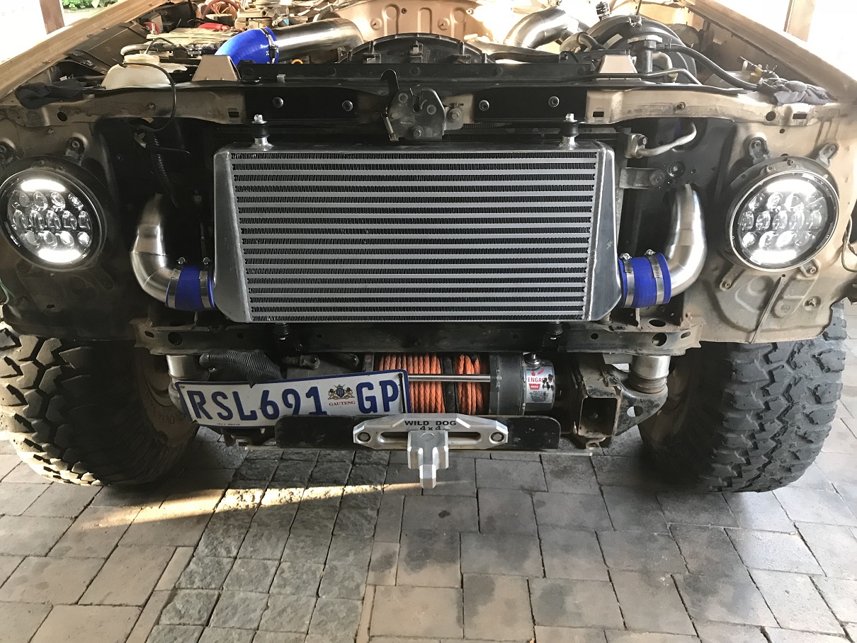

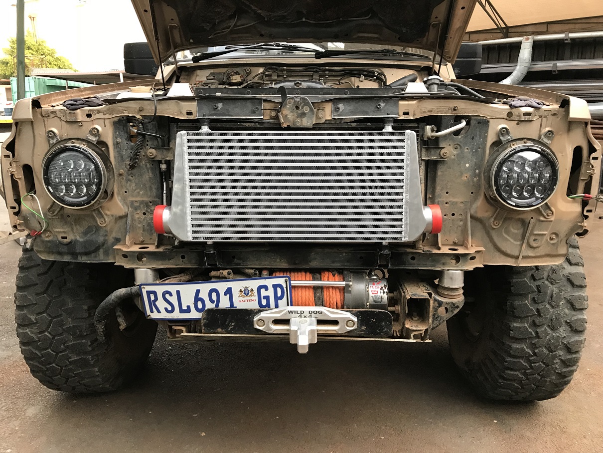

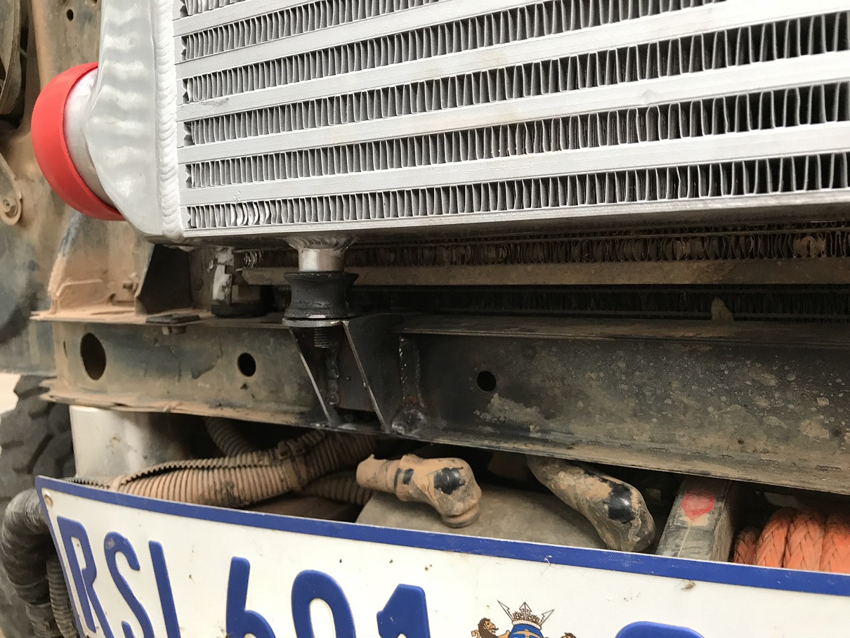

Then came the time to start with the Intercooler. I sukkel-ed on my on for a wile trying to locate a decent intercooler anywhere from truck parts to goldwagen to the turbo people and no one wanted to help or it was rediculously priced.
Finaly I gave up and asked Tinus and Micheal for help. Within a 2 days I had a decent sided intercooler in hand. 600x300x76. Go big or go home.
I made all the brackets and made it fit behind the grill and Micheal arranged for the pipe work.
The major challenges making it fit was the left aircon pipe from the condenser had to be rerouted slightly and I had to grind away about 10-20mm of the bottom of my grill.
Put it on some rubber mountings as well just to make sure things don't vibrate apart.
Aircon Pipe & Brackets.jpg (522.84 KiB) Viewed 7701 times
Top Bracket.jpg (536.92 KiB) Viewed 7701 times
Bottom Bracket.jpg (421.03 KiB) Viewed 7701 times
Front 1.jpg (507.66 KiB) Viewed 7701 times
Front 2.jpg (399.78 KiB) Viewed 7701 times
What came back today can only be described as ART.
Considering making the bonnet out of transparent perspex so I can look at it while driving. WWW
(excuse the dirty engine :doh: )
Art 1.jpg (471.79 KiB) Viewed 7701 times
Art 2.jpg (429.98 KiB) Viewed 7701 times
Art 3.jpg (461.1 KiB) Viewed 7701 times
It walks as koel as a Komkommer now :rolling:

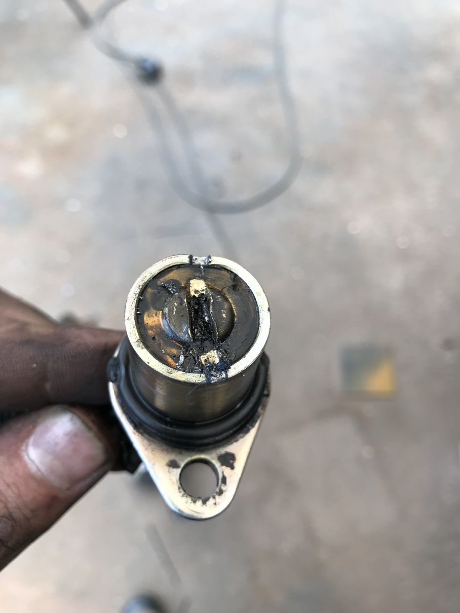

Tip one: when changing engines, listen to advice on the protrusion of pins that is used to count your revs and don't just sommer exchange sensors. :doh:

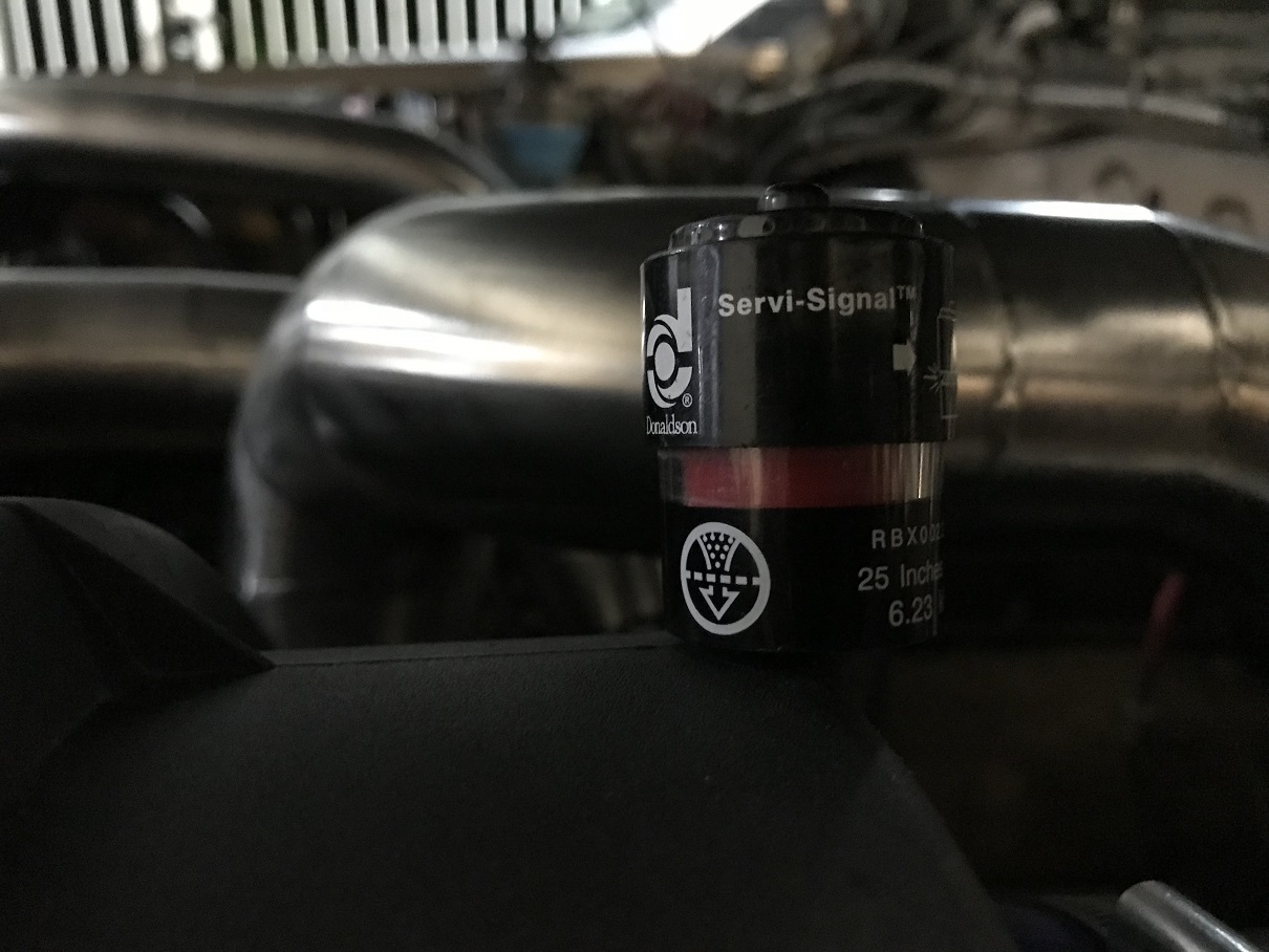

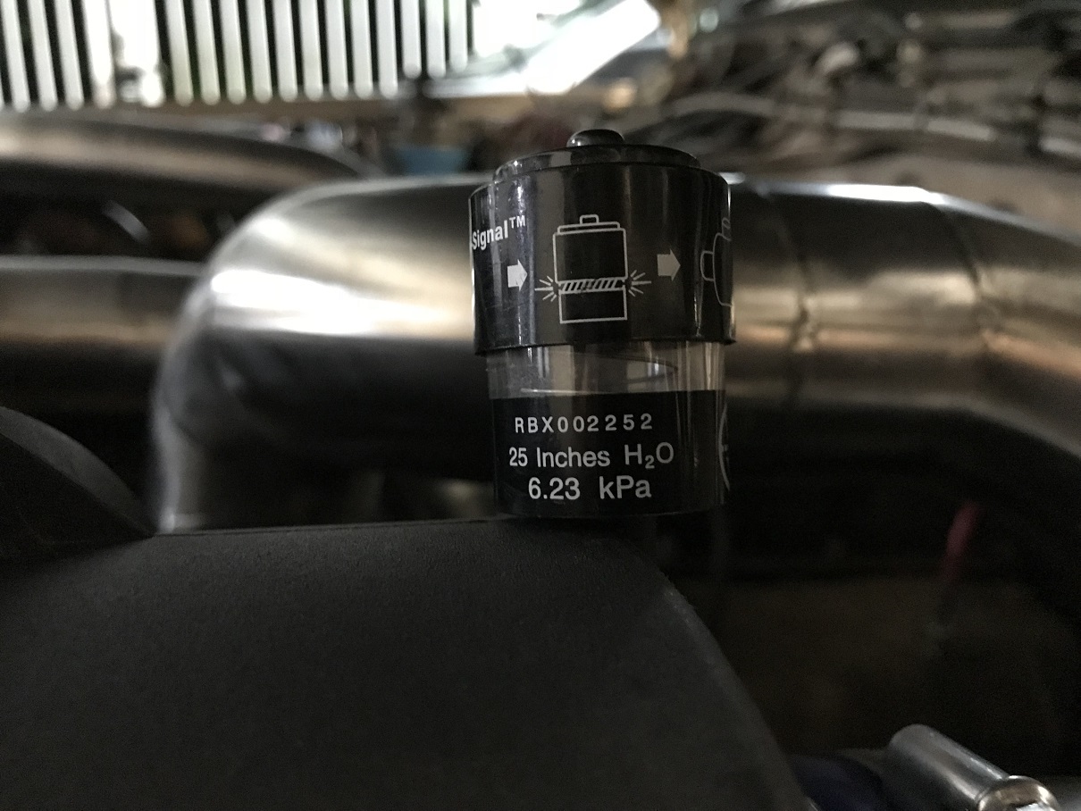

Then Donaldson has a thingamajig that can notify you when it is time to change your airfilter, a restriction meter.
Borrowed one from Tinus just to see if my airbox is flowing nicely and it does seem to.
Restriction Meter.jpg (298.63 KiB) Viewed 7699 times
Simulated Dirty Filter.jpg (263.19 KiB) Viewed 7699 times

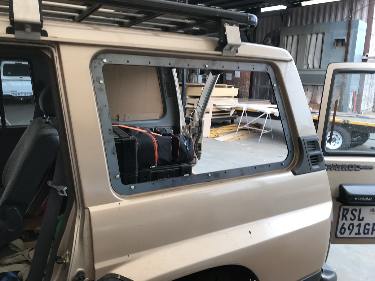

I also made a bit of progress on the gullwings, just enough to figure out that simply welding a piano hinge to a frame will not clear the round corners of the cab :doh: but all ready got some different hinges to try next week. Really want to finish them because I have been driving with MDF panels since the river trip and they are one rain storm away from weetbix :confused:
Gullwings Prep 1.jpg (295.63 KiB) Viewed 7699 times
Gullwings Prep 2.jpg (295.97 KiB) Viewed 7699 times

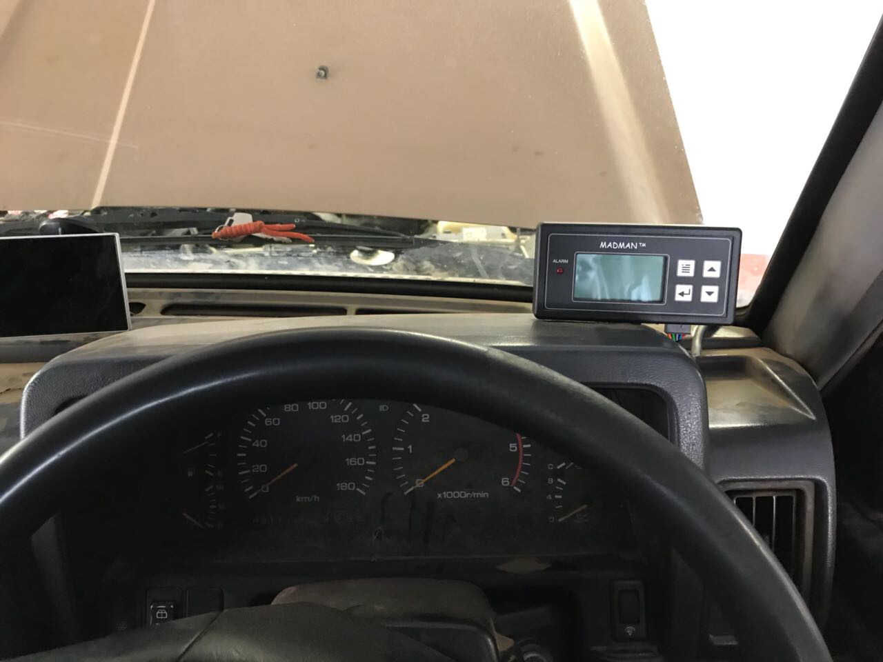

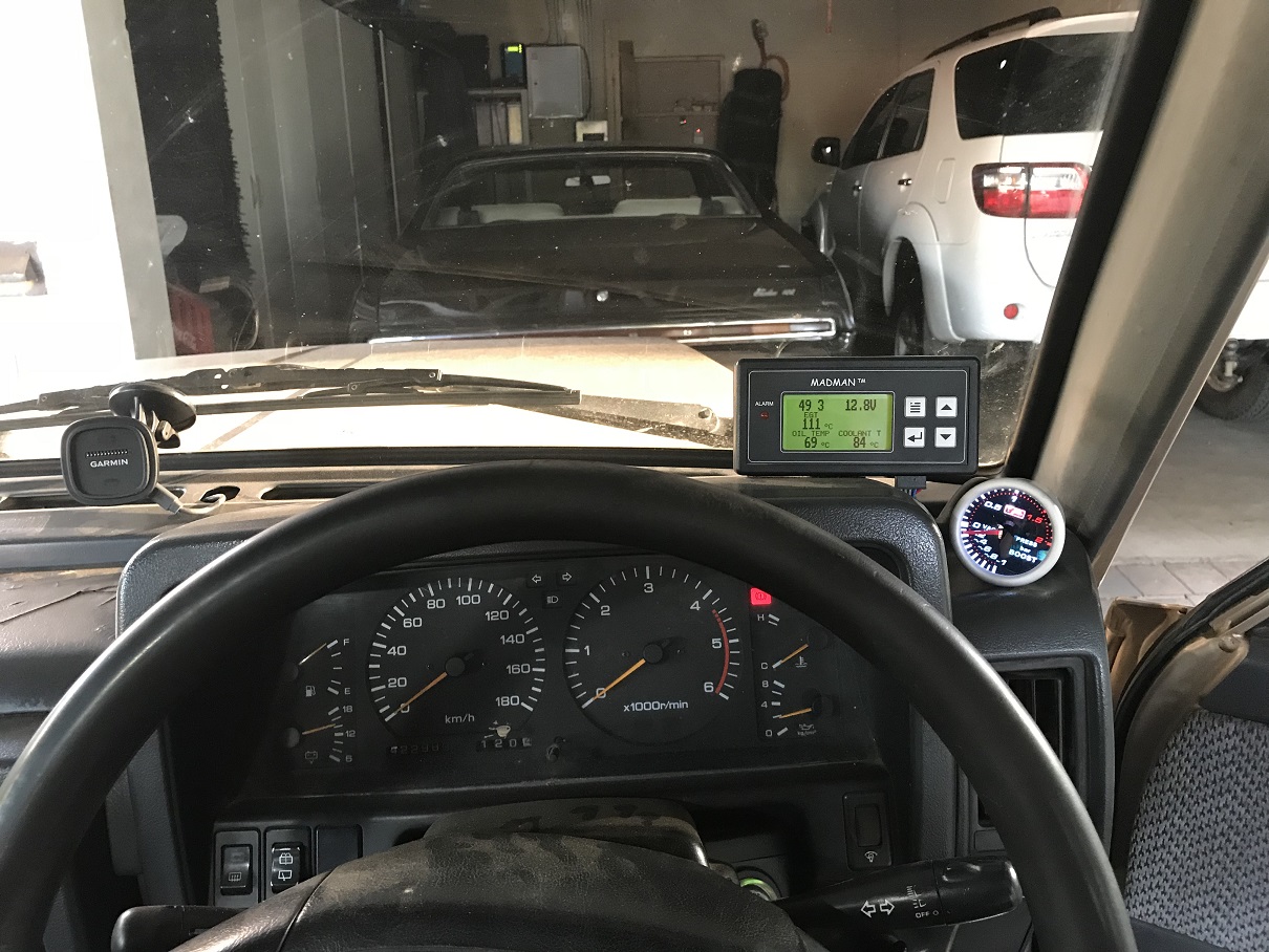

I would also like to build a nice Dash box for a 2-way radio, Madman and Boost gauge. Double sided tape does not look that good. :naughty:
