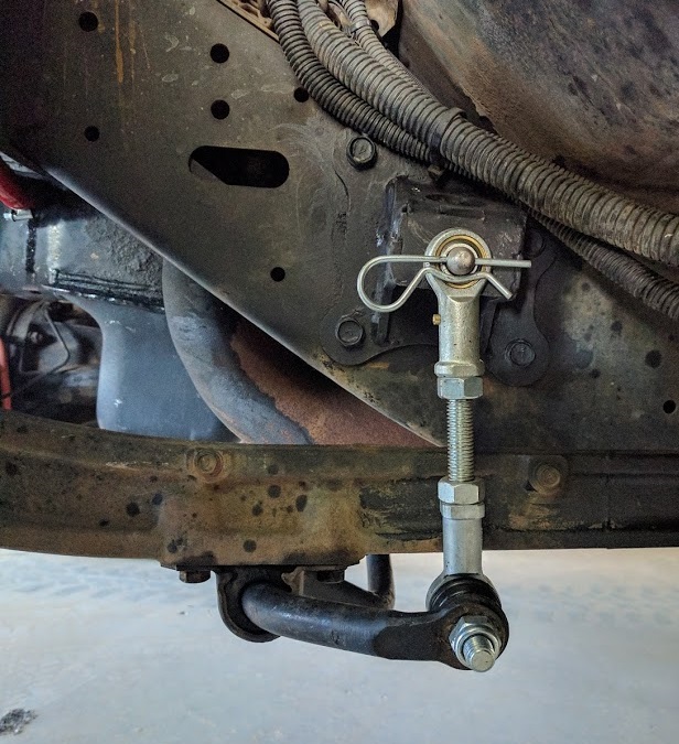

Steve, i did consider all these point during the design phase. Here are my reasons for ending up with this particular setup:
1) I made the QD end at the top, because i was concerned that brush would remove the R-clips. If I could find some of the beautiful clip-on ball joints I saw on a fancy jeep the other day, i would consider swopping.
2) With regard to disconnecting only one end, consider what happens if the dis-connected is the one which is "drooping", whith the other end fully compressed.
In this case, the disconnected end will be pointing almost straight down, ready to snag on anything handy.
On the Jeeps, the sway bar is mounted much higher than on the Patrol, where it is mounted at just about the lowest point of the car....
Hope that makes sense?

Re: Front anti-sway bar QD's
On the first tab, ,which is a picture of my V8's set-up, you will notice that there is a reusable cable-tie permanently strapped around the radius arm. This is what I use to strap up the connecting rod when disconnecting. It works well for me. So no flopping around of the connecting rods.biggles wrote:![]()
Me too...
But I had disconnects on the Jeep and found that disconnecting one side is better. That way there is only one side connector to flop around and you don't have to worry about securing the swaybar out of the way either.
From my experience with the Jeep disconnects may I give some constructive criticism? Tough, here it comes anyway
Have the disconnect only on one side and they disconnect at the swaybar. You then have a place on the chassis where the free end of the connection rod attaches using the same clip.
Just another comment, observation I have.
On the GU, it makes a heck of a difference in handling, on the road between connecting and not connecting. Not connecting makes the car body roll big time.
But on the GQ it seems to matter much less. Skilpad does not have a front stabiliser on. It is lifted 4 inches and does not body roll nearly as much as the GU.
Yup, all valid concerns. I never lost a clip on the jeep. If you do go both sides and disconnect at the bottom you can use the connects to secure the sway bar up and out the way.Peter Connan wrote:Steve, i did consider all these point during the design phase. Here are my reasons for ending up with this particular setup:
I checked clearances a while back and while I only checked one side with the wheel on a ramp and the one side disconnected there were no issues. I was concerned that if you leave one connecting rod attached that at full droop it still limits travel. That was when I discovered how bad the articulation is on the front axle.
Yes, but considering that these were intended to be usable in conjunction with the X-link, which significantly increases front axle articulation, I think it gets much worse.
