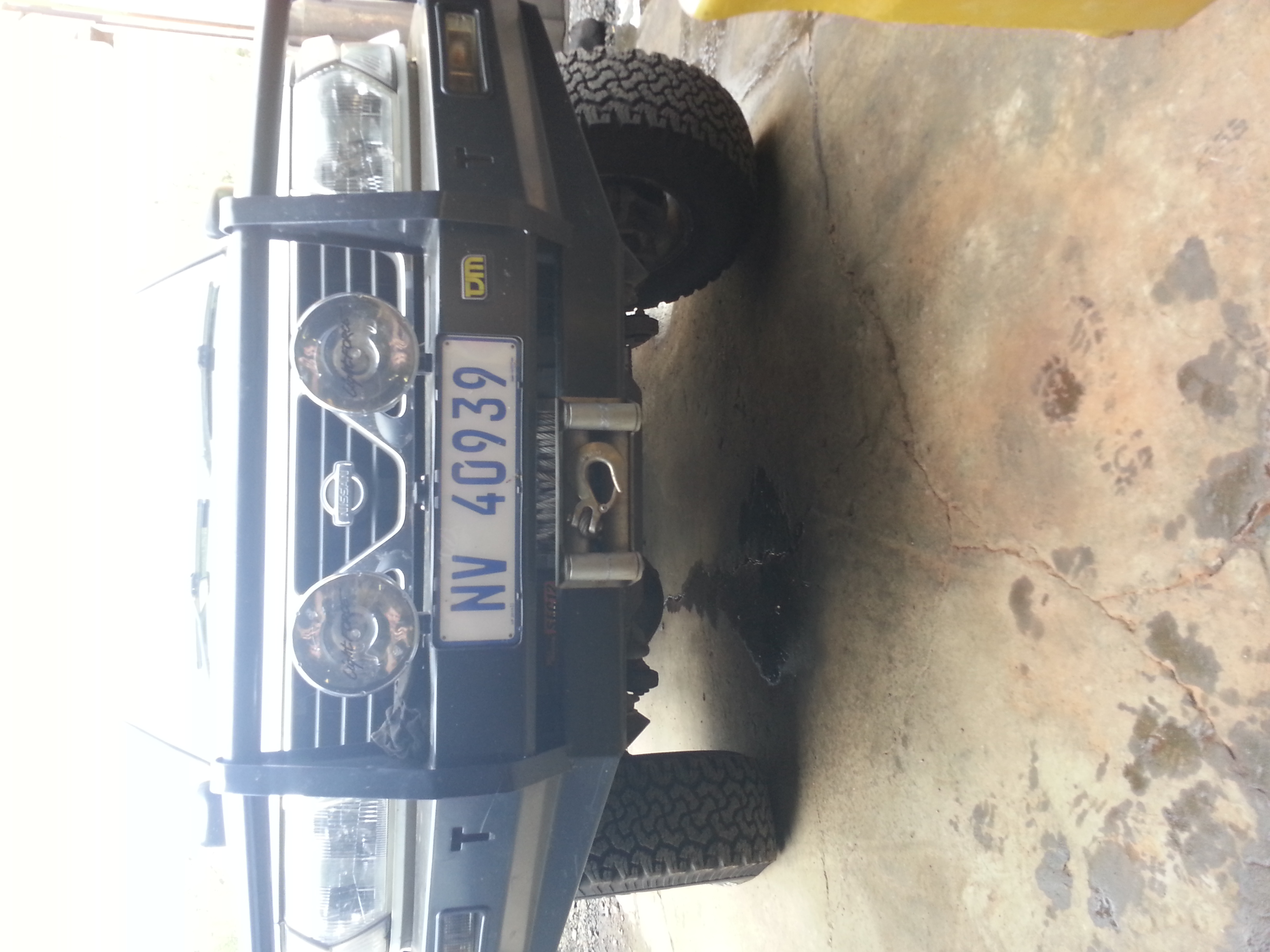

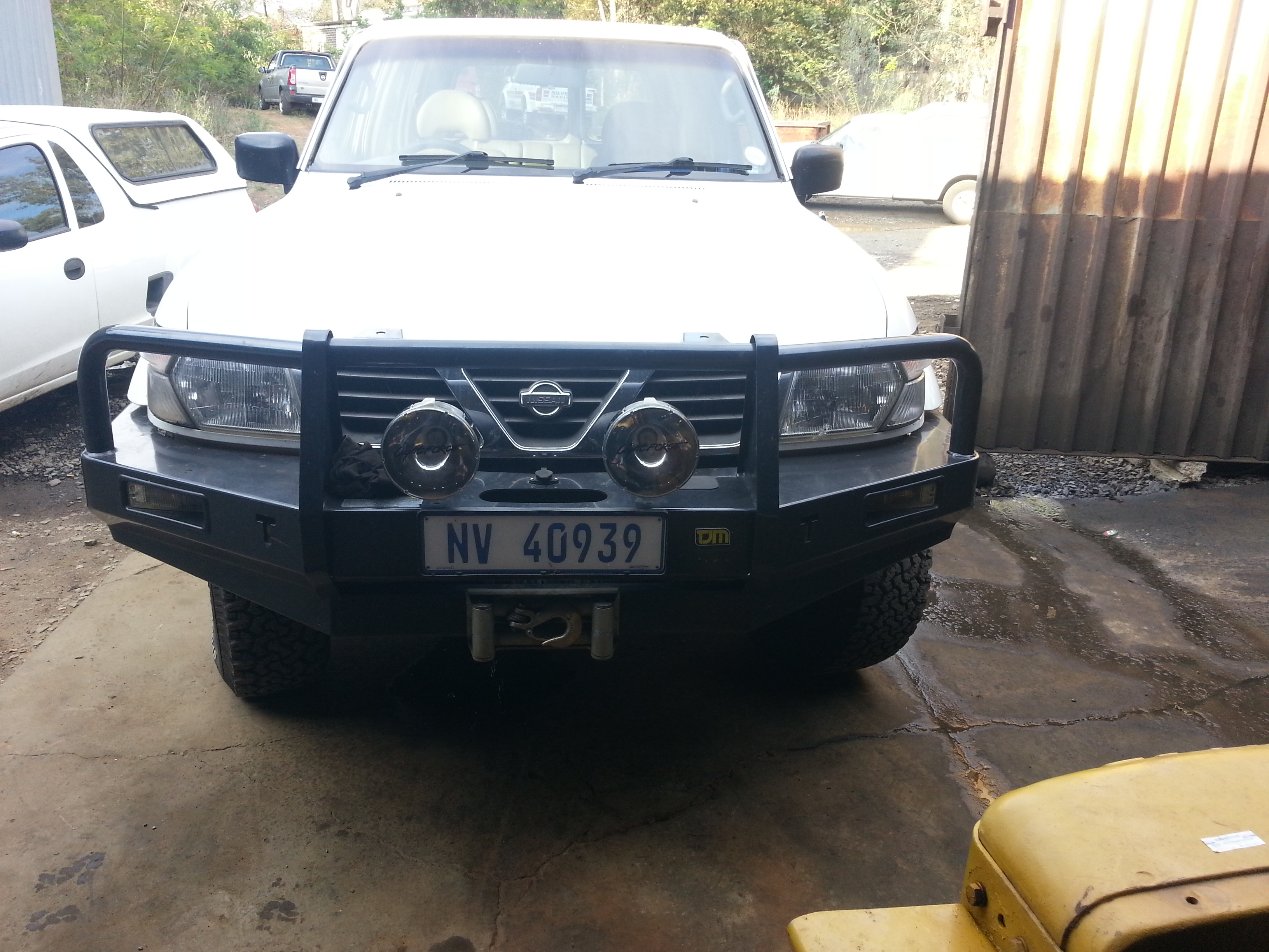

Here is the Front of my Patrol. I Just set my Timing aswell and i don't hear any ping noises anymore. Got her to 80km in 5th gear up a hill and don't hear anything. Tried to get it to heat up but like i said earlier, it only starts after about 150km or so.
We are coming to Pretoria this weekend so i will see what she does.
Front 2.jpg (1.37 MiB) Viewed 2376 times
Front 1.jpg (2.22 MiB) Viewed 2376 times

Also you will see on the 1st pic that came out sideways, some water under the car, its not my cars water :) Not hating on anyone but there was a Hilux that needed a radiator fix parked in that spot :)

Meer as halfte van jou radiator is toe Louis...

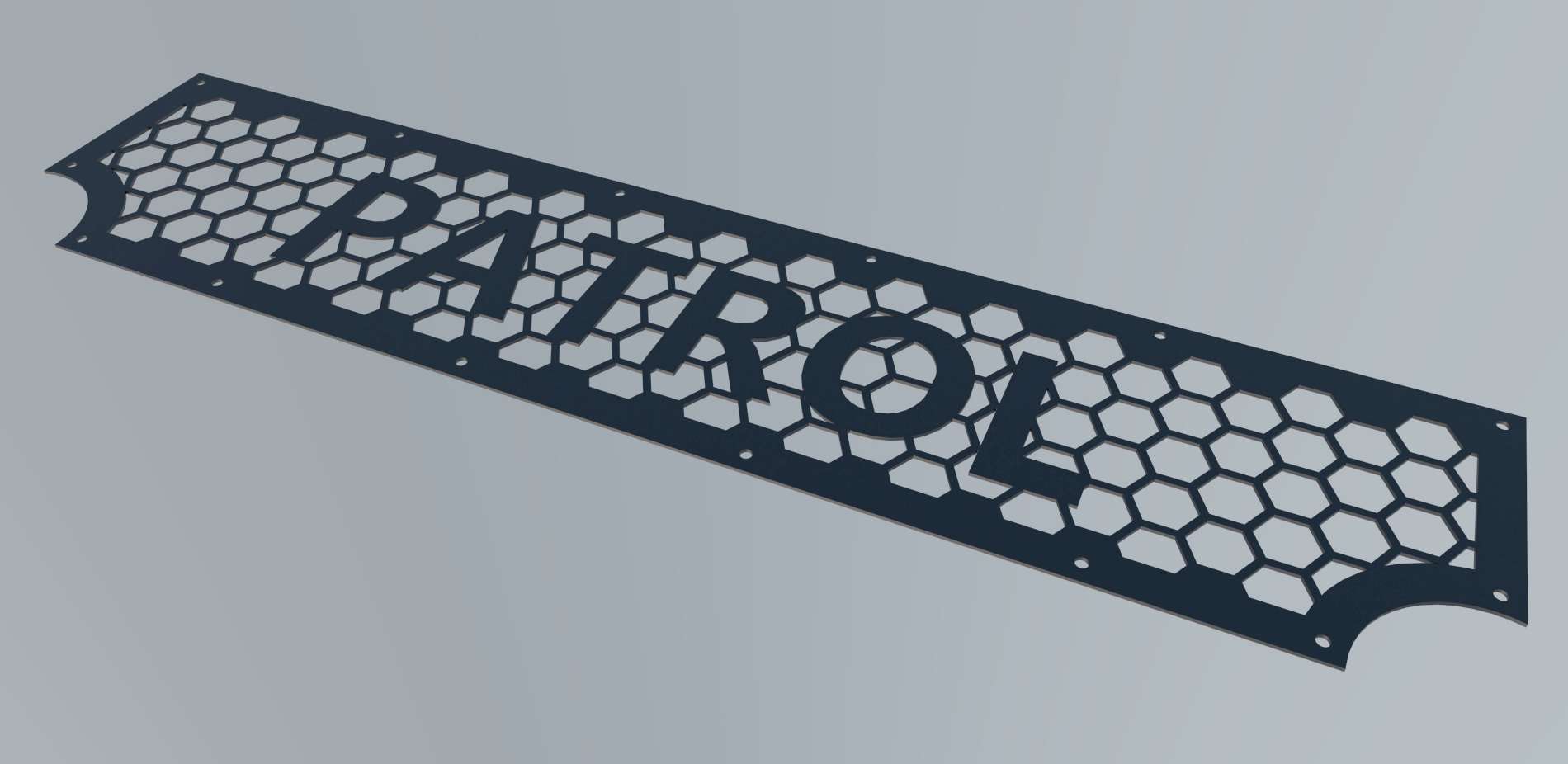

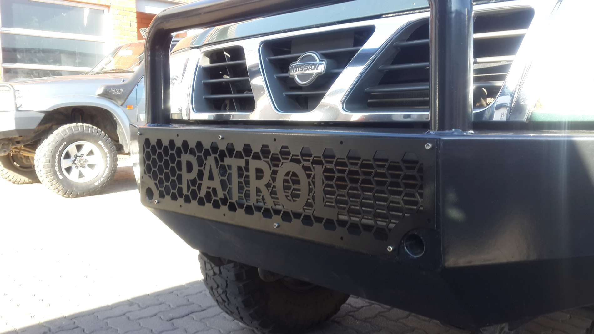

maak so plaatjie soos wat Michael op sy 4.2 het.
http://www.patrol4x4.co.za/viewtopic.ph ... =90#p65646

Louis - I think 1 thing at a time or you will never know what caused it. Timing is done so carry some spanners on your trip. If it continues to heat up then remove those spots and see if that makes a difference.
I like Fanus's idea about doing the same as Michael and then put your number plate on hinges over the fairlead.
