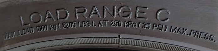

petrol wrote:Ek sien dat die meeste bande vir 15" rims waar die band se od 32"+gaan is die maks laaigewig maar so 1 ton en maks band druk is maar 35 psi. Is dit nie te laag vir die patrols nie?
Sulke groot bande ry met laer druk as laer profiel bande. Myne werk lekker op 2 bar, of dalk op na 2.2 bar as ek swaar laai & snelweg ry.
... en 4 x 1 ton = 4 ton - heelwat meer as die bruto gewig van 'n Patrol!
Maar 2.2 bar is klaar meer as 30 psi, so jy is amper by die veilige limiet.
Meeste ouens wat laaistelsels agter in het en n dakrak gaan by die 2 ton agter wees, weer by die veilige limiet.
Ek dink net jy moet baie seker maak van die bande se veilige limiete veral wanneer jy 15" gebruik

It seems that pretty much all the 33/12.5r15 tyres speed and load rating is 108Q
108 = 1000kg per tyre
Q = max 160km/h
(according to errolstyres.co.za)
And according to tiresize.com, most(or all?) 33/12.5r15 tyre's LT Load ranges are "C", which equals 50PSI.
https://tiresize.com/how-to-read-tire-size/
Posts: 3367
Has thanked: 249 times
Re: 15" rims
:think: on closer inspection, it appears that most 33/12.5r15 max safe pressure is actually 35psi and not 50psi. :redface:
(was looking at the "C" rating which is suppose to equal 50, but looking at each tyres individual rating for example: https://tiresize.com/tires/BFGoodrich/M ... TA-KM2.htm, it indicates 35psi and not 50psi.
So does that mean that you cant inflate a 33/12.5r15 to more than 2.4bar?

SJC wrote: :think: on closer inspection, it appears that most 33/12.5r15 max safe pressure is actually 35psi and not 50psi. :redface:
2.5 bar and 1000 kg on Bridgestone Dueler 673 MT33/12.5r15:
Max load and pressure
Never taken them above 2.4 bar though - I like my spine in one piece and my teeth inside my mouth...
Christo (the snake man)

It seems that all the 33/12.5r15's are max 35PSI.
On my 16" tyres (255/85r16), I usually inflate them to 2.5 - 3.0 bar depending on the load. And they are comfortable at these pressures.
(They are rated max 80psi, same as 285/75r16. )
