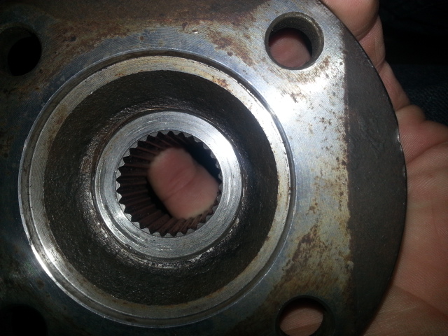

If you give me the dimensions (OD, Spline OD, Spline ID and number of teeth, I can calculate the point of failure for you.
But doesn't that thing sit in a bearing?

Its darn useless trying to post a pic from a phone, and I dont have internet at home. I will have to post tomorrow at the office. But from what I can see the flange just pulls up against the bearing. I will also go take some measurements as soon as I get home and take a pic or two.

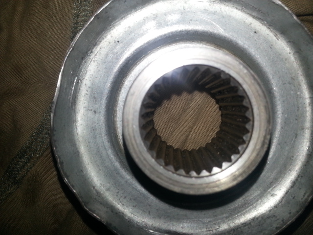

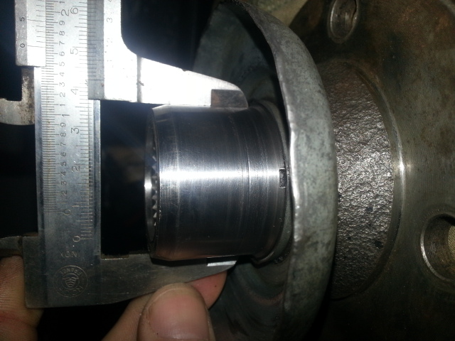

Not sure if my caliper can not get to the bottom of the spline teeth, but I only measure the splines at around 1,25mm.
Wall thickness with splines to the top of the spline is 7.5mm and between the spline teeth is just over 6mm.
Length of the splines is 42mm.
Hope that all makes sense. But so far I am at dead ends finding alternative seal of any spec smaller than standard at the normal suspects like Autozone and BMG.

Peter, don't worry about trying to stress test this thing, I just spoke to Specialist Seal Services and they say there is no seal available anything smaller than the one I have. She even told me that this seal must be for a Nissan, because it is only Nissan that has these strange sizes. She suggests the polishing route as I should have 1/2mm to work with, and then I can still tension the seal spring up slightly to assist the seal. Then she also suggests the use of a speedy sleeve if all else fails.
So now to see who can polish my shaft
