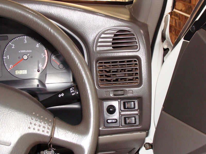

Cedric, go scrapyard hunting and find yourself some nice Nissan switches for your spots. Mine illuminate when I turn the headlights on at night (no more fumbling about), and they blend in ever so nicely with the look of the dashboard:
The top switch operates the LEDs on the roof rack (wired directly to the battery via a relay - daylight on demand!), the bottom switch operates the two round spotlights on the bull bar (wired through a relay that only works when the brights & ignition is on).
