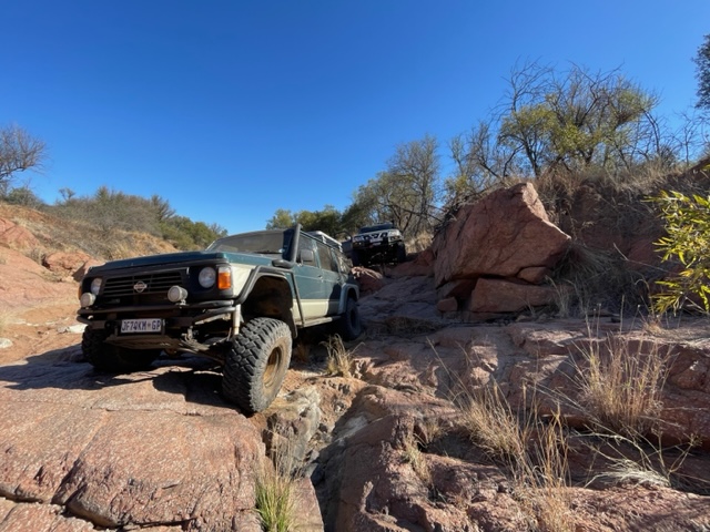

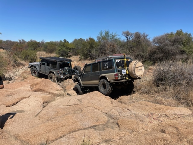

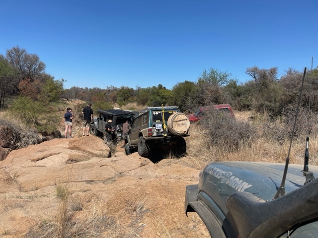

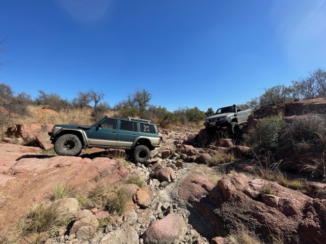

So this weekend I went to Mathole (near Moegatle).
This was like Carnage, except almost harder. More large rocks to navigate.
We stopped at about half way as I lost drive on the front axle.
Not confirmed yet, I have either broken the locker (hopefully), or it is the crown wheel and pinion. The hubs and CVs seem fine.
Will post some pics and vids
