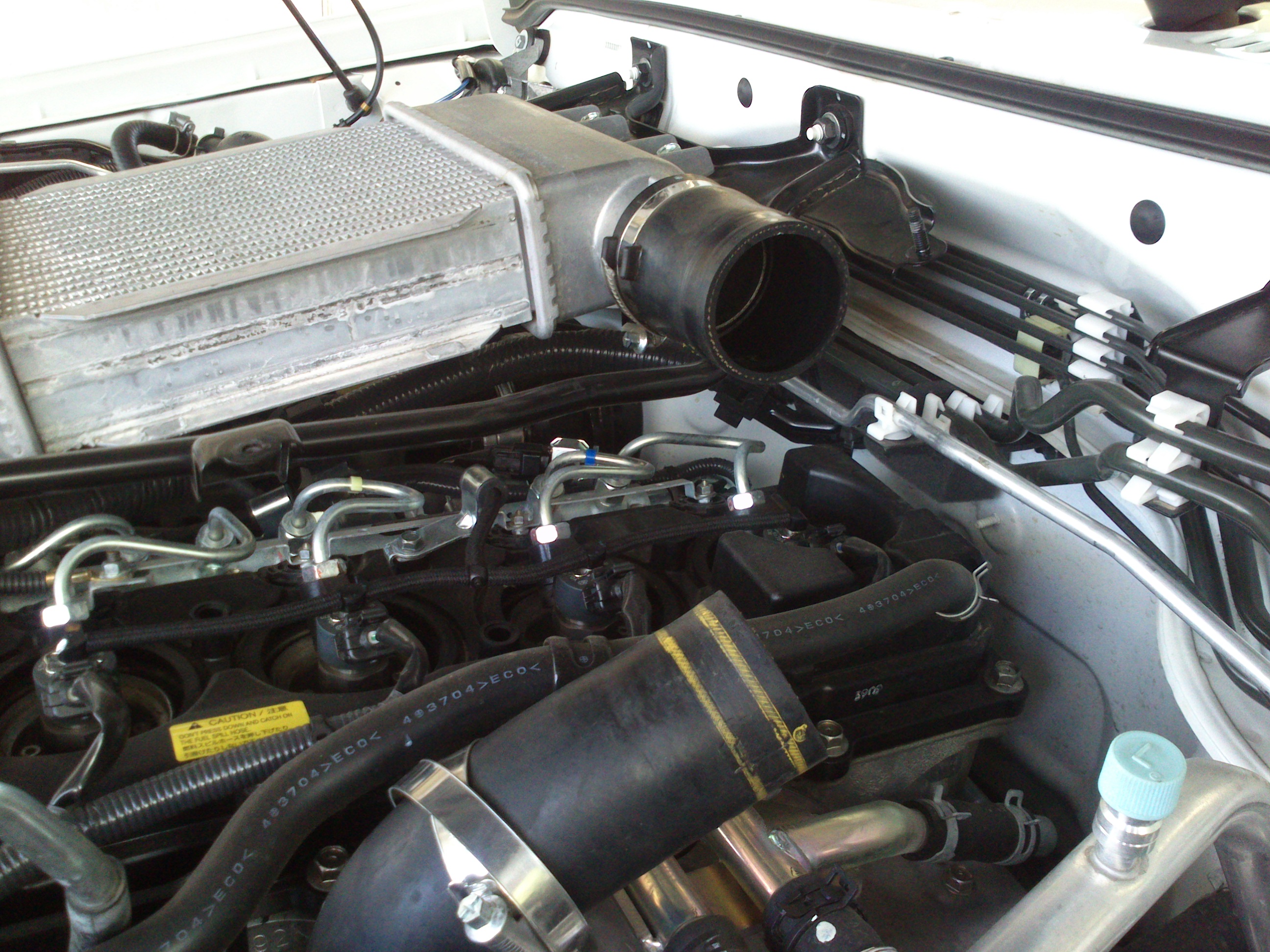

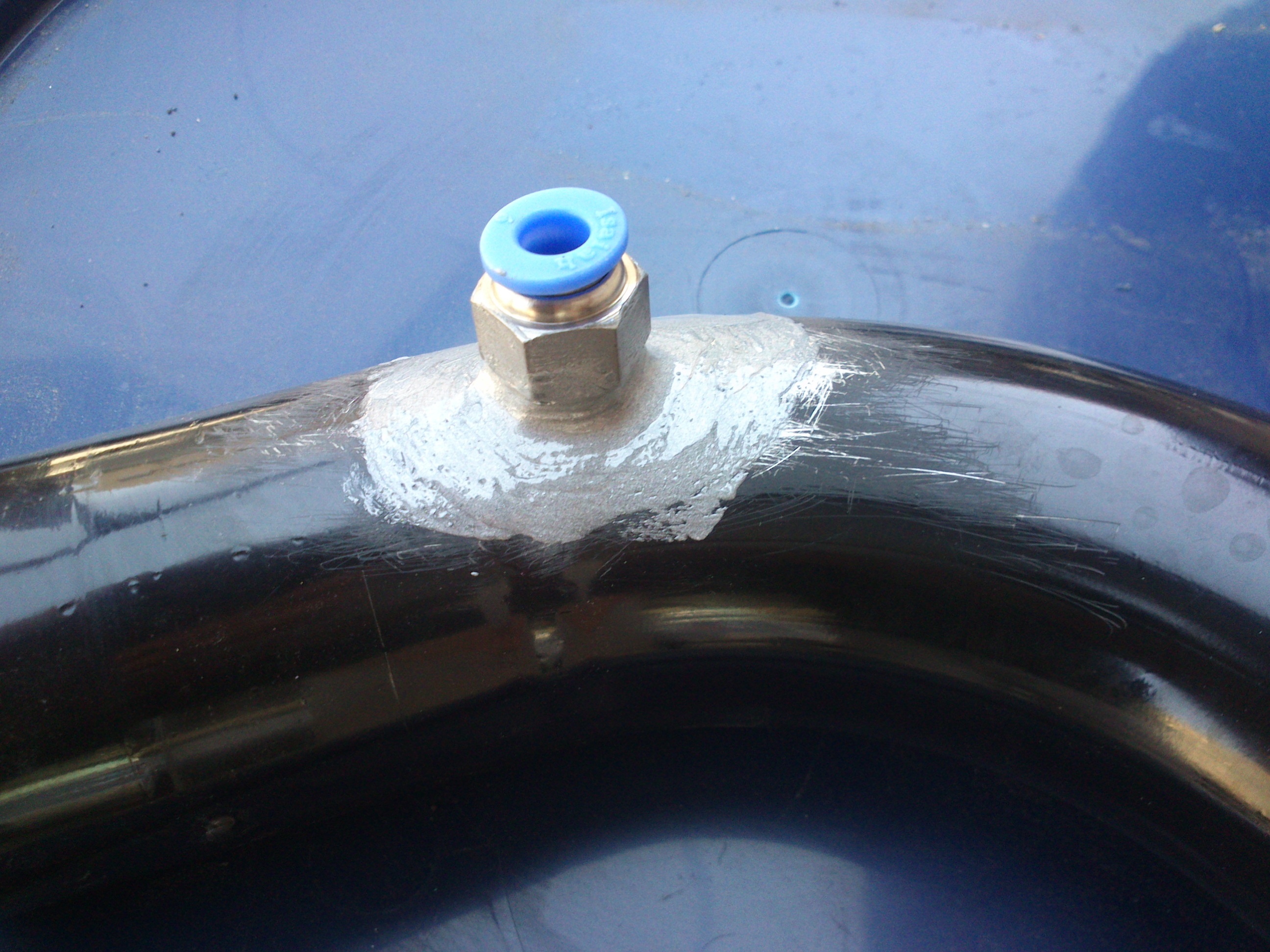

Hi Josh
If you follow your pipe from your turbo to your intercooler ,there is a metal pipe just befor your intercooler , I put mine on the backside facing the fire wall
you just release the two hose clamps and out it comes , I got a nut with the same thread as the sender unit and tig welded it on to the pipe , the big job is routing the wires through the firewall which is very thick , i run my wires for my madman under the gearbox tunnel where the it was a little easier to get through where the leaver for the gearbox goes into the inside of the vehicle , i will take a picture tomorrow and put it on the thread,i also did the water temp and water low, i did not borther with the temp in the sump plug , i was worried that it could be knocked off
regards
juice

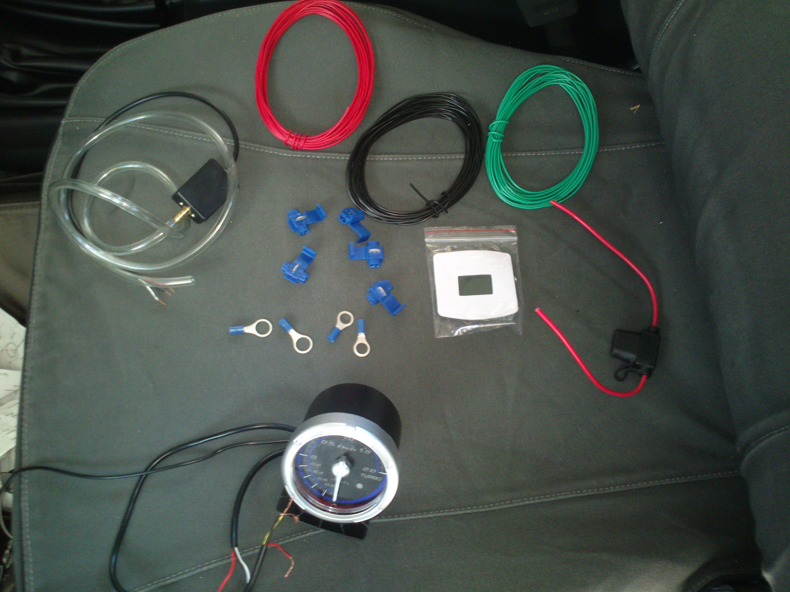

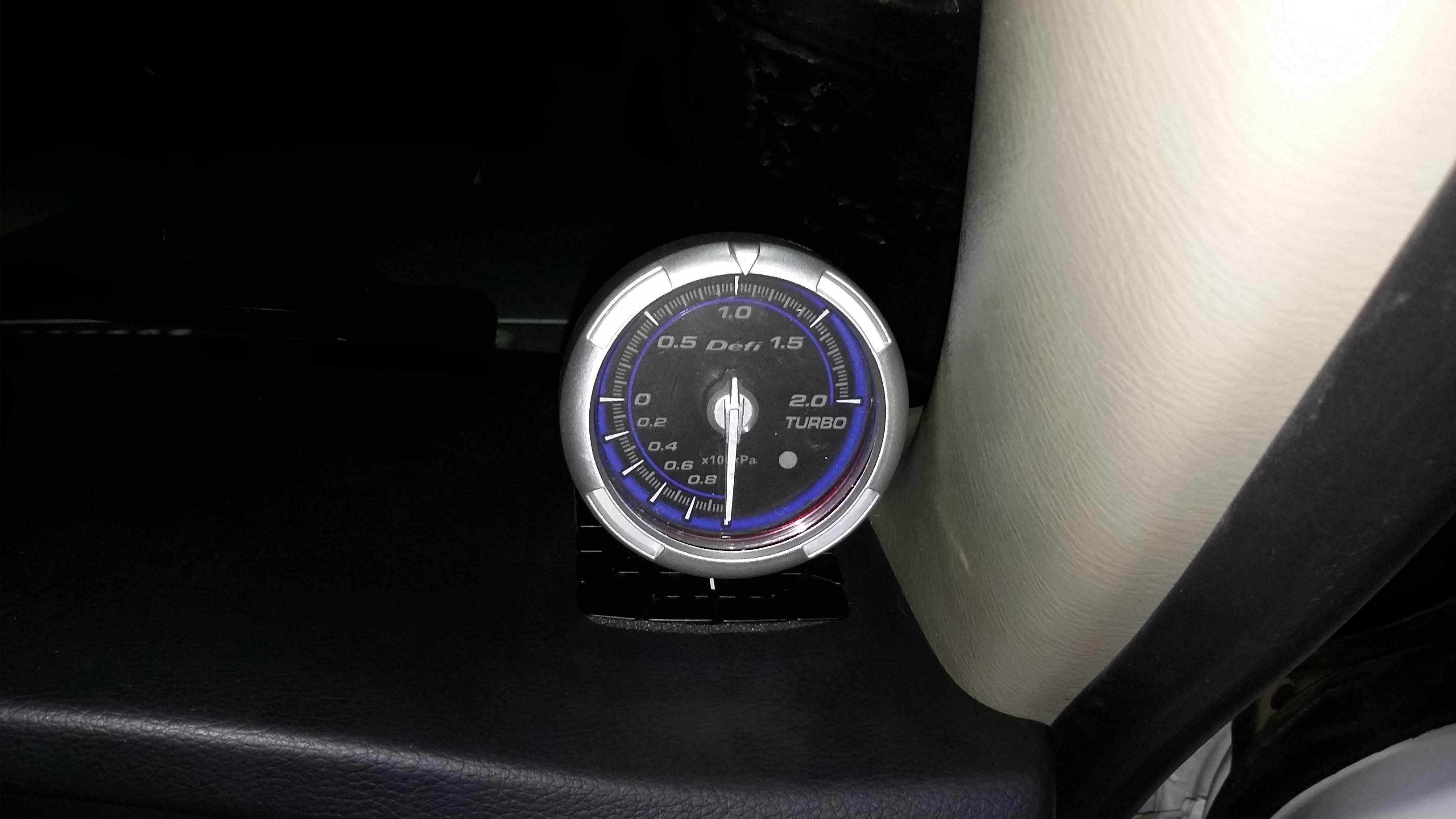

I fitted the fitting for the pipe into the pipe juice mentioned cause this seemed the easiest to rectify if I screwd up. Got to have back-up plan
I drilled a hole in the pipe and tapped it. Screwd in the fitting and added pratly steel just to make sure. It went in real tight. Pulled the wires through a rubber plug that covers one of the wiring harnesses that goes to the side of the driver foot wall. Connect everything and vualla
Boost fairly steady at 0.7bar. When coasting you can see when the EGR opens. Boost drops right down to 0.2. (Remember I adjusted the VNT screw blindly). I will re adjust it once the EGR is blockdd of so that it gives 0.9bar.
I don't experience any over boostbor eratic boost. Most I saw was1 bar and that is just quickly. I'm happy

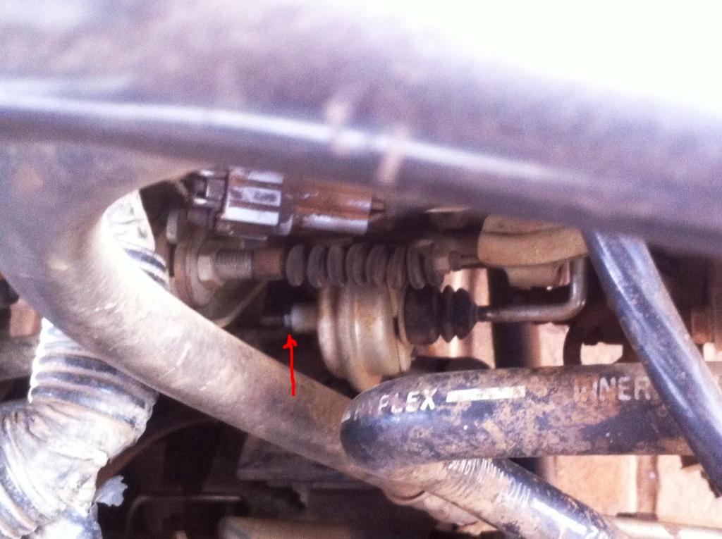

Michael, as jy na die foto hieronder kyk, is dit waar mens die verstelling doen om te verhoed dat die engine te hoog ref/idle wanneer die aircon aan kom?
- photo.JPG (94.36 KiB) Viewed 3811 times
- Been thanked: 432 times
Re: Madman / Landy on line
Daai is die een Fanus!SJC wrote:Michael, as jy na die foto hieronder kyk, is dit waar mens die verstelling doen om te verhoed dat die engine te hoog ref/idle wanneer die aircon aan kom?
