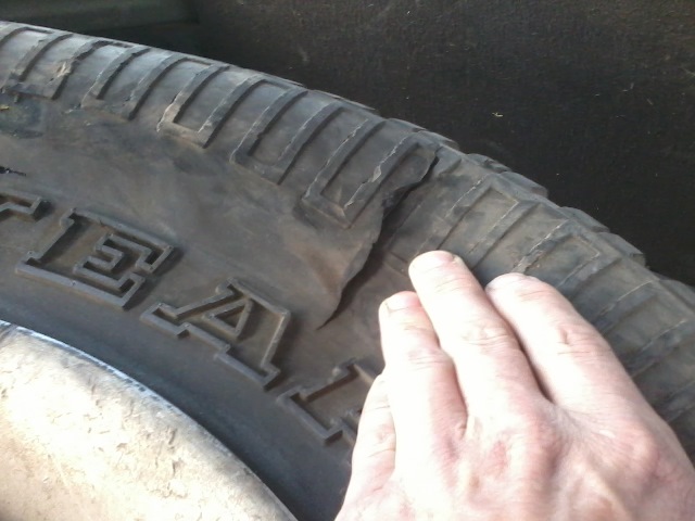

I just saw this discussion now, and as it was my vehicle on the other end of the recovery, I suppose I should have taken charge of the driving. Emil had jumped in, and besides not having much off road experience, has hardly put any time in behind the wheel of the Sani, and obviously even less in the "being recovered" situation.
He seemed to struggle to get the power delivery balanced to just keep the wheels turning constantly. As soon as the revs started picking up, the turbo would come in and the revs would run away with him. He feels bad enough about it, but I think, lesson learned.
As I was not driving, I can't vouch for the traction or lack thereof after the ledge was cleared that stopped the initial progress.
As the other D21 HB made it up there with lower ground clearance than what Hillbilly has, I can only think that it could be the tyres and/or the driver (me). These wranglers were disappointing me the whole day with hardly any grip and lots of sideways slide. I returned the favour and exercised my revenge by splitting one of them open from tread to rim on the very next corner after this recovery.
