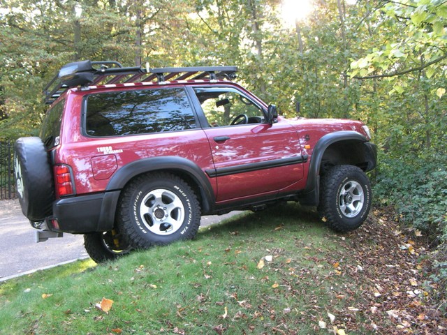

Ek was eintlik oppad om Diesel te gaan in gooi, maar ek kon nie daai wal weerstaan nie :lol:
Essex 2.JPG (144.6 KiB) Viewed 3138 times
Nissan Patrol 2005 3.0 TDI D
Back to a Patrol again! Yippee!

Fred, lyk my ons lei aan dieselfde siekte. :wink: Daai kar van jou is dam maar sexy. :thumbup:

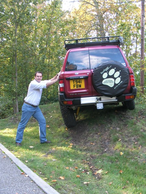

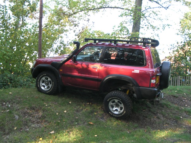

Not bad , a few pics of my current baby ... if i don't get trashed for not having a patrol yet .... :redface:
Sway bars removed
