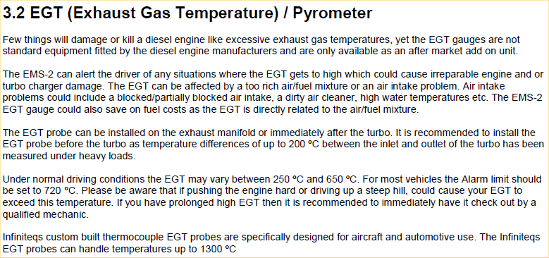

But EGT , I have read up a lot about it . Once I have alo read a report by Peter Bilt trucks re. EGT.
Firstly, why EGT is so important to keep down is the following.
Above 720 deg C the metalurgical properties of some metals start to undergo a change, this why the 720 -750 deg C as upperlimit is very important.
Operate above that for considerable time and BANG!!!!!!!!!!!!!!!!!!!!! the alloys and metal start to show stress and you have turbo or engine part failure.
Remember there is a difference of approx 180 deg C between pre and post turbo. Pre turbo its hotter and after the whirl in the turbo it cools down. Always install EGT probe as close as possible to TURBO if post installation. So the upperlimit for post turbo is approximately 550 deg C.Pre turbo anywhere in the exhaust manifold is fine.

I forgot to post Madman's EGT setup info, some useful info regarding air restriction & EGT:
Madman's pyro setup
Madman's pyro setup
EMS2 EGT.png (70.22 KiB) Viewed 1687 times
