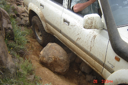

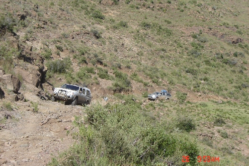

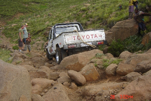

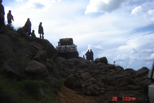

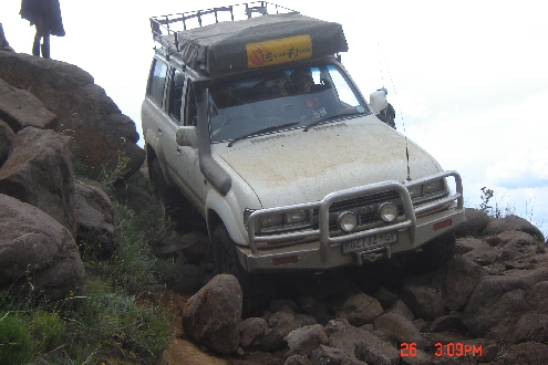

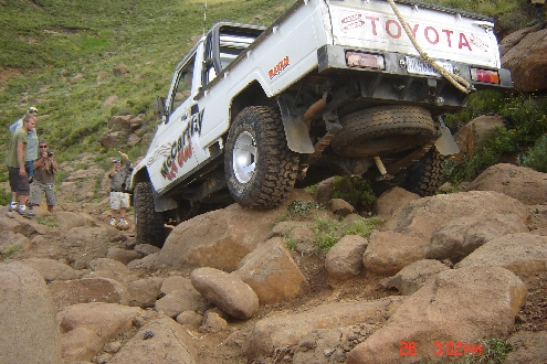

When we went up Baboon's Pass I was the first to have a mishap on the up - Broke the steel inflation valve clean off the rim ... We had to put the spare on.
Then, on the route, TWO steel rims got bent out of proportions and none of the mag rims gave any trouble [except for some "skuurmerke" [but if yo drive Baboons and expect NOT to pick up scrapes and scratches & dents and nicks to your rims, go find Alice ,,, you'll find her in Wonderland :wink: ]
I sold my steels, only have mags, even on the trailer and the caravan .. and thus far I've been Blessed [if you dunno what that means, you can call it "lucky"]
Net om te bewys - Ek en BRUTUS was ook daar
