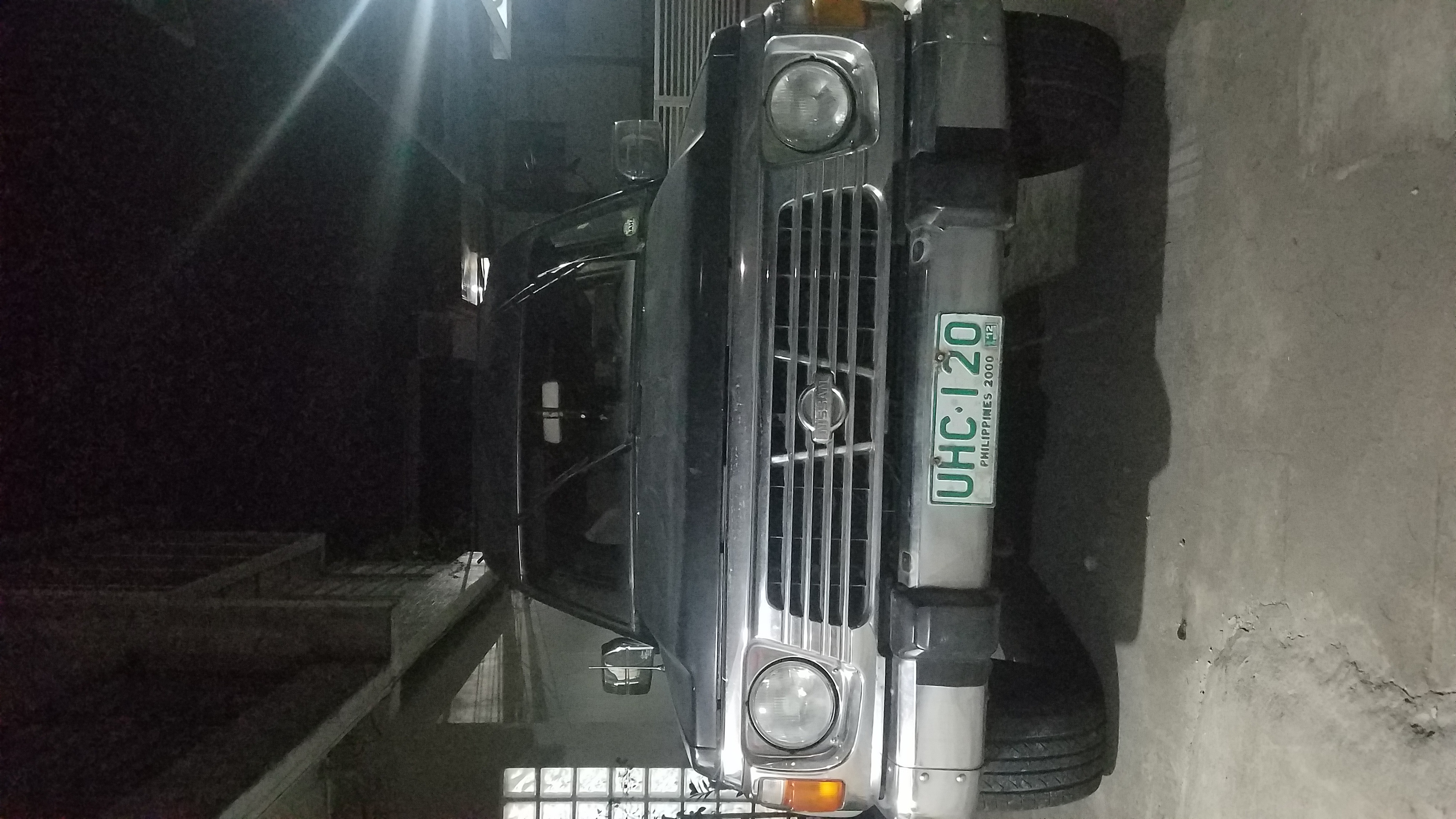

Well, this thing could be mistaken for a shit box, but its my shitbox.
Got the father in law to help out. Sorted a jack and tool kit, the bottle jack didn't have the crank arm. He custom made a tool bag like one of those roller types.
Now got to do the oil. It is practically solid.
Took another short trip loaded with 8pax (2 Philippines= 1 American). Lots of hill /mountains around here. She made it, but temps got to 3/4 of the way to red. I was watching puckered a bit.
