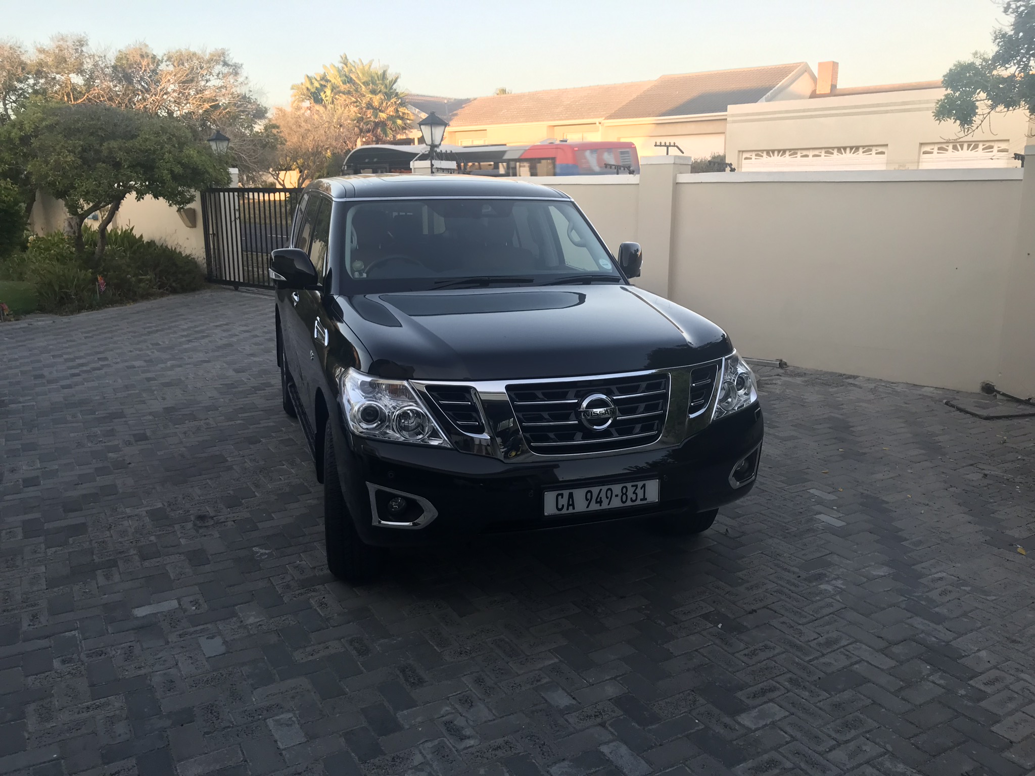

Good looking rig :thumbup:
Enjoy.

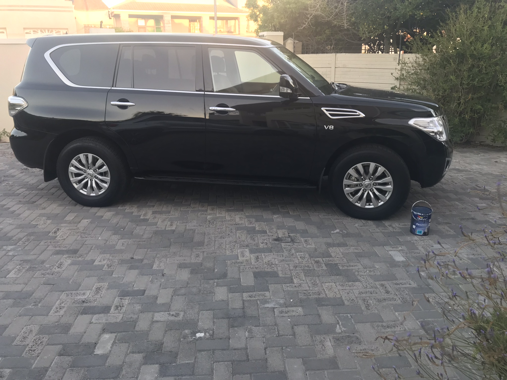

:rolling: :rolling: :rolling: .... did you use the Dulux to paint it black?..... hahaha
Nice machine !!!

That looks very good, can't wait for photos of the mods you want to fit to it.

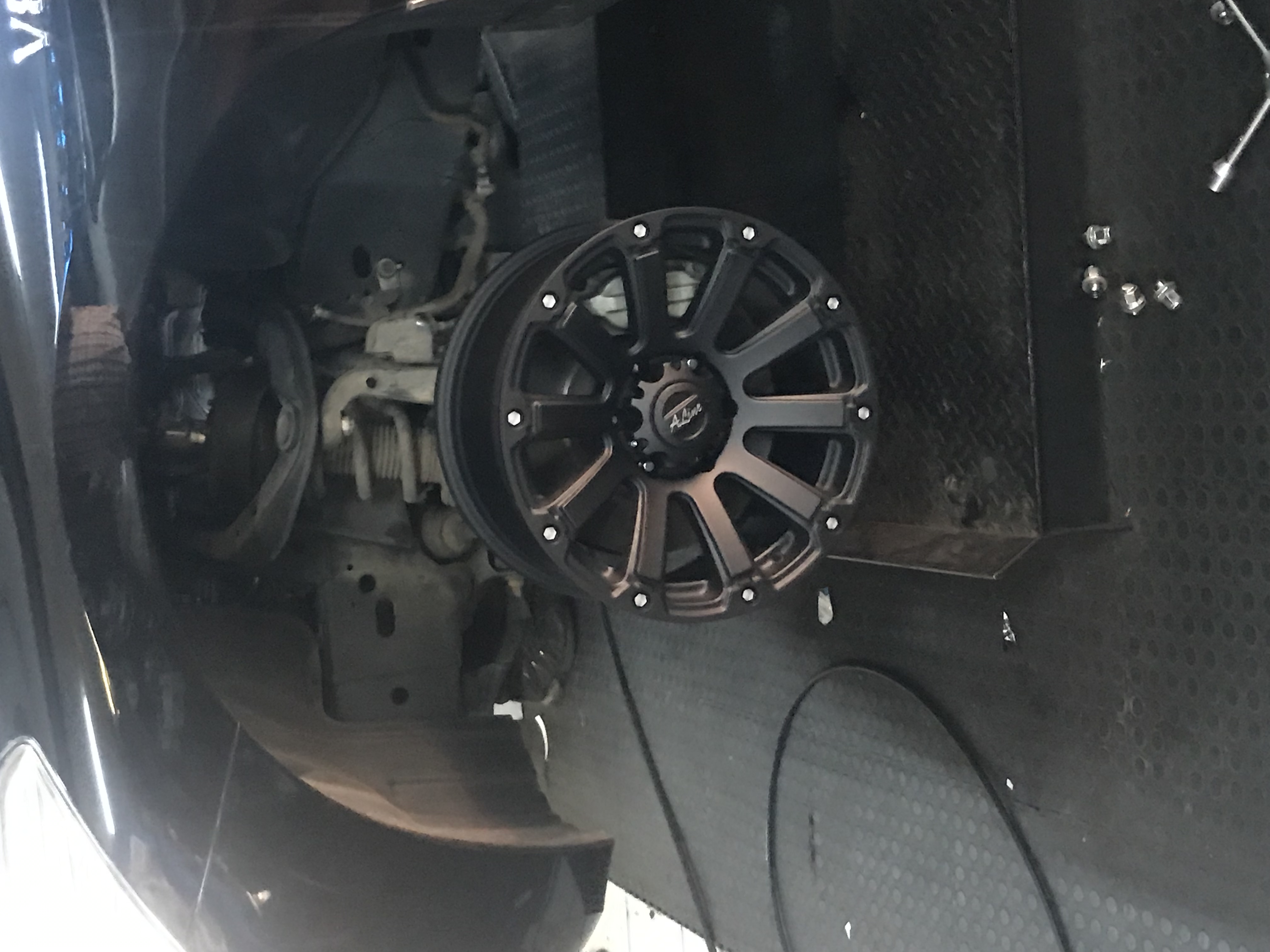

Today I did some research on rims and tires
the standard 18 rims are 8j with an offset of 35
according to the Australian sites i should be able to fit 305/70/18 with a 9j rim
This size tire is a rarity in south africa expecially in AT
I did find a set of Mickey Thompson and once mounted on the standard rim they touch the upper arm on full lock
i must say it is very slight
18” 9 j with an off set of 10 should do the trick but you cant test fit them with a tire
Any help and advice is welcome

The only downside is ground clearance (can't easily lift due to the hydraulic shocks) as well as the difficulty in fitting wider wheels and tires.
Please keep me posted on any success with your wheels-project.
