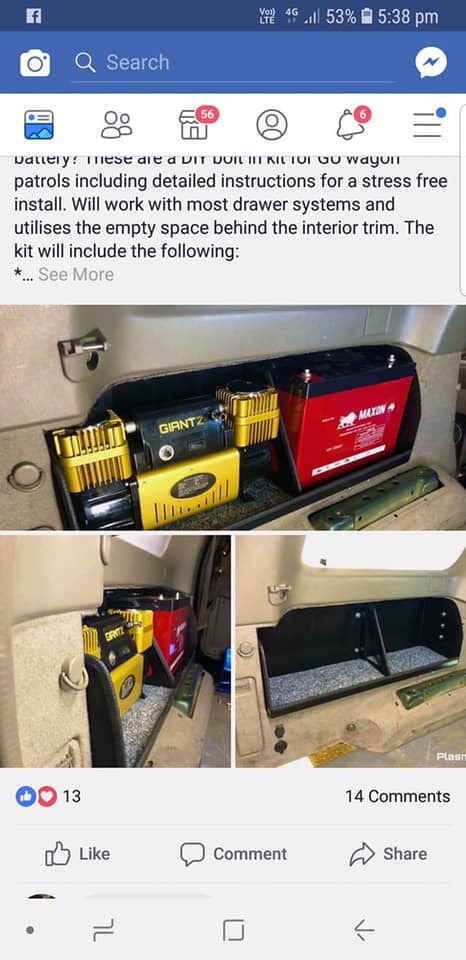

You could always try this

I have often wondered if anyone has removed the internal panels behind the back row of seats. There appears to be a fair amount of space behind those panels that could be utilised.If so - photos?

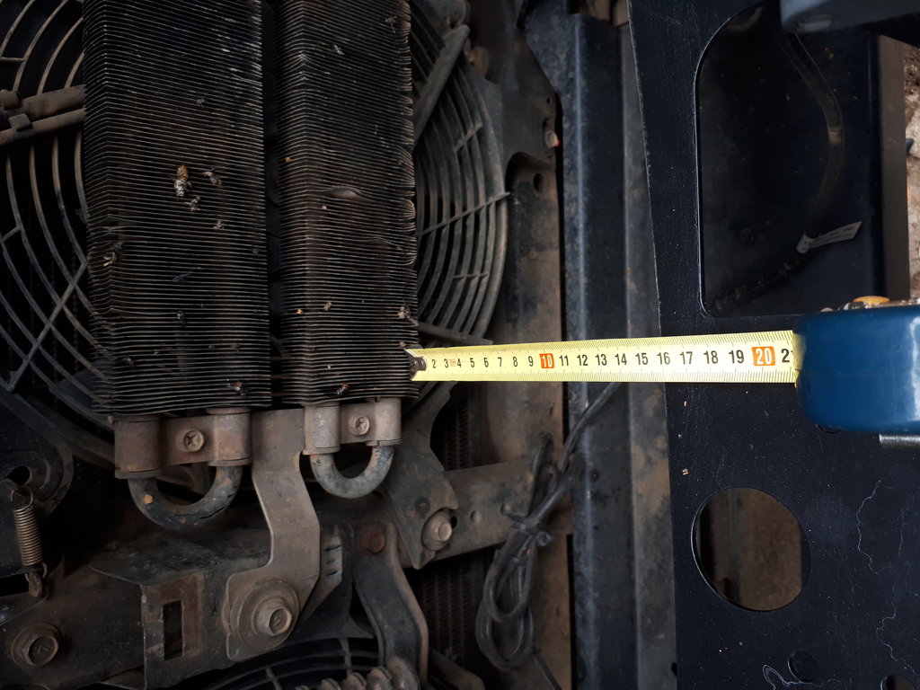

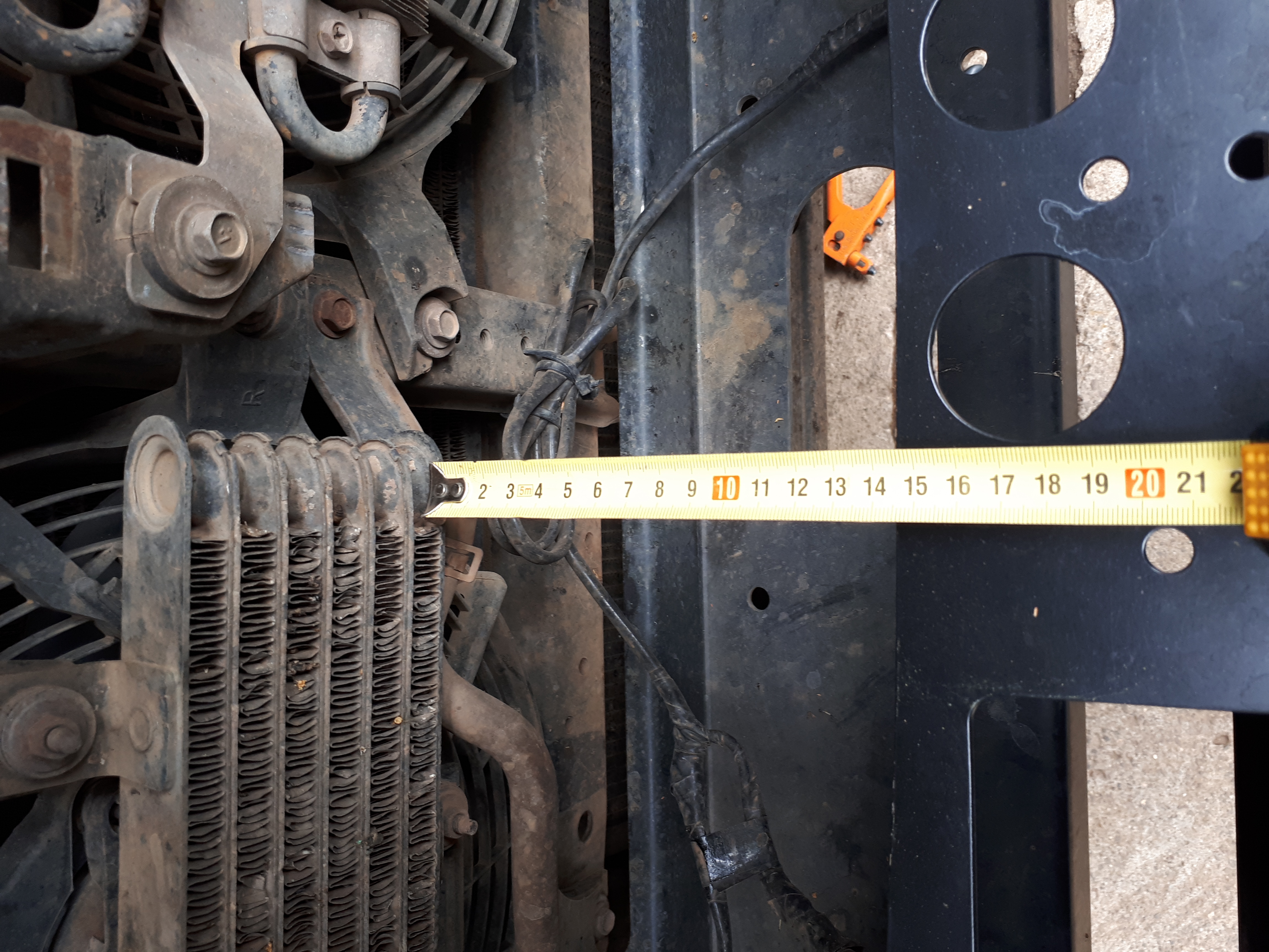

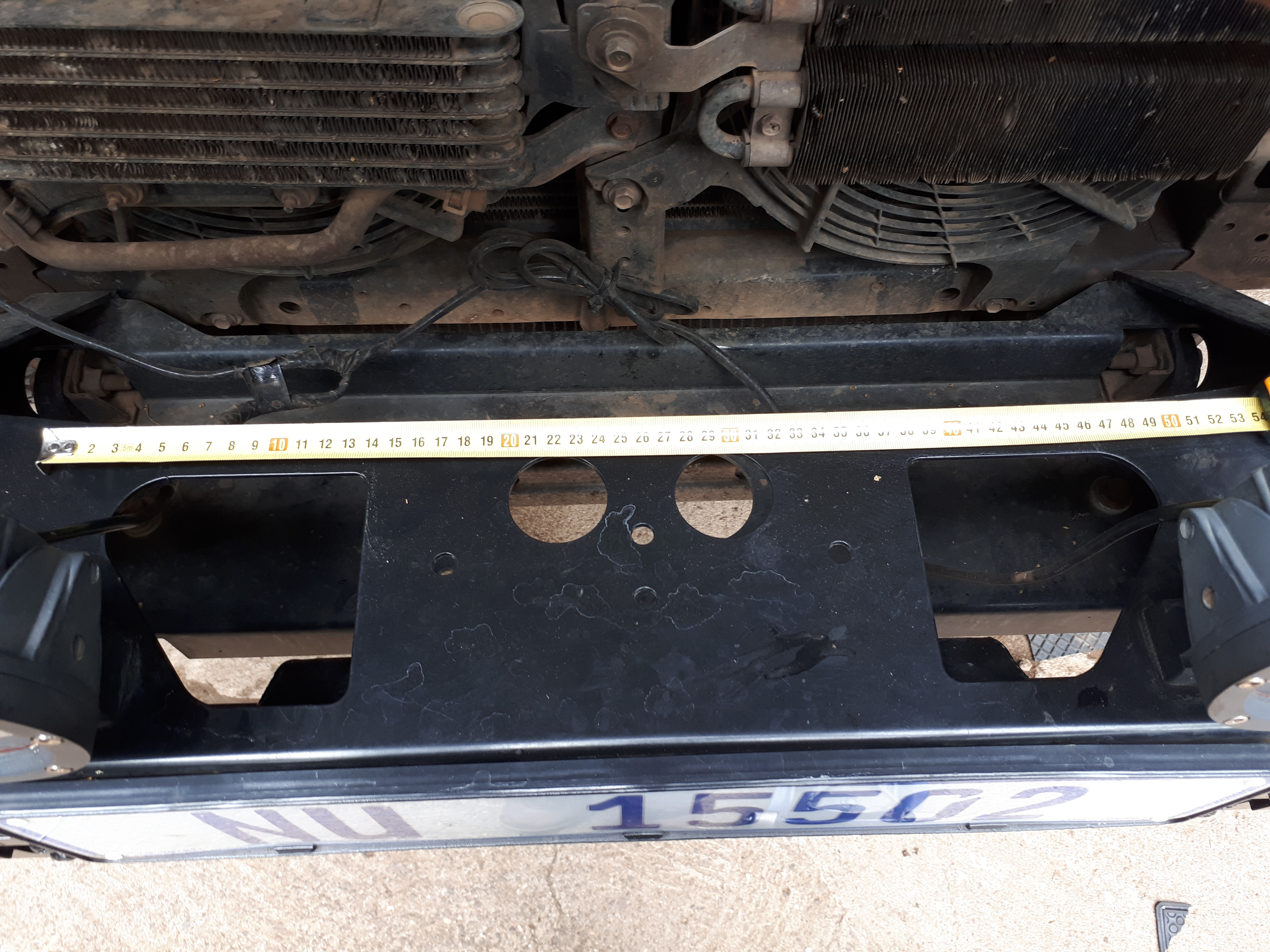

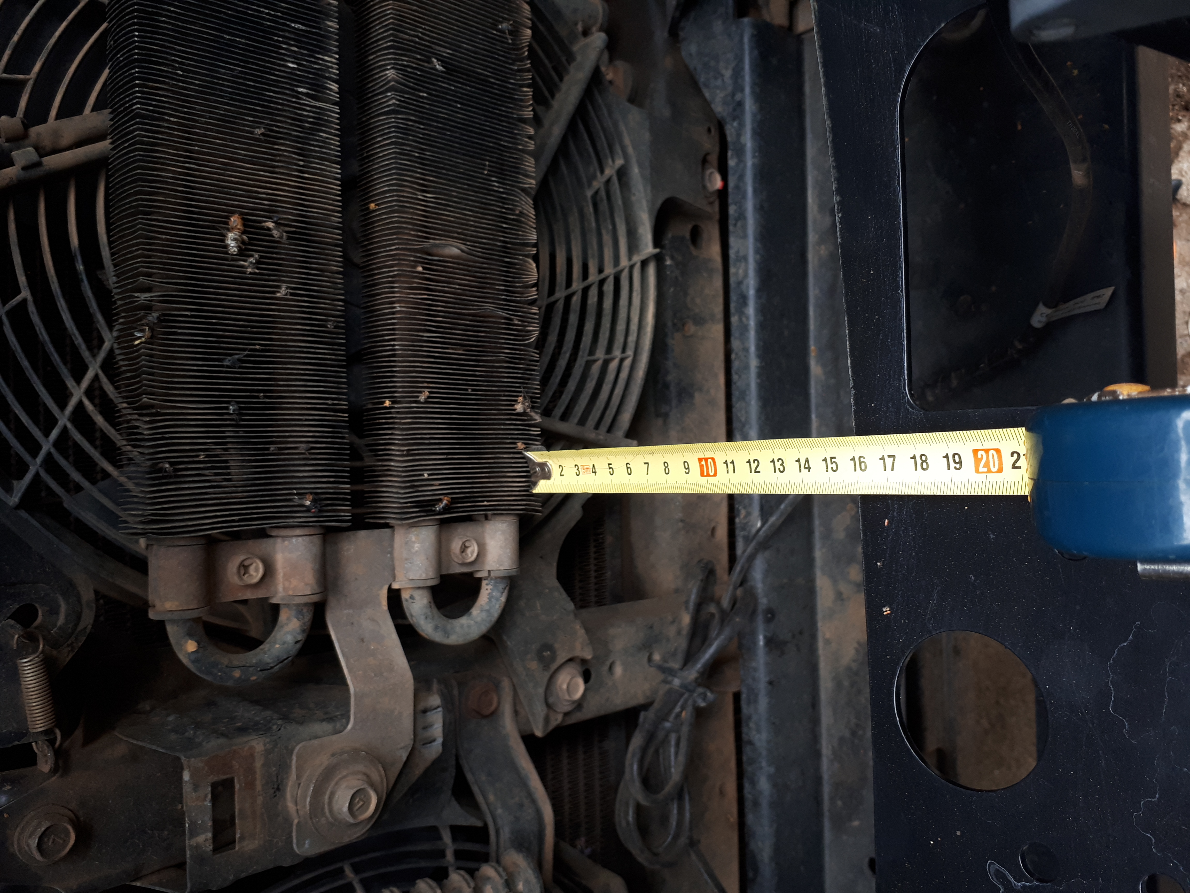

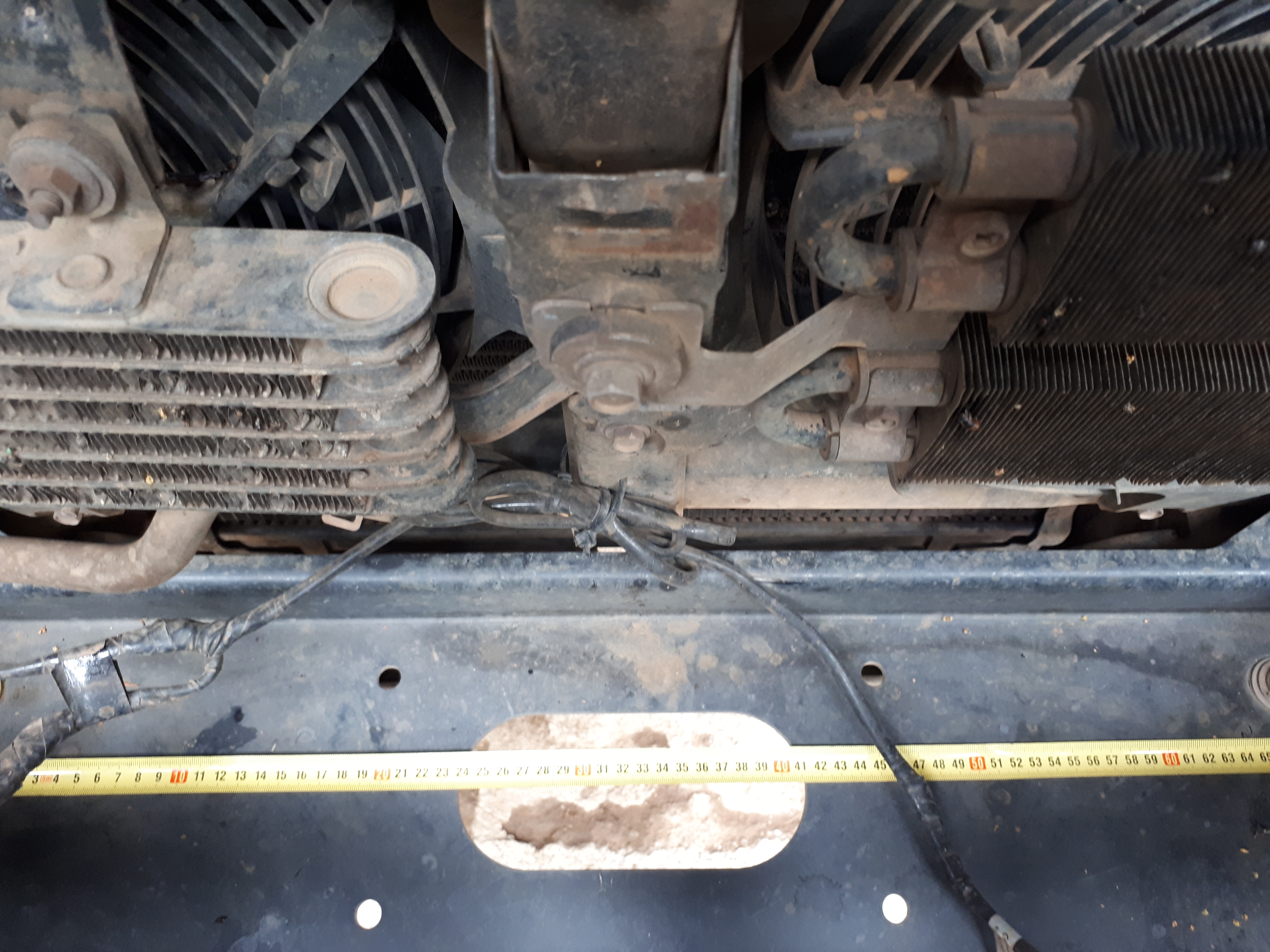

Ok so I decided to remove the front grill today to see how easy it would be.... :rolling: .... to be honest it is very simple but those 2 clips at the bottom had me on the verge of insanity ! Anyway I managed.
So here are some measurements with some bad photos also for your viewing pleasure:
The closest point of contact is the 2 small coolant "radiators" (correct me if I'm wrong), which I guess are for the aircon? That's
14.5cm for the one and 15.5cm for the other
The usable space in the winch tray is 20cmW x 64cmL x 24cm deep. The 20cm width can be 24cm but then the battery tray would overhang a little...
I measured my crank battery to compare and that is 17.5cm wide. So I guss it would be best to find about 5cm or maybe a bit more by altering the front bar so that you can put them in and take them out through the top.
I would be greatfull if someone could send me the measurements for some of thier second batteries. Like 100ah - 120ah size...

Rodney wrote: 13 Feb 2019 11:55 I have often wondered if anyone has removed the internal panels behind the back row of seats. There appears to be a fair amount of space behind those panels that could be utilised.If so - photos?
I think that in some models behind the left rear quarter panel there may be a second aircon unit for the rear which might get in the way ? But maybe behind the left one..

izakjbrt wrote: 13 Feb 2019 06:42 You could always try this
Hmmmmmm.....I like this idea..... I would need to modify my drawer system slightly though to get the battery in and out when needed

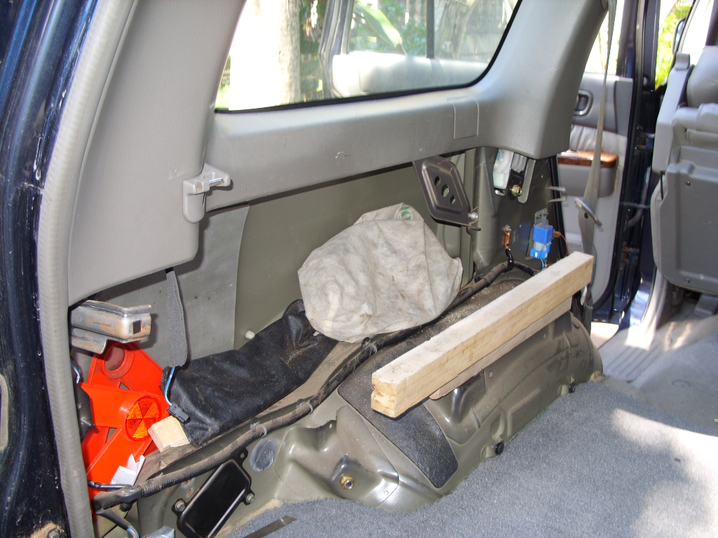

Hi Rodney.
Yes I removed both of the side panels when I traveled. In the passenger side, I stored 2x 5l oil, brake fluid gear oil and quite a lot of things. But its far too narrow for a battery. I hope I have added 2 pics
