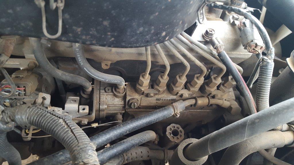

Good news Rudolph!!
The only problem with the inline pump and a turbo is that the inline pump's fuel is not controled by a lever like on the VE pump, but via vacuum behind the butterly on the intake.
Now if you add a turbo you will no longer have any vacuum there but boost so the pump can no longer give more fuel.
I am sure there is a way around it, but I have never worked on one of those

From what I've seen about the inline pumps is that the governor is vacuum driven, so advancing the fueling under boost is not possible.The only problem with the inline pump and a turbo is that the inline pump's fuel is not controled by a lever like on the VE pump, but via vacuum behind the butterly on the intake.
It is possible to convert the governor to a mechanical system using some parts from a Mercedes A606 injector pump, but it's pretty complicated and time consuming, so that means the cost of the conversion far out weighs purchasing a Bosch VE style rotary pump with an aneroid fitted.
That being said, some guys have found SD33T inline injector pumps which are the factory mechanically governed versions of the pumps found on the old GQ Patrol TD42's.
I'm pretty sure they're rarer than hens' teeth in SA, so rather just go the Zexel (Bosch VE style) rotary pump route, because spares are more common and likely cheaper than rebuilding the inline pumps.
Just for interest sake here's a some videos I found of the conversion of the inline pump, as well as a video of how the boost compensator (ALDA) would work on those pumps :

From what I could gather, is that the way around it, is that the pipe at the back of the pump still goes to the throttle body and the pipe closer to the pump need to be fitted post turbo so that it sees boost, original in NA setup this pipe is connected to the airbox. The inline pump is good only for low boost application, down under, which is good for your option to get out of donkey mode.Michael wrote:The only problem with the inline pump and a turbo is that the inline pump's fuel is not controled by a lever like on the VE pump, but via vacuum behind the butterly on the intake.
Other thing I have read on Patrol4x4.com, they claim the inline pump give better low rev performance where the VE pump gives better higher rev range performance.

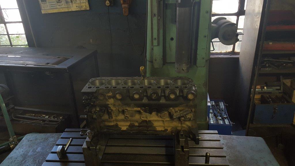

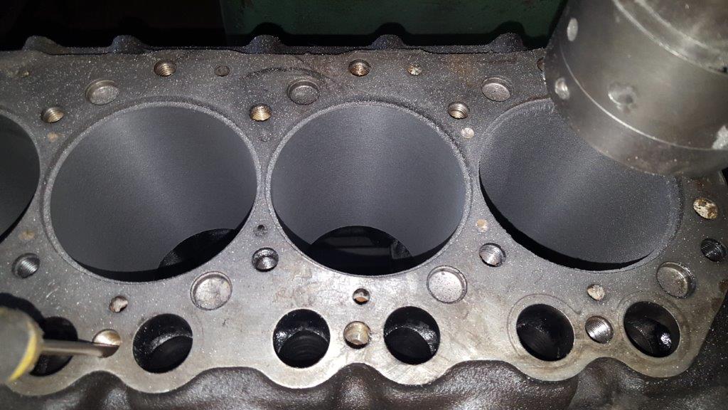

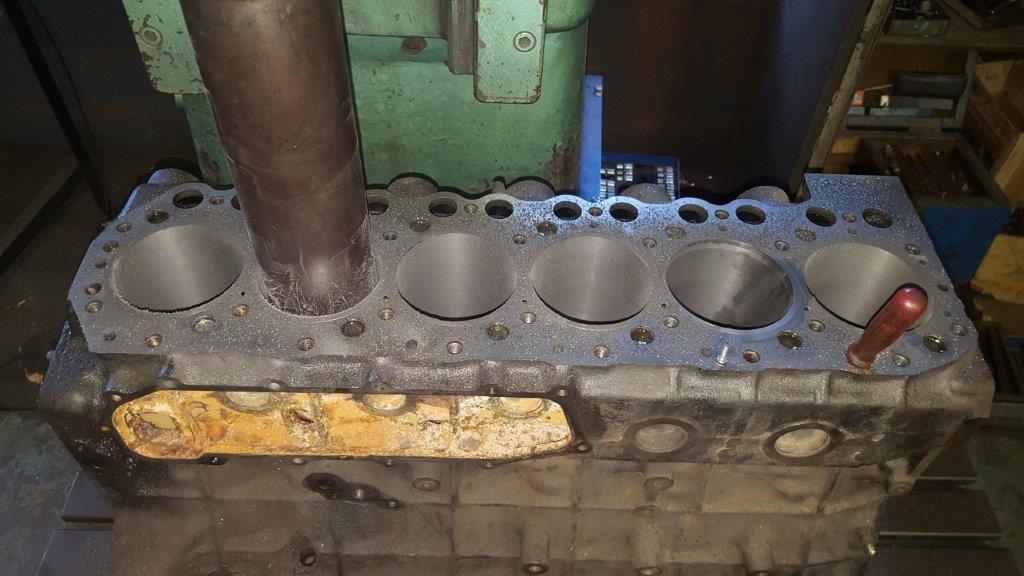

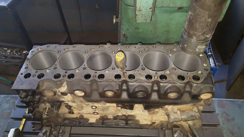

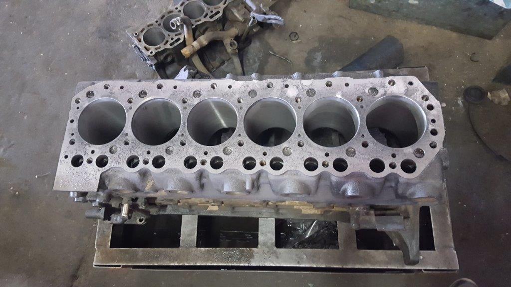

Re: TD42 Rebuild

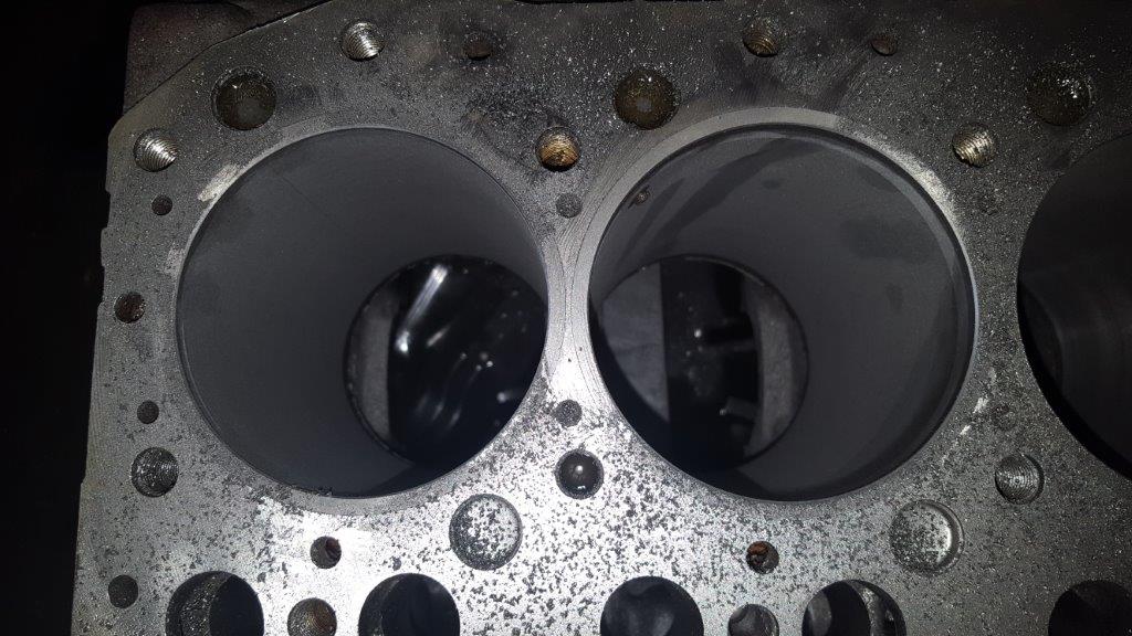

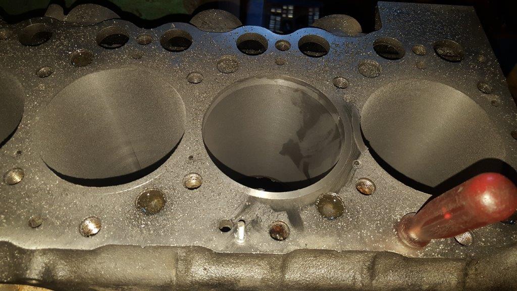

The Block is almost done busy with some final touches, the engineering shop left 2 thou to be honed then they finished.
Some pictures below, they bored the block and took away 0.5mm to fit the new sleeves. The sleeve ID was cut away 1.1mm to fit the new pistons.
- Block bored
- 20170830_110943.jpg (96.01 KiB) Viewed 5575 times
- Block bored
- 20170830_110957.jpg (68.15 KiB) Viewed 5575 times
- Block bored
- 20170830_111025.jpg (106.09 KiB) Viewed 5575 times
- Boring the sleeves
- 20170831_155447.jpg (98.84 KiB) Viewed 5575 times
- 20170831_155618.jpg (131.63 KiB) Viewed 5575 times
- Honing
- 20170901_114614.jpg (92.22 KiB) Viewed 5575 times
- Honing to be done
- 20170901_114629.jpg (112.96 KiB) Viewed 5575 times
