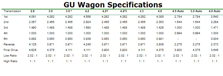

Thanks Bre. Can someone give me gear ratios 1st - 5th gears, and diff ratio as well. What size tyres are most people running. I am guessing 33'sBre wrote:The TX12A in the Patrol is also 2.02 David
What ratio would the guys be looking at for the new crawler gearing.

Re: low range gears
Ek sien die "reduction/low range gears" wat marks4wd verkoop is as volg:
24% - 2.484:1 Reduction
43% - 2.86:1 Reduction
85% - 3.743:1 Reduction
Ek neem aan dat indien die ratio te laag is sal mens 2de in plaas van 1ste gebruik, of 3de in plaas van 2de?
Patrol diff ratios:
GQ 2.8 Diesel = 4.625:1
GQ 3.0 Petrol = 4.11:1
GQ 4.2 Petrol auto = 3.9:1
GQ 4.2 Petrol manual = 4.11:1 or 3.9:1
GQ 4.2 Diesel = 4.11:1
GU 2.8 Diesel = 4.625:1
GU 3.0 Turbo diesel auto = 4.375:1
GU 3.0 Turbo diesel manual= 4.11:1
GU 4.2 Diesel = 4.11:1
GU 4.2 Turbo diesel (wagon) = 3.9:1
GU 4.2 Turbo diesel (ute) = 4.11:1
GU 4.5 Petrol = 4.11:1
GU 4.8 Petrol manual = 4.375:1
GU 4.8 Petrol auto = 3.54:1
Patrol transmission/gear ratios:
Patrol diff ratios:
