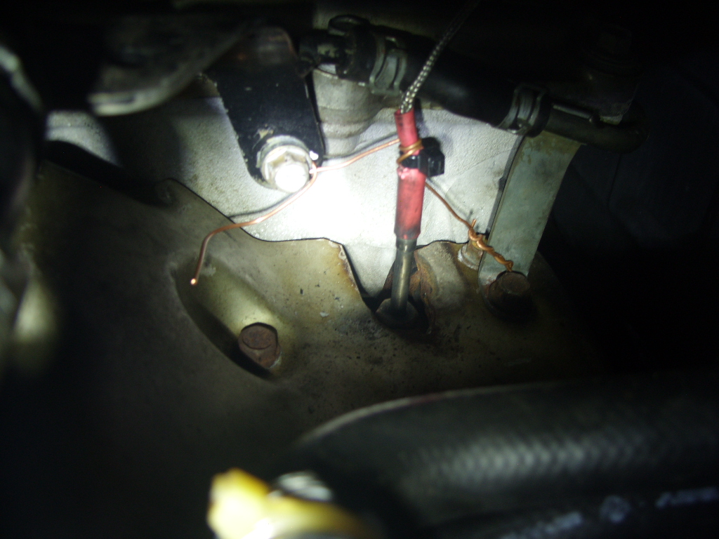

First of all, thank you very much for all the input you guys have given me. Sure enough, the probe had come out and although I could not get a spanner on the ferrule due to the cut out being too small, I managed to coax it back with Davids tip. I then did a Heath Robinson on it, see att, secured with some copper wire as a temporary fix until I can get it to Durban. I took it for a hard drive and the EGT are now back to normal. On returning, I checked if the probe had remained in situ and I know its too early, but it did not move. It now protrudes 3.5 cm rather than the previous 6.5
Thanks again one and all
Have Troll, will travel.

Glad all is well again.
I like the McGuyver move on the probe :lol:

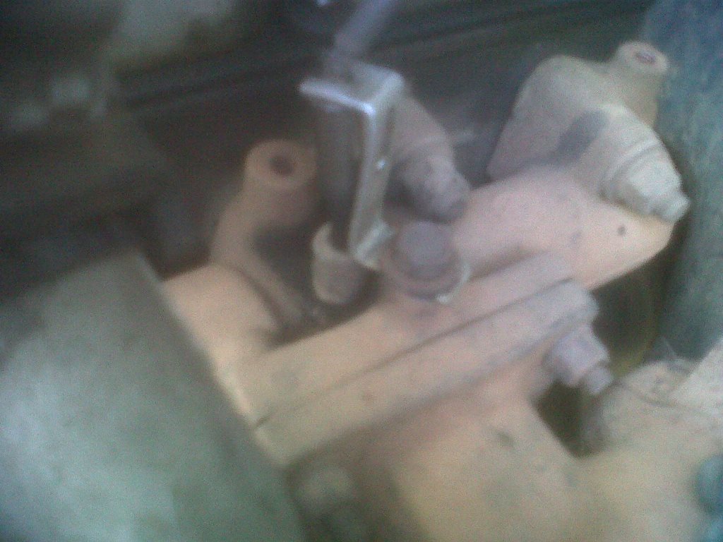

HEHE :rolling: , and I thought my fix was wild.... I'll go take a pic of what I did with mine and post it tomorrow.
I see you have the same problem with the location. Proximity to those "nobbles" and castings can mess you around in a big way with a spanner. And because of the cable, you can only get to it with a flat/open end. So in no time you end with with round nut. Then you take to it with vicegrip...OK, I did anyways :doh: ... Now I can't even tighten my nut anymore and the probe wobbles around and I have a "briekstreep" where the gas is leaking past the probe/nut and manifold.

Here is what I did..
