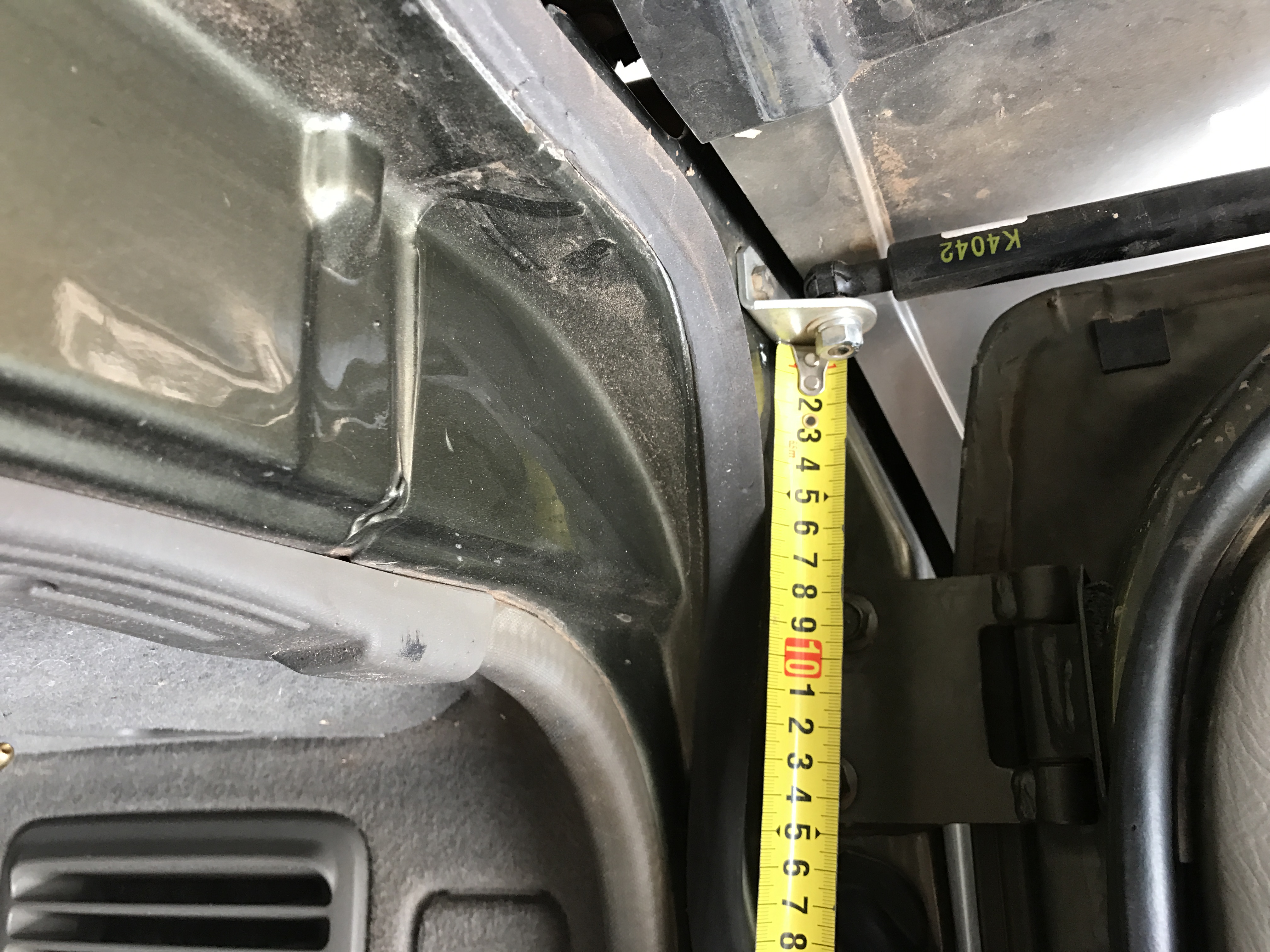

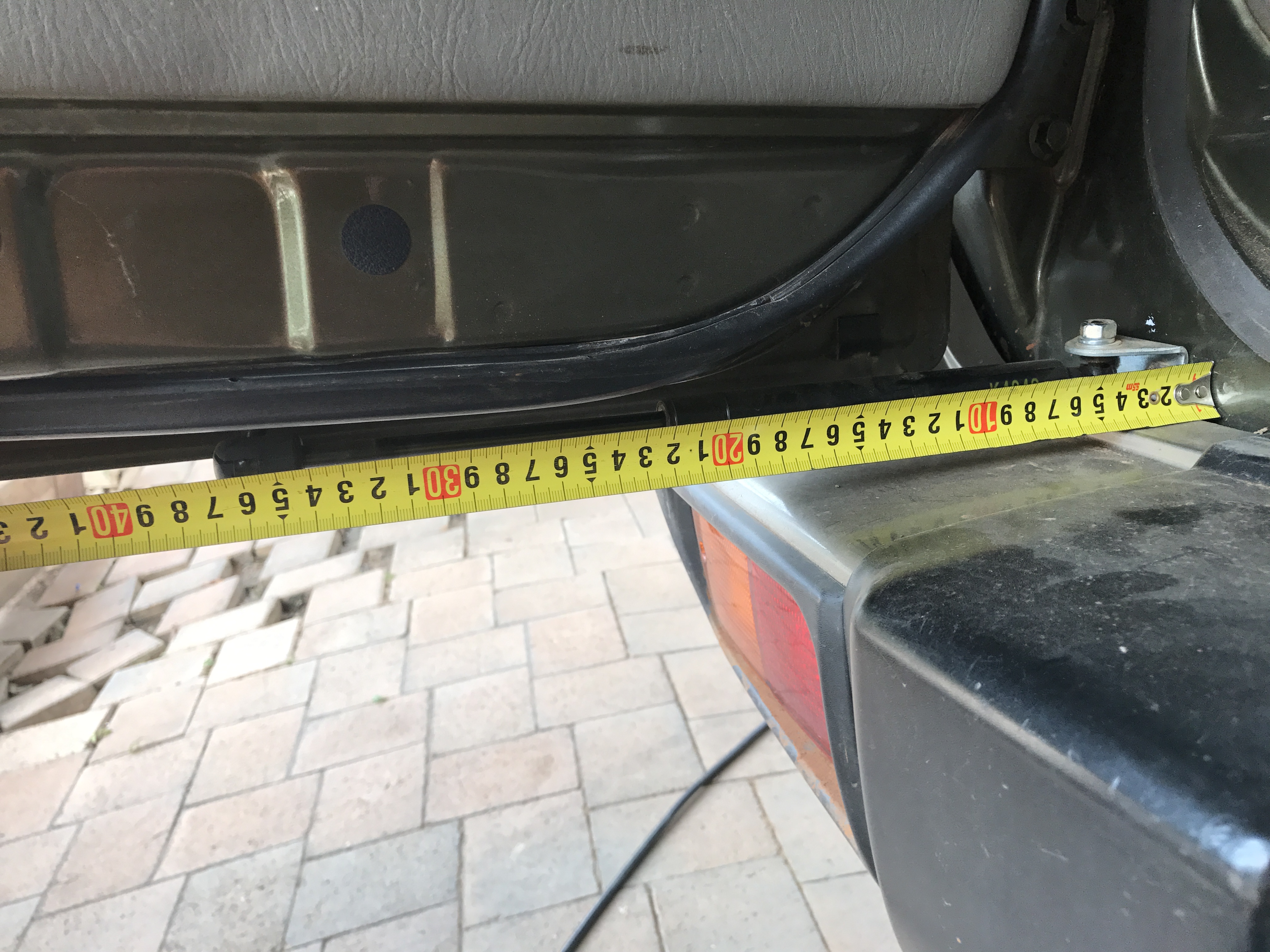

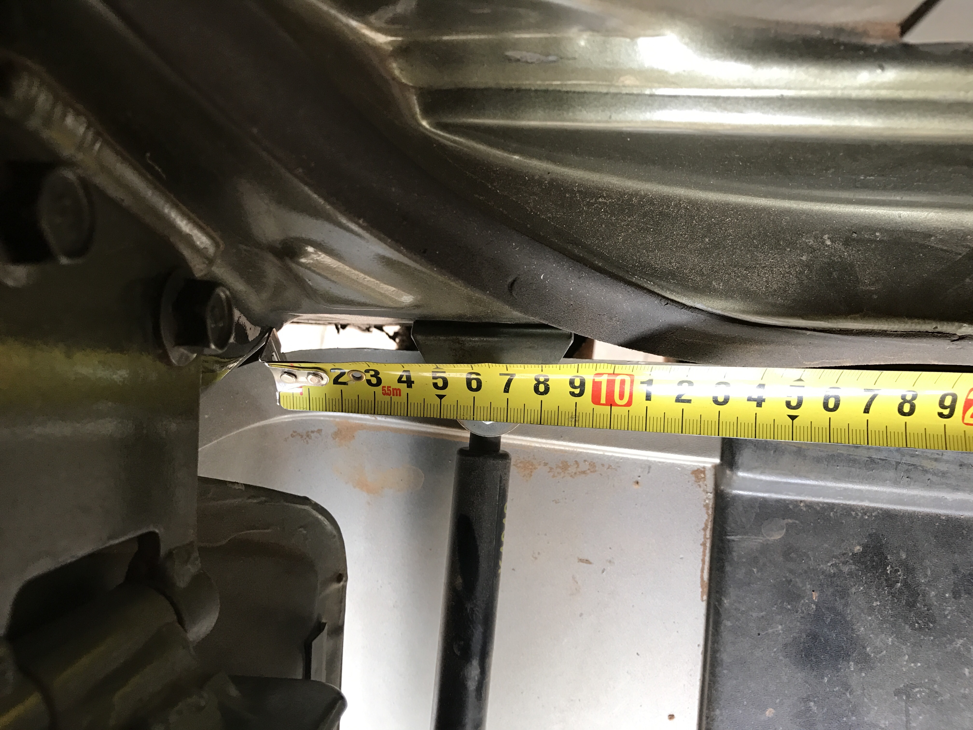

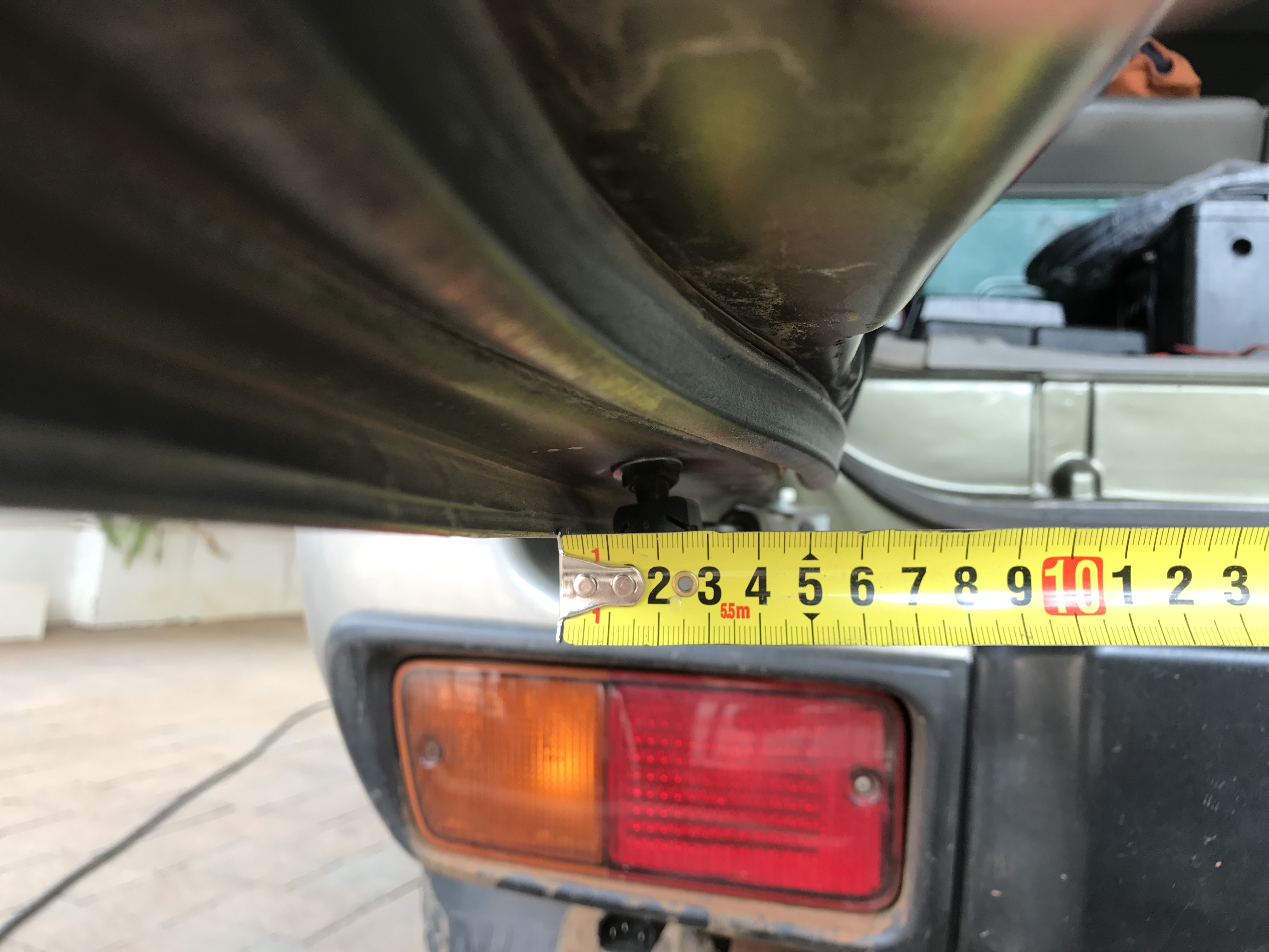

hugejp wrote:Loving the rear barn door gas strut!
Any chance of a list of parts for the job & size/NM of the strut?
Maybe some measurements too please?
:pray:
It is a 350mm strut 500Nm, I have to admit that it is a bit to heavy so I woud say you can about half that, when I get a chance I will have it deflated. This was the only one they had in stock, works great.
Parts:
1/350mm strut
1/rear joint
1/front joint
2/straight ball joint
1/90 degree bend
2/M8 nuts
4/M8 washers
2/M8 spring washers or teflon nuts
2/M6 bolts ~20mm-30mm long
2/M6 nuts
4/M6 wahers
2/M6 spring washers or teflon nuts
Tools
13mm spanner and socket
10mm spanner and socket
6mm drill
8mm drill
Punch
Tips
Be careful unclipping the door interior pannel, the clips tend to break.
Loosen the door catch, pull the door open a bit more then mark the hole on the door bottom so when you retighten the catch the door will always be under tention without play.
Do not worry to much about the measurements I guessed it based on a patrol4x4.com picture of a 290mm strut. So the idea is quite flexible on available parts.
