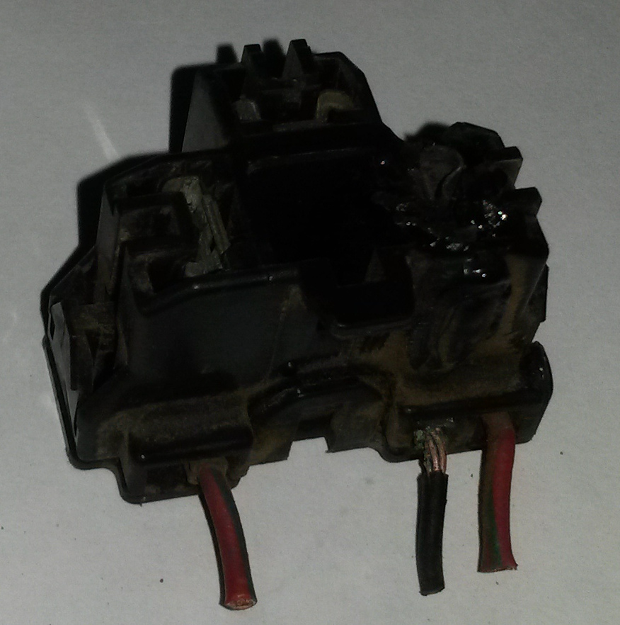

I came across this thread a while ago, and sort of put it in the back of my mind. Amazing - because it came in handy yesterday.
I drove back from Pretoria with lights on (it was raining most of the way). When I left, both lights were working, but when I got to Brits I gathered only one was working. Drove home, popped the bonnet and gathered that my left-hand-side headlight plug has toasted nice and crispy...
I can only assume that the plug did not seat properly when I replaced my headlight lens over the weekend. I will be replacing the plugs (I'll do both sides, just in case) during the course of the day.

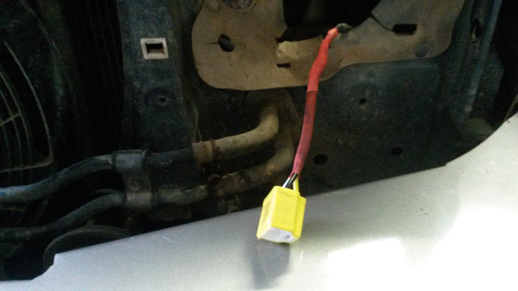

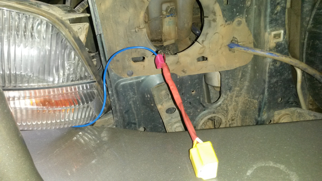

Replaced the stuff last night.
As Stefan pointed out, space is tight. However, I've become the past-master of stripping off the front grill and lights. So I decided to work from the front.
This is what the connector looked like. It's a poor photograph, but one can see how the connector has melted.
I bought two new connectors from Midas for the princely sum of R15 each... Left hand side connected.
And right-hand side connected. The blue cable is just the tap I have from the brights for my spotlight relay. I removed the cladding to get the thing out nicely, and have not replaced the cladding and put it back.
