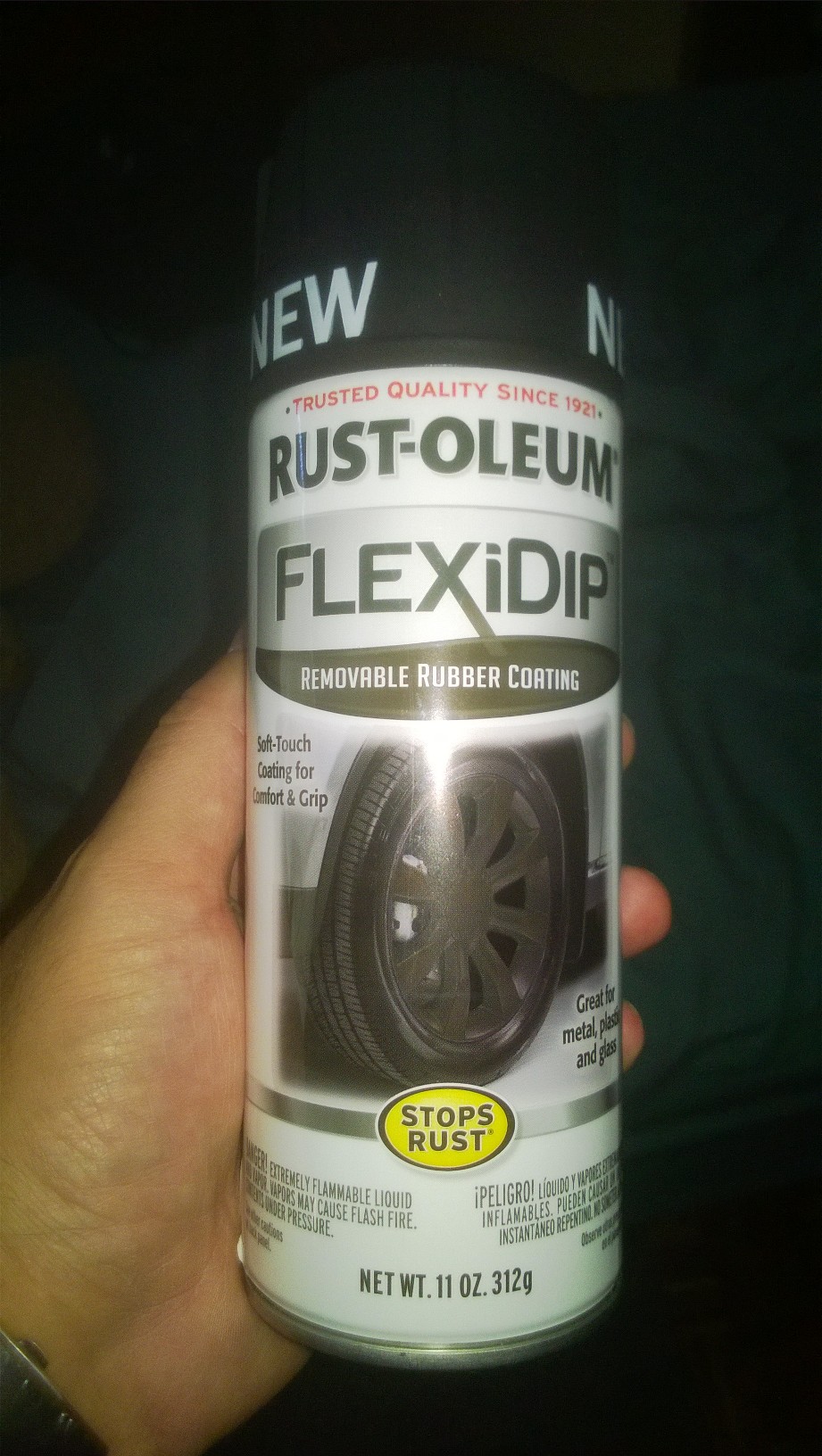

Got this on Monday. So got my Saturday project. Will post the before and after. Got it from Builders in their paint section. :thumbup:

What's a can cost ?

I have tried both - I like the finish on the rust-oleum better.
Its also cheaper. R145 i think, at Builders

I payed R140 per can.
Just remember this is not permanent. 2-3 years. It becomes harder to remove the longer it is on. 2K will be a permanent option. Will go 2K maybe next time. I know there is also a can spray paint in America that can be a permanent option for the oukes without spray equipment like me. Can not remember the name, but it is also not available in SA.

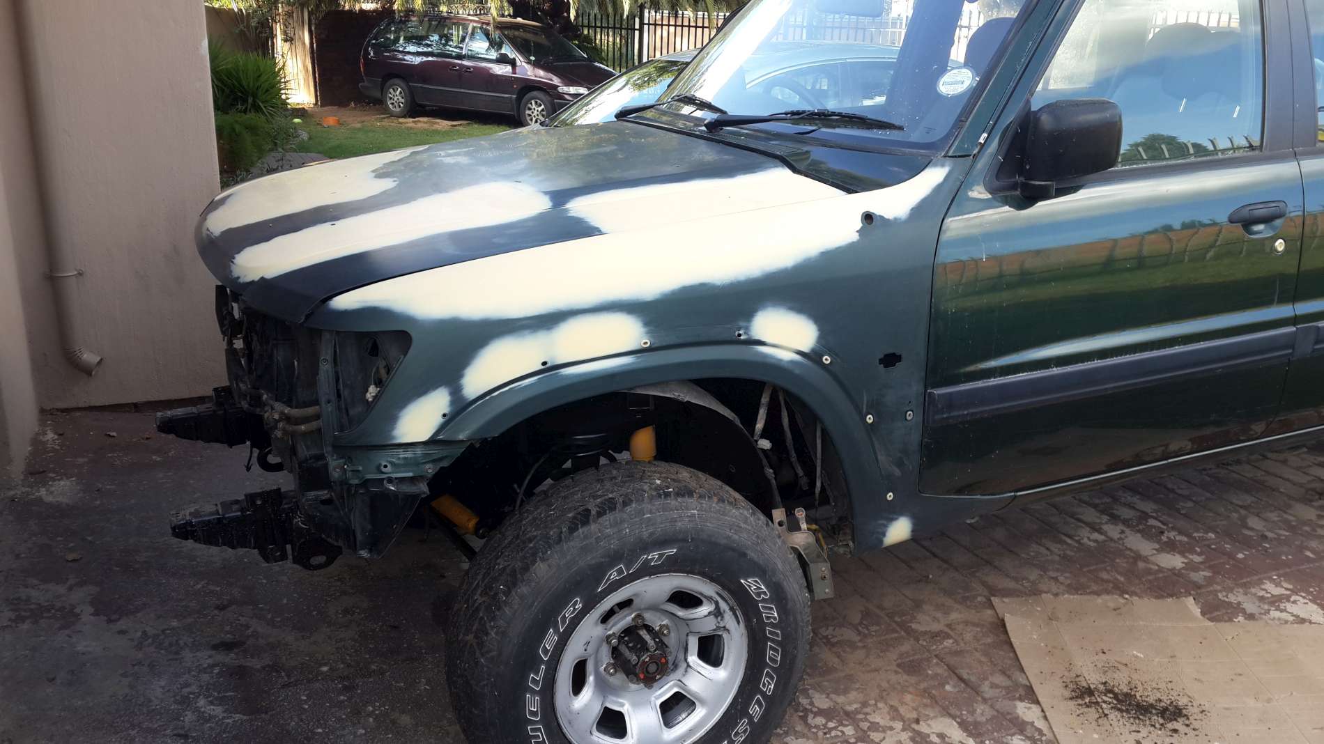

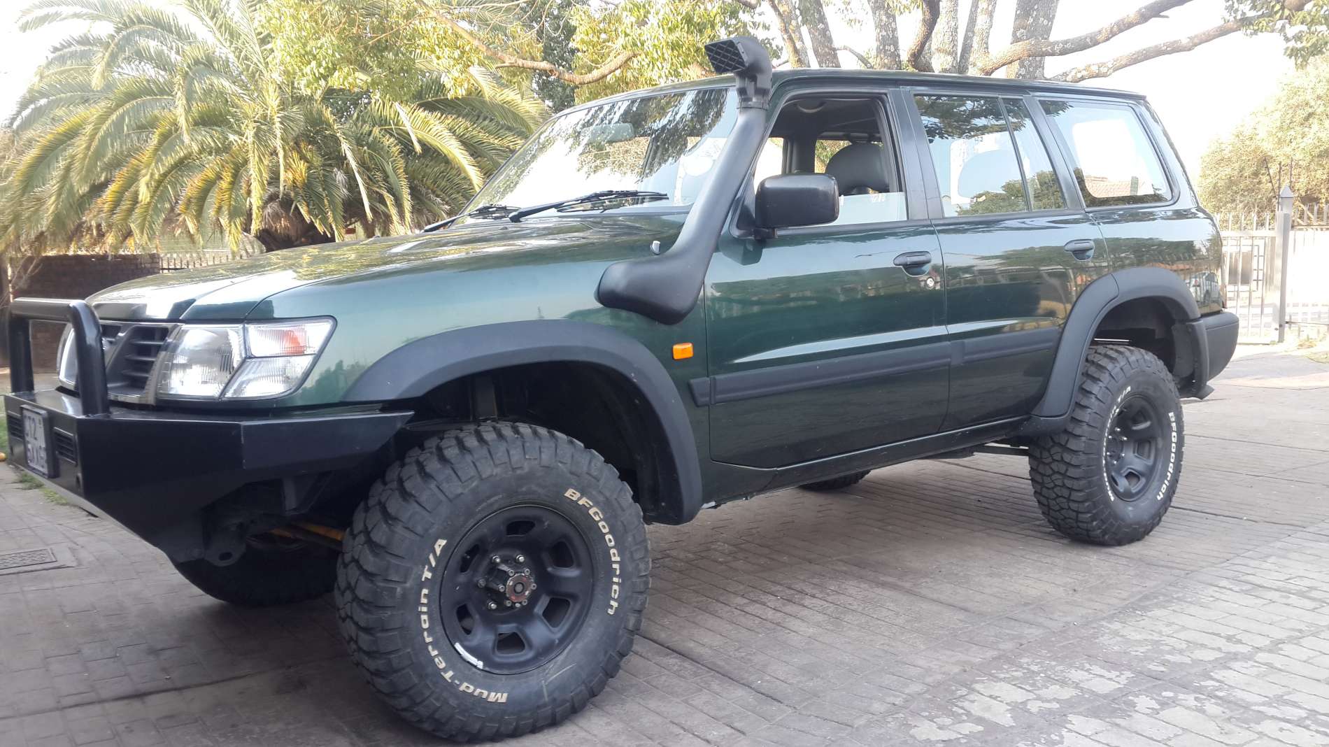

I have done my wheels with 2k and still looks brsnd new after almost a year. been through mud several times and high pressure hose them with no problem.
Here are some before and afters, cost me less than R150 for all 5 wheels...... and some sanding
before
before
after
after
