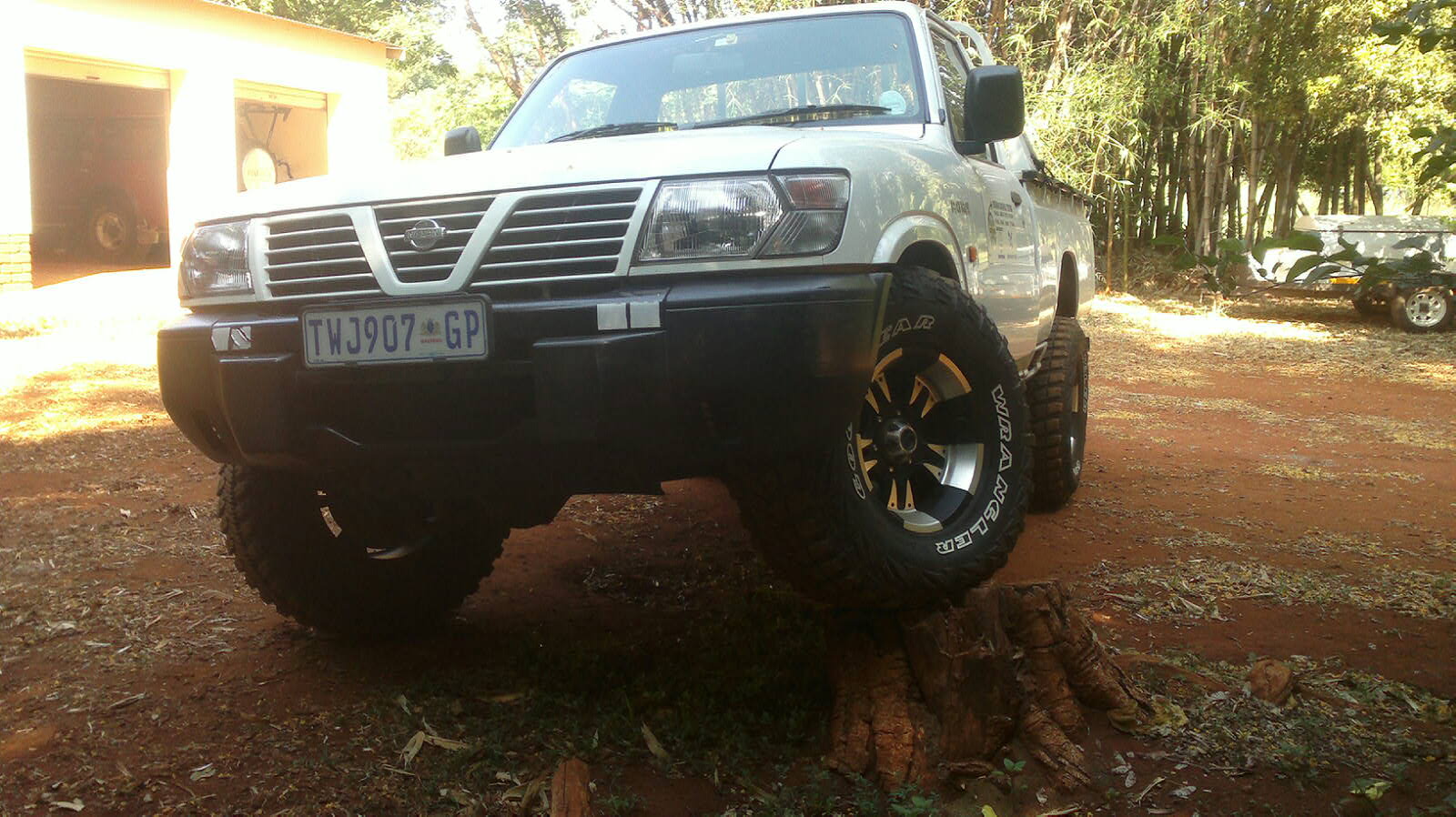

Alex my dad had around 10 km with the car. I see no replies on the tyre pressure.

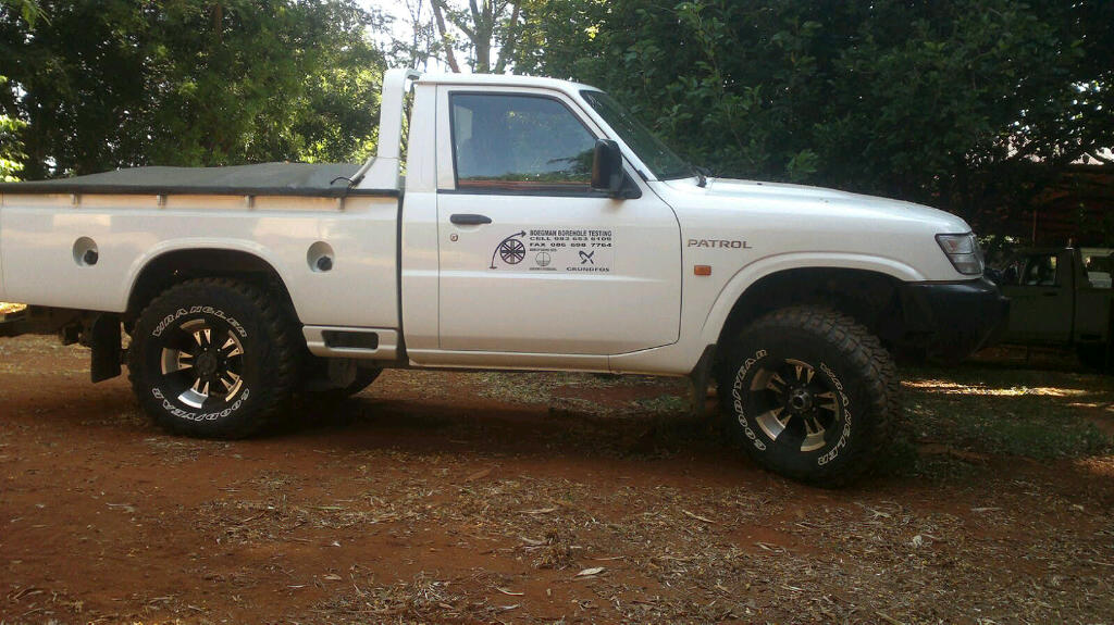

Roy i spoke to mr boegman that has 2 of these his reply was get bigger (33) takkies or invest in a kidney belt :rolling:
the has 305 70 16 on his and runs them at between 1.8 and 3 bar depends on load the said that 285 75 16 witch is also a 33 will work better
the tires that you got on now is 32 if it is the 235 80 16?
when you put the camper on the back you are gonna have the tekkies at like 3 bar and then its not going to be nice .......same story applies more rubber more grip wider footprint in sand grips better on rocks ect.

these are lekke!!!!
dis hoe friendly patrols moet lyk
mr boegman.jpg (220.14 KiB) Viewed 1778 times

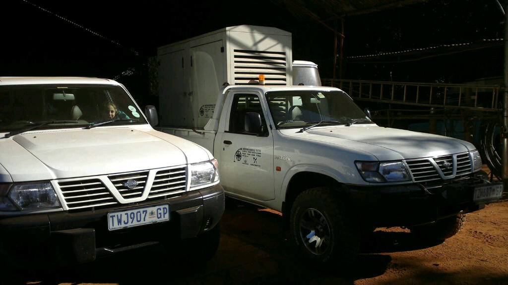

this is patrol 4.2 na with a 80kva volvo gen in canopy with diesel in the tank >>>>
took it to the weigh brige 700kg over so it was 1.7 ton :surprised: :surprised: :surprised:
the patrols suspension is stock and can you guys see how low the back is hanging :rolling: :rolling: :rolling:
the gen has traveled many miles on the back of that pickup......

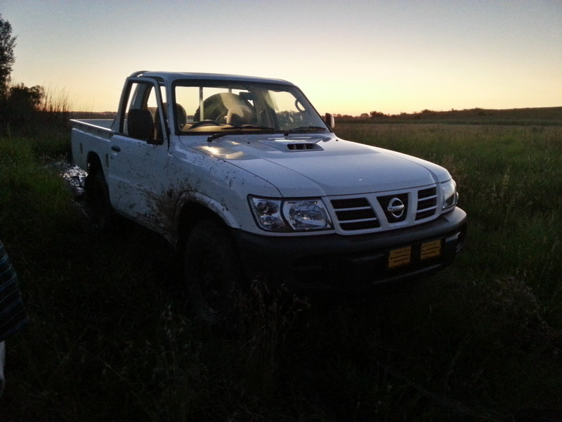

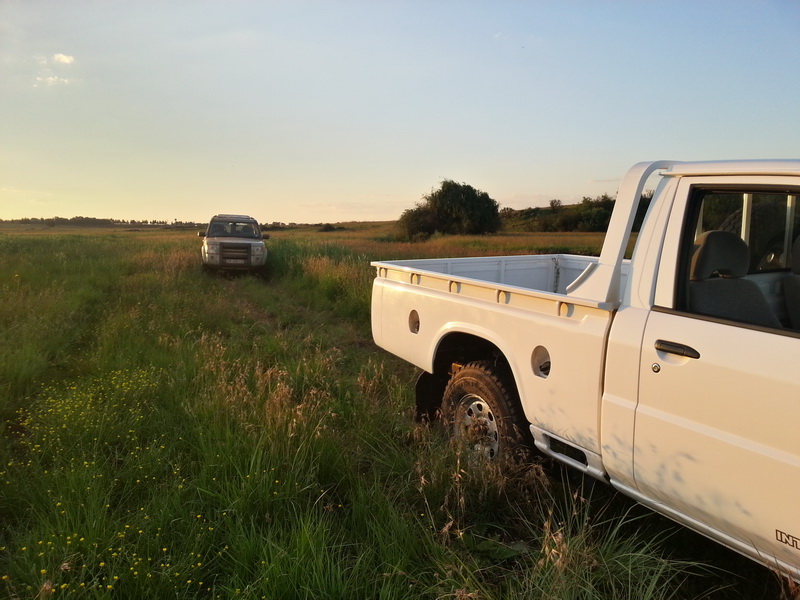

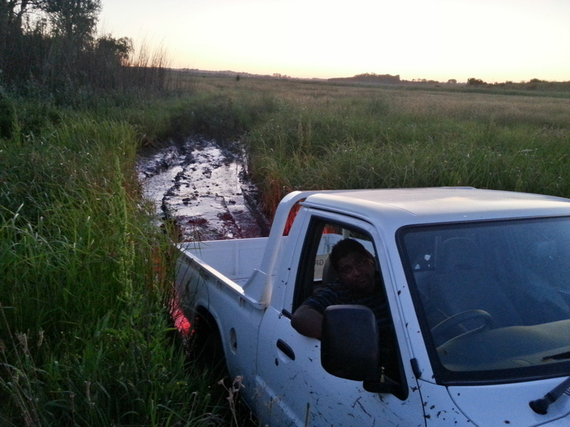

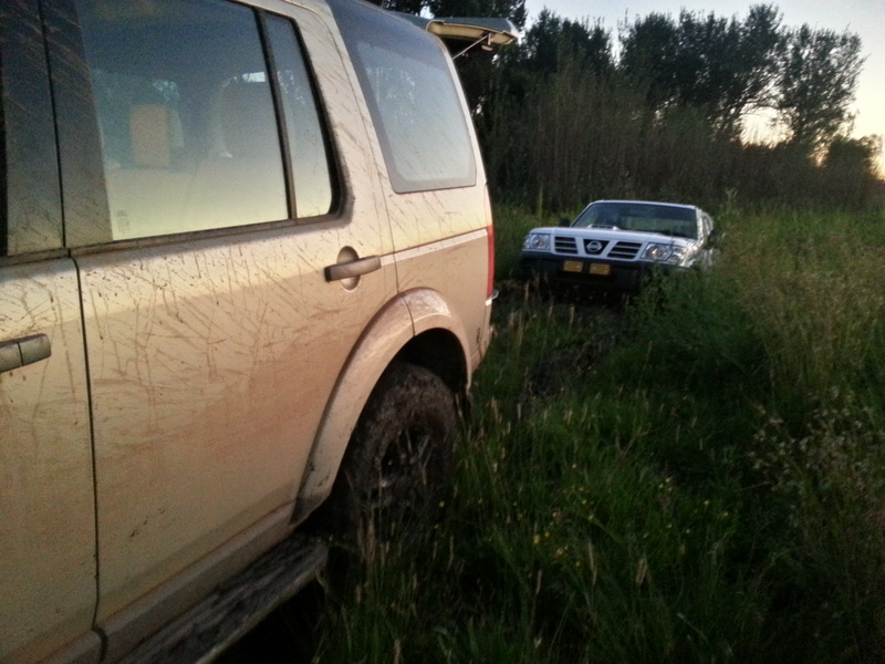

Here's some pics from today doing some mild testing with the Disco as backup

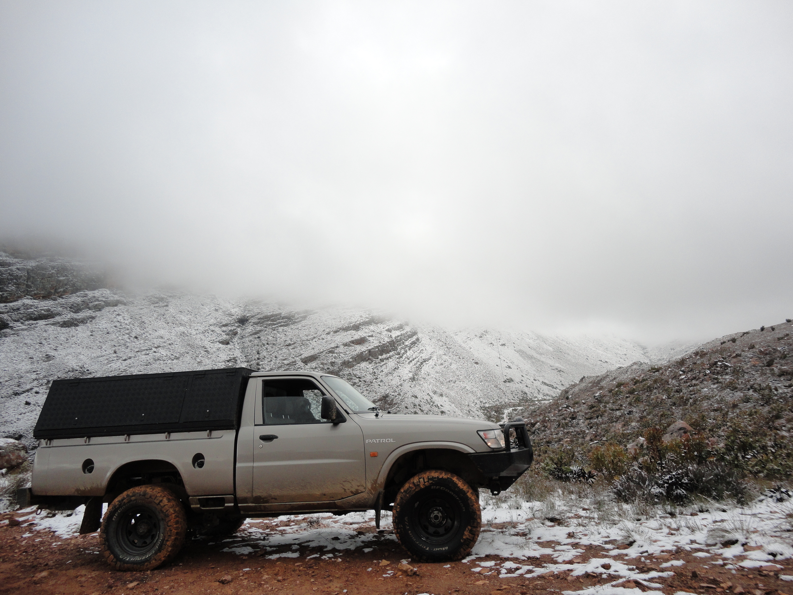

dieselfan
Posts: 314
Joined: 27 Feb 2010 23:39
Full Name: Roy Markham
Nickname: Roy
Current 4x4: Patrol 4.8
Been thanked: 2 times
Re: Proud Patrol owner...kinda
Post by dieselfan »
Sweet ride Russ! If I didn't have kids...
Having compared to the two quite a bit recently though I want to add
- Width is noticeable as we've been able to widen the canopy vs the cruiser specs +- 150mm
- Length of bin shorter by +-100mm
If it means anything...
The size of the pumpkin vs the two is day and night. The LC's front is small, the Patrols front is bigger than any double cabs rear - that I've seen. We conclude it as follows, if the LC is so great than the Patrol should be better. I know I'm not a mechanical engineer I'm basing this on looks. Either way the 4.2 has reignited my love of diesels.
On the trail the 4.2 Patrol is quieter than the D3! Every now and then the viscous fan on the D3 comes on, the Patrol tjoep still.
I drove around 300km the other day and popped the motor when I got home with my dad, barely any heat radiating from it. Open the D3...these older large cc engines barely work.
