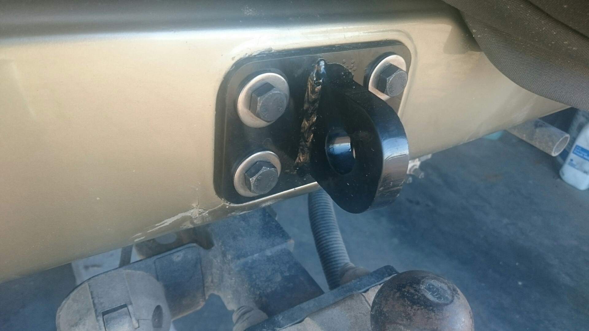

Nou lyk hy so...
Recovery loop.JPG (552.77 KiB) Viewed 19374 times
Thanks Tinus :thumbup:

jonathan wrote:Nou lyk hy so...
Dit lyk goed. Kan nie wag om my bumper bou klaar te he sodat ek myne ook kan opsit. Tegnies kan ek hom nou opsit. Maar hy moet nog geverf word ens. :)
stuur bietjie fotos van jou eind produk
Re: recovery hook
Wilkie wrote: stuur bietjie fotos van jou eind produk
Ek maak so. Daar is n ander thread daaroor, maar op hierdie stadium is dit nog work in progresss.... Het mooi gevorder vandag totdat my grinder se "sleutel" breek toe ek disks ruil. Maar sal tot more moet wag. Nêrens in Brits gaan ek nuwe sleutel nou kry nie.... :redface: :redface:

Turbonator, a few questions:
Will the hook you have bolt onto the factory hook location?
If so, then if its secured with 10.9 bolts will it handle a snatch recovery?
If yes to both, then I'd like one please.
Re: recovery hook
Yes it fits same place yes it can handle snatch recovery no you must use 8.8 bolts more harder bolts might be to brittle :mytwocents:
I will arrange more tomorrow :thumbup:
How many more guys want?

Tinus lotz wrote:Yes it fits same place yes it can handle snatch recovery no you must use 8.8 bolts more harder bolts might be to brittle :mytwocents:

Nissan told me that the standard one of the Patrol can take 10 tons for recovery!! :thumbup: :thumbup:

Herrie wrote:Nissan told me that the standard one of the Patrol can take 10 tons for recovery!! :thumbup: :thumbup:
Is 10t strong enough for snatching a 3t vehicle?
How much energy does a snatch strap generate in relation to weight of vehicle being recovered?
