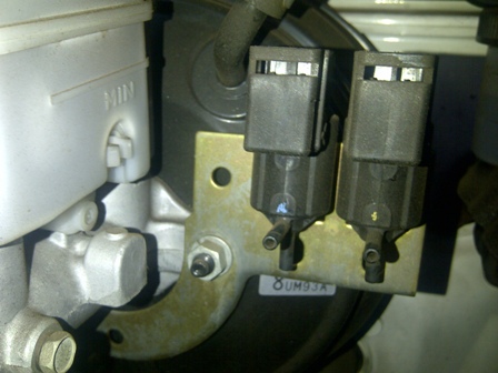

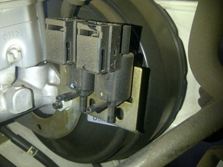

If I have problems with the solenoids again, I am going to try these.
I don't know if they will work or what they cost but I am going to try them should I need solenoids in the future.
These solenoids are in a 2007 Ford Ranger 2500TD 4x2.
They are used in the 4x4 Ranger for the front wheels.
Solenoids (2).jpg (62.92 KiB) Viewed 2110 times
Solenoids (1).jpg (67.94 KiB) Viewed 2110 times
