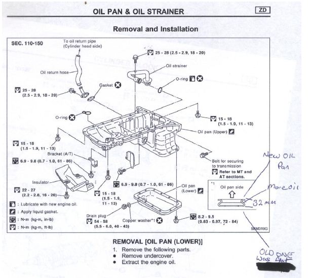

Re: Patrol 3.0TD, is it really THAT bad?
Seems Nissan started upgrading to the bigger sump in the patrol in 2000 already according to Auzi guys anyway, bit a common problem apparently is using the old style sump that can sometimes be found on other ZD30 variants , look at the pic the old bottom sump was flat and the new one is 32mm deep , geuss who will be underneath his troll tonight measuring
- new oil pan.JPG (65.8 KiB) Viewed 2598 times
