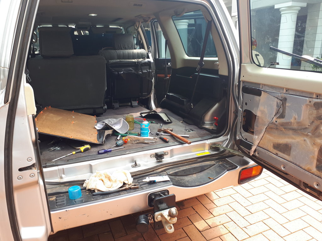

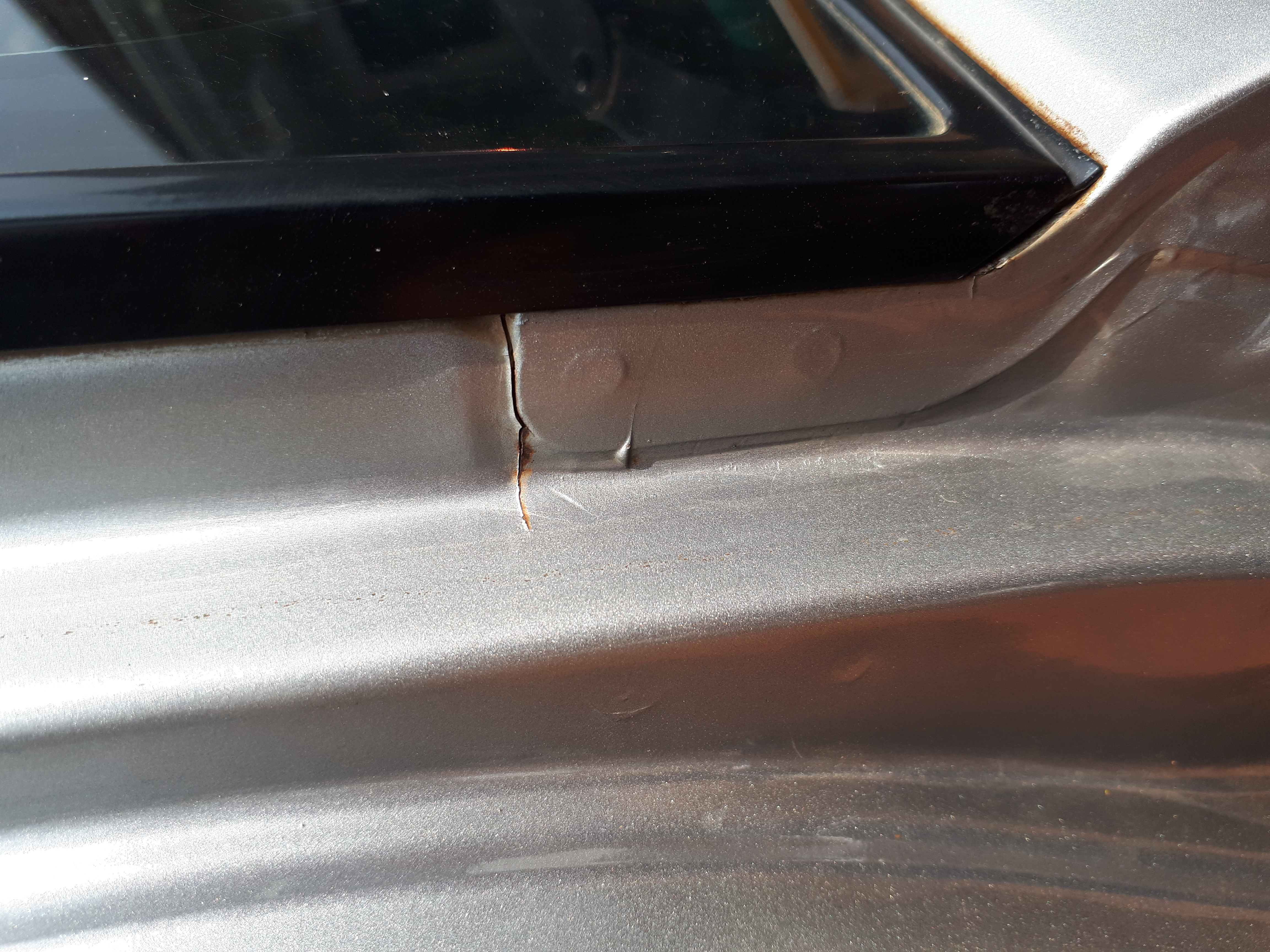

:thumbdown: :helpsign: :thumbdown:
Moving the spare to the roof for now. Hope I dont get a flat because I might bust my back :lol: time to ask SWAMBO for that rear replacement bumper Haha

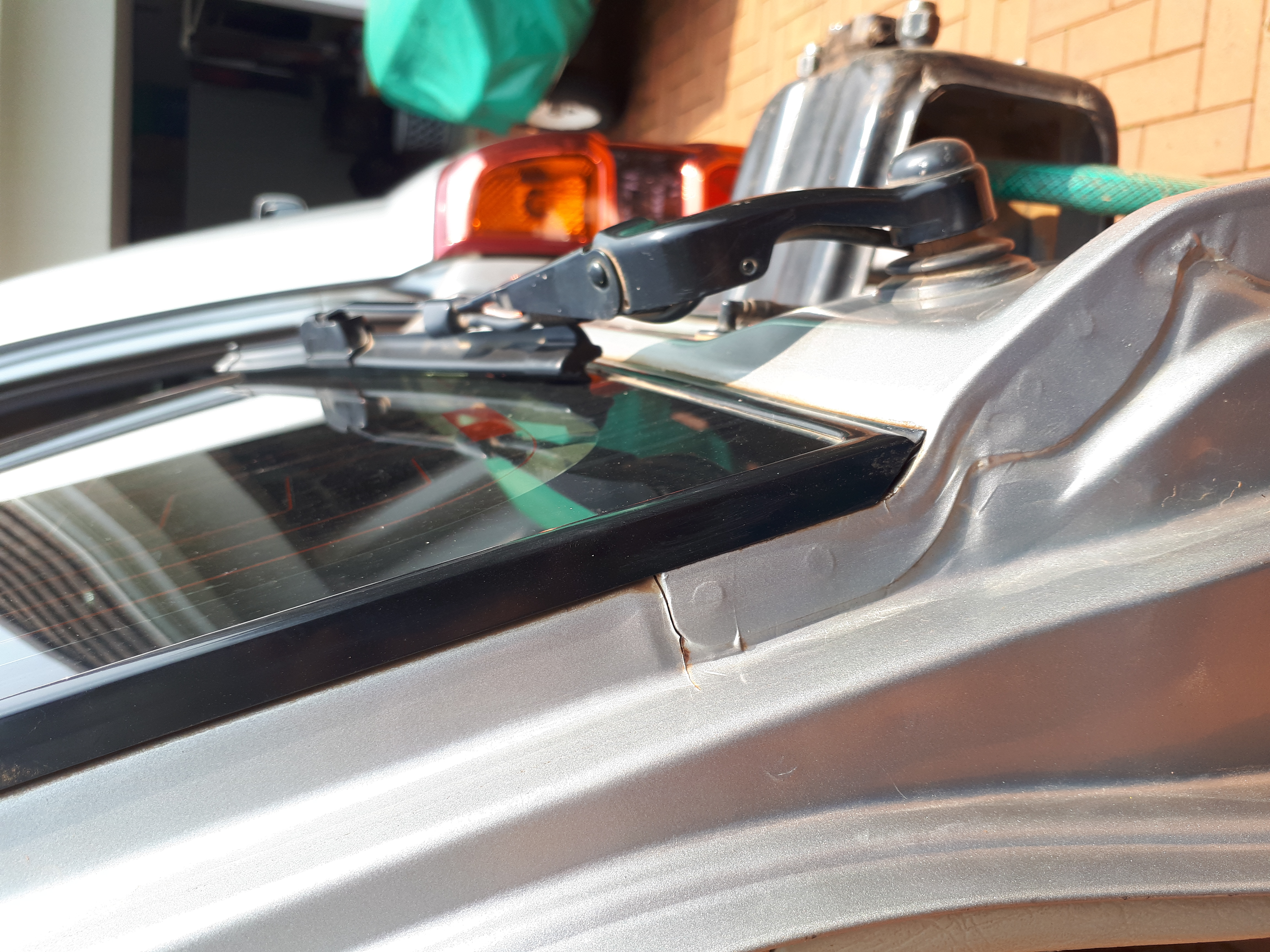

You'll need to get that repaired, but for now you may want to drill a small hole at the end of the crack to stop it running any further.

That's a good idea I'l do that thanks :thumbup: I guess if there are any positives with this it's that I managed to follow the examples in this thread and I re-alighned the door so that I dont have to slam it anymore. Also cleaned out most of the dust and repaired the seal between the panel and the inside of the door. Should be alot cleaner inside now for the next few trips...
