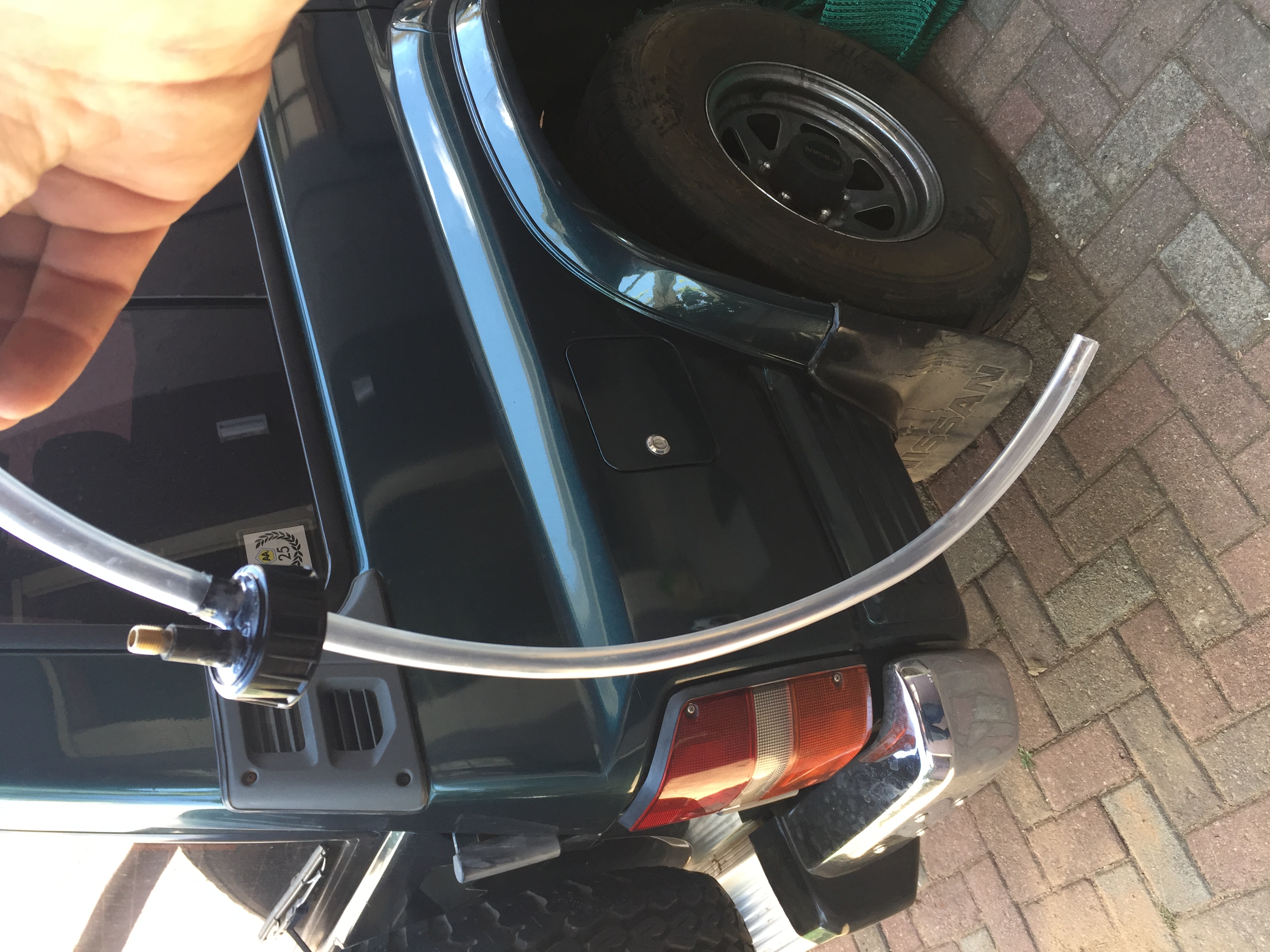

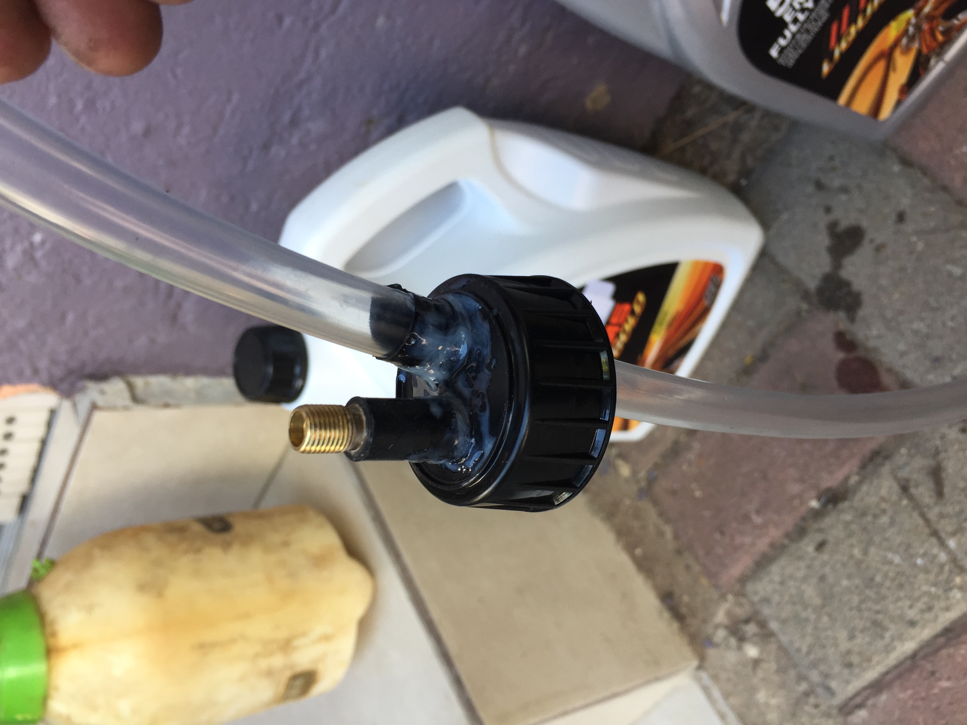

Got some 75w90 gl4 spec gearbox oil...
Constructed a lid with valve and pipe to pump the oil into the gearbox..

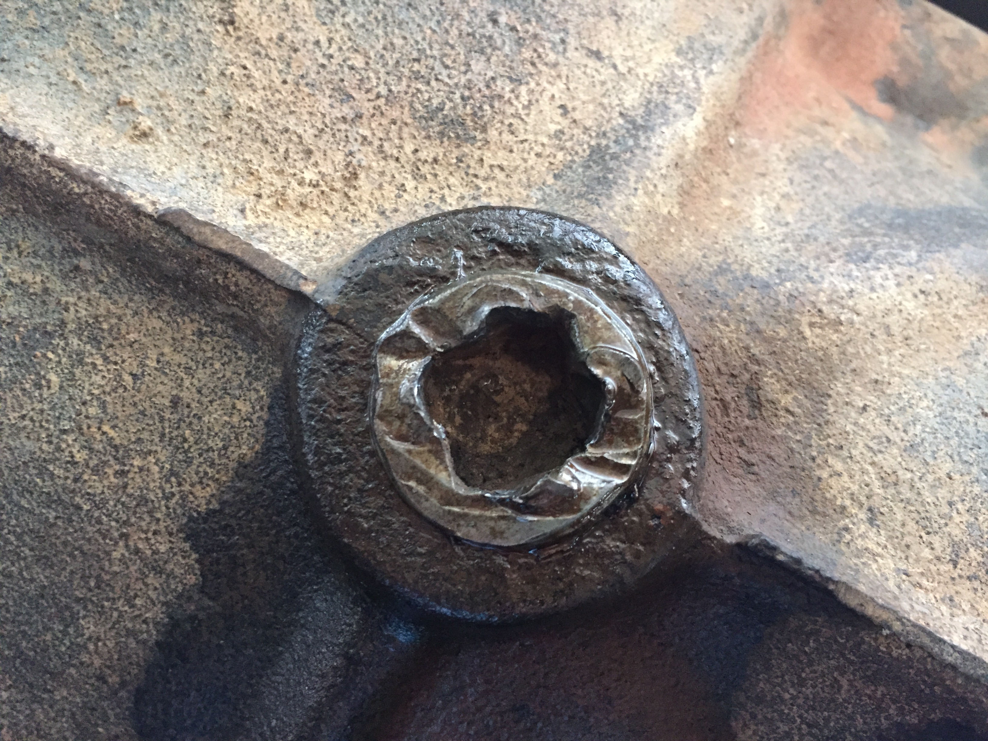

Then i discovered this.. :surprised:
Think i must first source a new gearbox drain plug incase i cant get this one back on again...that is now if can manage to open it without stripping it more than it already is...

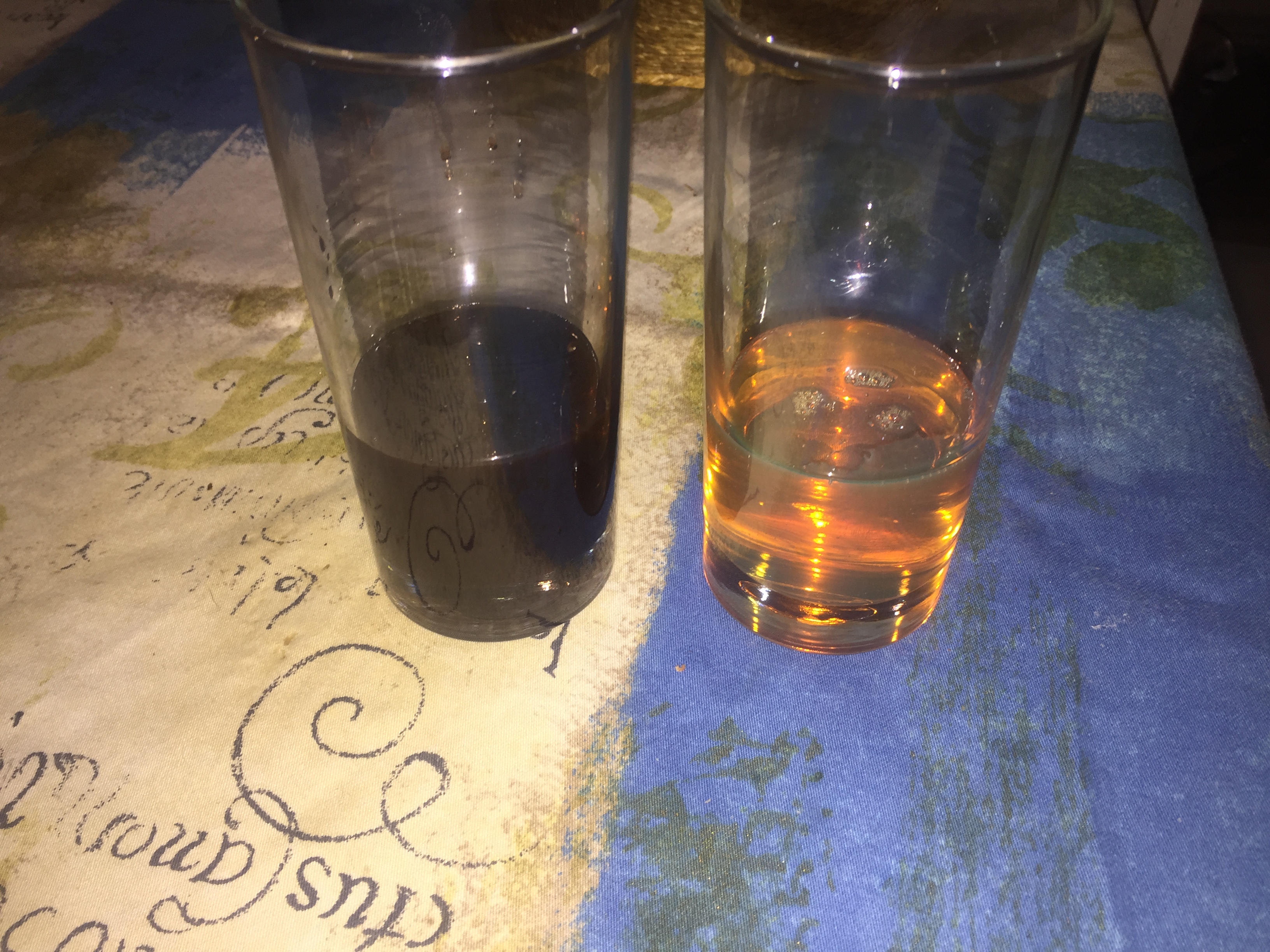

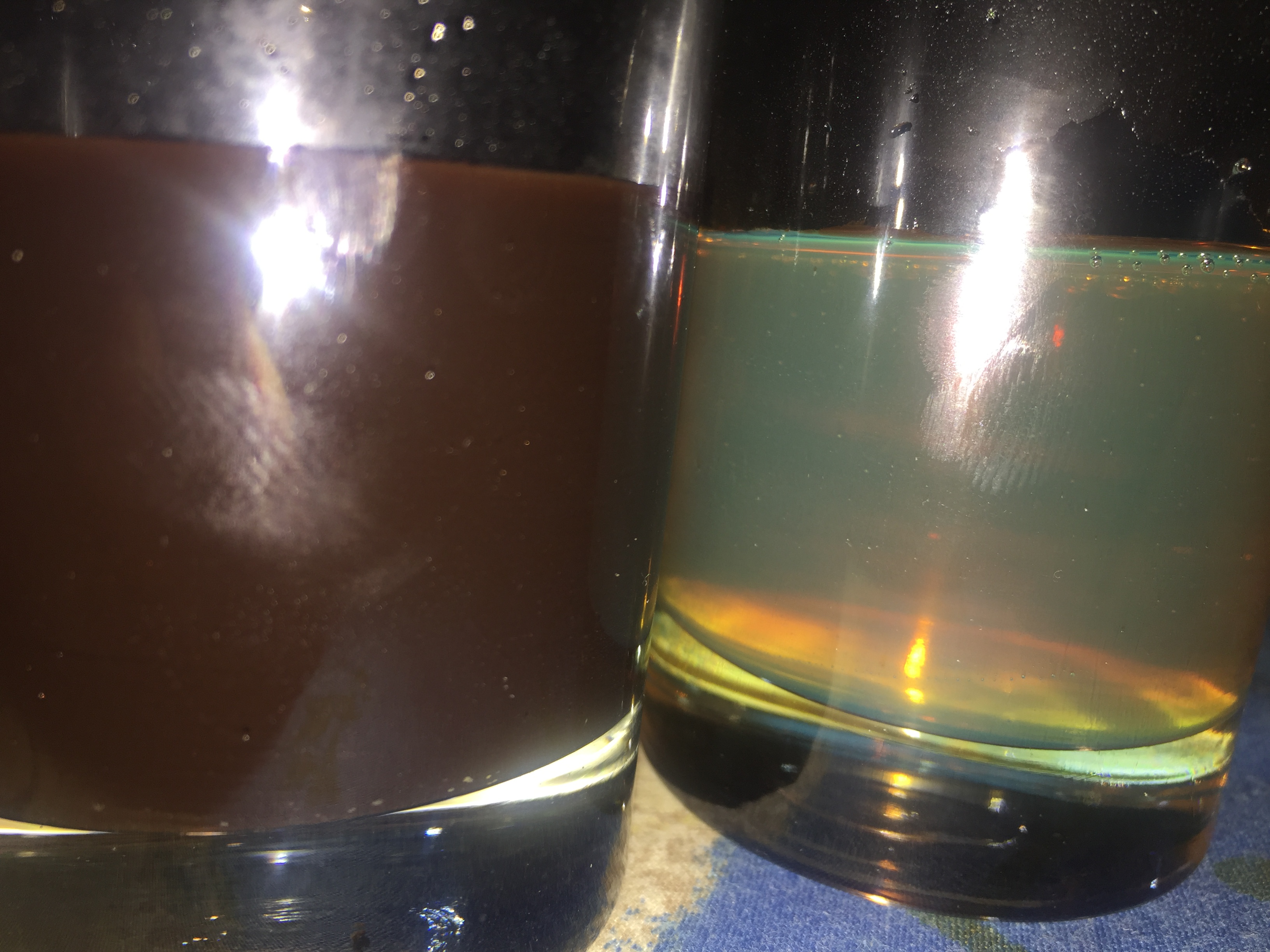

Old vs new.... :surprised:
Old oil ran out of the filler plug, can still not get the drain plug loose...
Re: Gearbox Oil change
old vs new???..... no ways that's Beer vs Brandy & Coke.... :rolling: :rolling:
