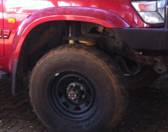

I have done quite a bit of testing with Madmans and I can guarantee you a aftermarket bumper reduces the airflow over the radiator. I have seen temps of 10 deg and more when fitting an aftermarket bumper and 7 deg higher engine temps with just fitting sporlights in front of the grille.
The rubber mats in the wheel wells also made about a 5 deg difference.
I think on the TD42's this factor is more noticable as they run a bit hotter than the patrols

Michael, please elaborate on the rubber mats. Are you referring to what I think of as mud shields behind the wheels?

Or maybe the "mat" / cover separating the front wheel from the engine bay? if so, is it cooler when they are not present?
My 4.5's one on the right is missing...

Yes those ones

Ok sorry, think I understood the question wrong.
These mats are sitting inside the wheel well basically keeping splash from the engine
