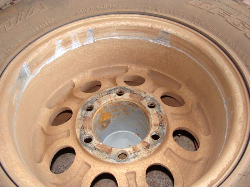

I bent two rims on the left-hand side of my old Sani roughly ten years ago. We hit a pothole on the narrow, dodgy tar road between Tofu and Inhambane and it bent the rims so badly that the tyres deflated.
Inhambane (despite being the capital city of the province) had no mag wheel repair places, but they did have a repair shop where a bloke with a large hammer and half an hour's patience d0nn3red the rim back into shape. He stood on the rim, swung the hammer overhead and brought it down between his legs, moving himself & the tyre a half a foot back every time. When the rim met up with the tyre again, he inflated it and poured water over it. Wherever he spotted bubbles, he hammered the rim some more. When there were no more bubbles to be seen, he did the same to the other rim...
It cost the equivalent of a case of beer, took about half an hour and did not result in any perceivable wobble/shake/shimmy. Maybe he just knew what he was doing? Any way, my brother in law bought the Sani from me and still drives it today (same rims, many kilometers later). He's never complained about a wobble either. Maybe high profile tyres hide rim deformities better than low profiles tyres do?
Flip side of the coin: I lost a bolt in the left rear brake caliper end of last year at Bosvark. It caused the caliper to scrape along the inside of Chuck's alloy rim, causing extensive damage. I kept losing pressure in the tyre after replacing the caliper, and eventually found that the rim had been pierced through and was leaking! Alloy rims may be light, but it seems that they're soft too... The repair bill came to R750 for welding, balancing & painting. Not to mention that it took five days and would have been impossible to perform anywhere in the bundu.
I definitely know where my vote would go!
