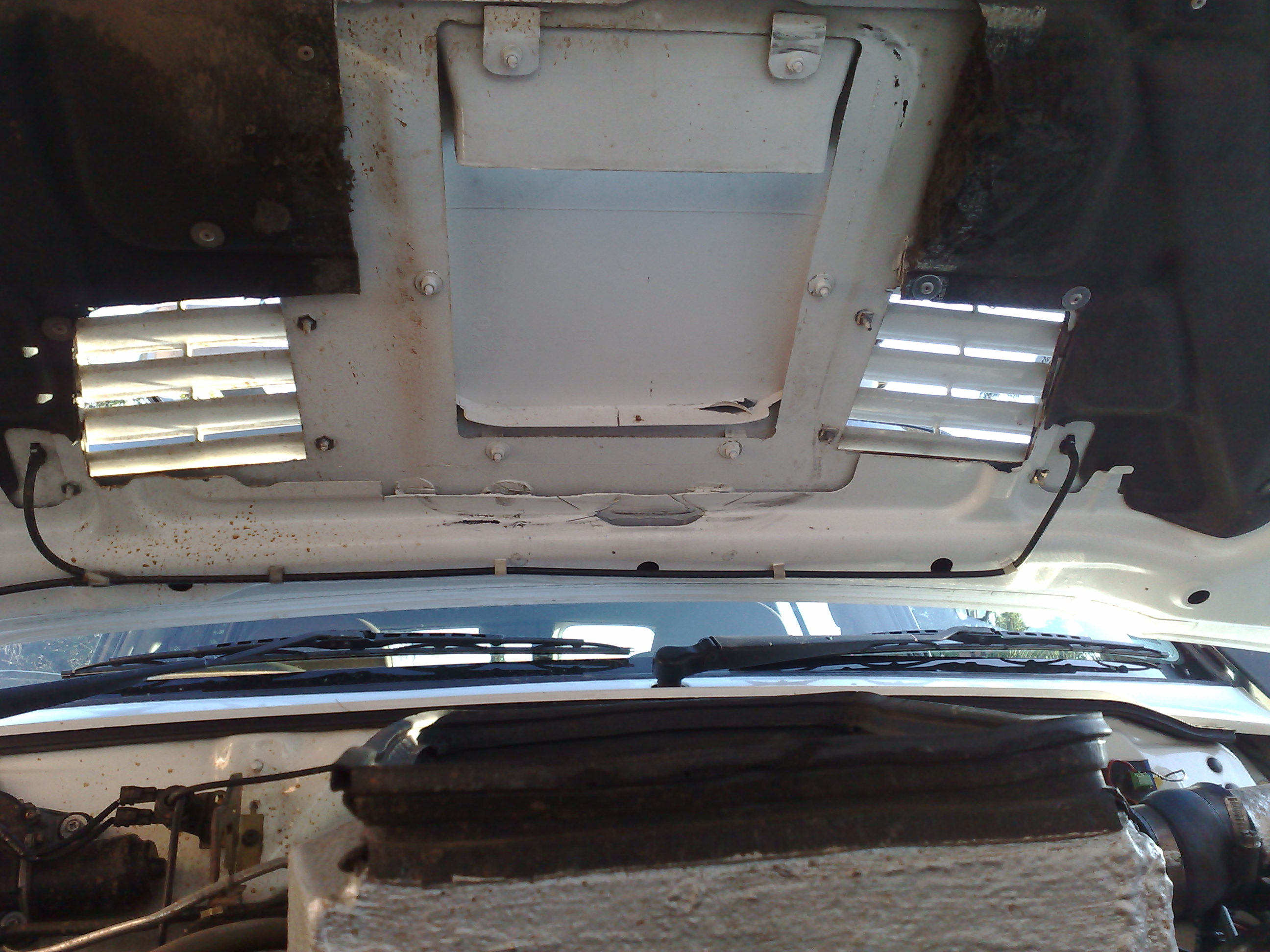

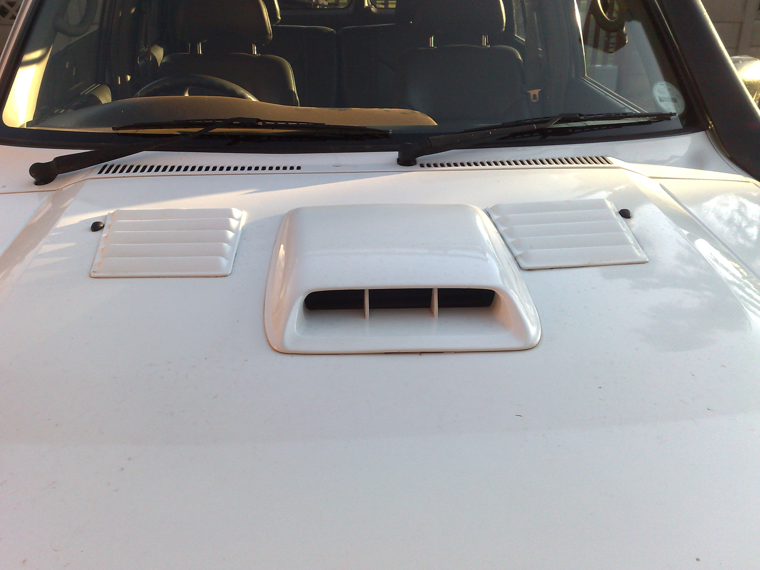

Only saw this post now. On my Maidens bonnet on each side of the intercooler intake, there is a vent to allow hot air to escape. When sitting at a traffic light, one can see the hot air "haze" bellowing out of these vents !!! I'm sure this has a hug effect in reducing the temps inside as well as assisting the fan to suck air through the radiator. My temp gauge has never been close to 3/4. The highest i ever saw the temp gauge on the dash was just a fraction over 1/2, and this was while waiting on a bliksemse hot day at one of the many road blocks while traveling back from Ponta do Oro. On my EGT gauge, I have a CHT sensor on the thermostat housing that gave me a max temp of 104 deg C. but cooled as soon as we started moving.
I bought the Maiden with the external oil cooler on, so I don't have a before and after result.
My only heat issues are my EGT's... which climb unbelieveably high very quick...... but .... I am convinced now, after Oom Mac's Dyno Day, that BOSCH have let me down, and that my diesel pump timing is a little out of whack, as the motor is VERY noisy and bellows out black smoke under all driving conditions.
I do think that it will take a lot to heat up ( I stand corrected here) 14 litres of water....and once overheated....a lot to cool it down suficiently. So the oil cooler I'm sur will definitely assist in keeping the temp down and the vents give that little extra assistance.
here you can just see the vent on the bonnet Here is a shot from inside

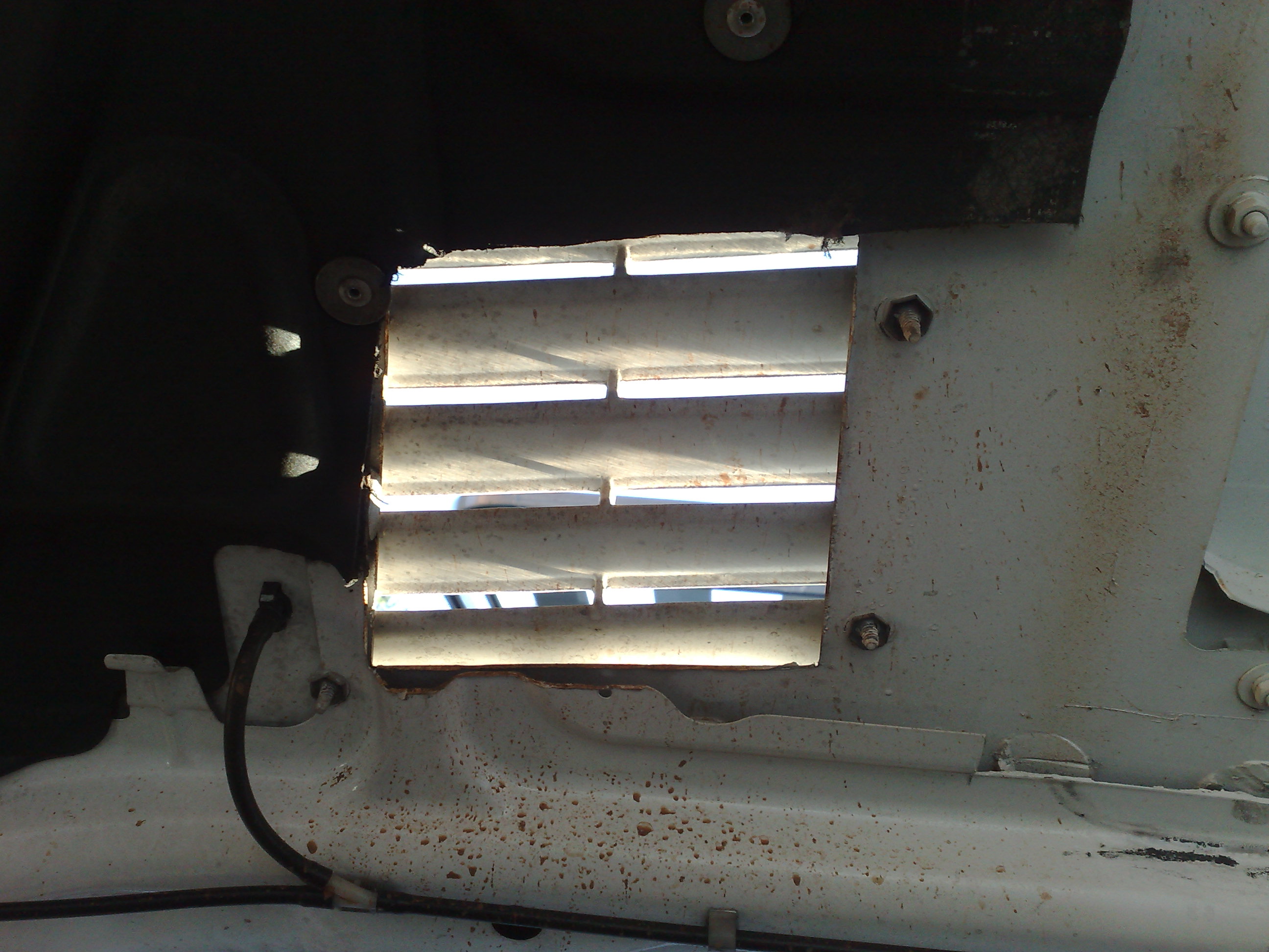

The shark gills (bonnet vents) are trapezoidal in shape and are 200mm on three sides, and 190mm on the last side

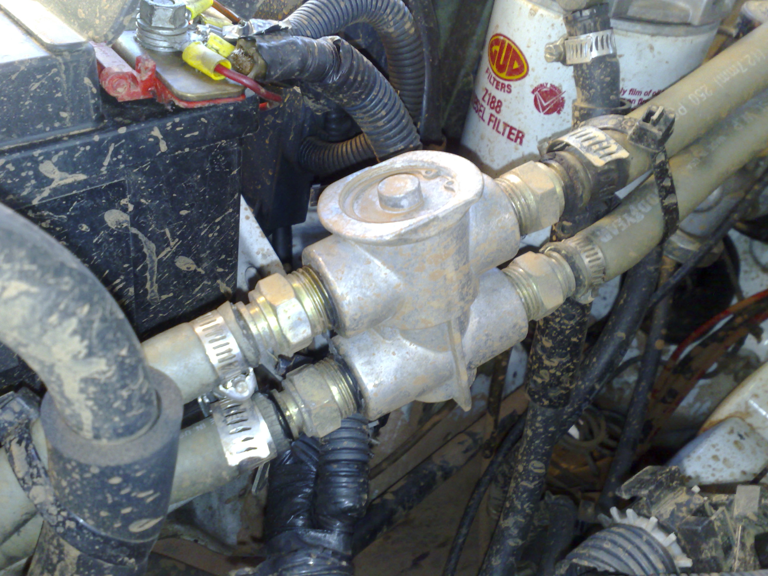

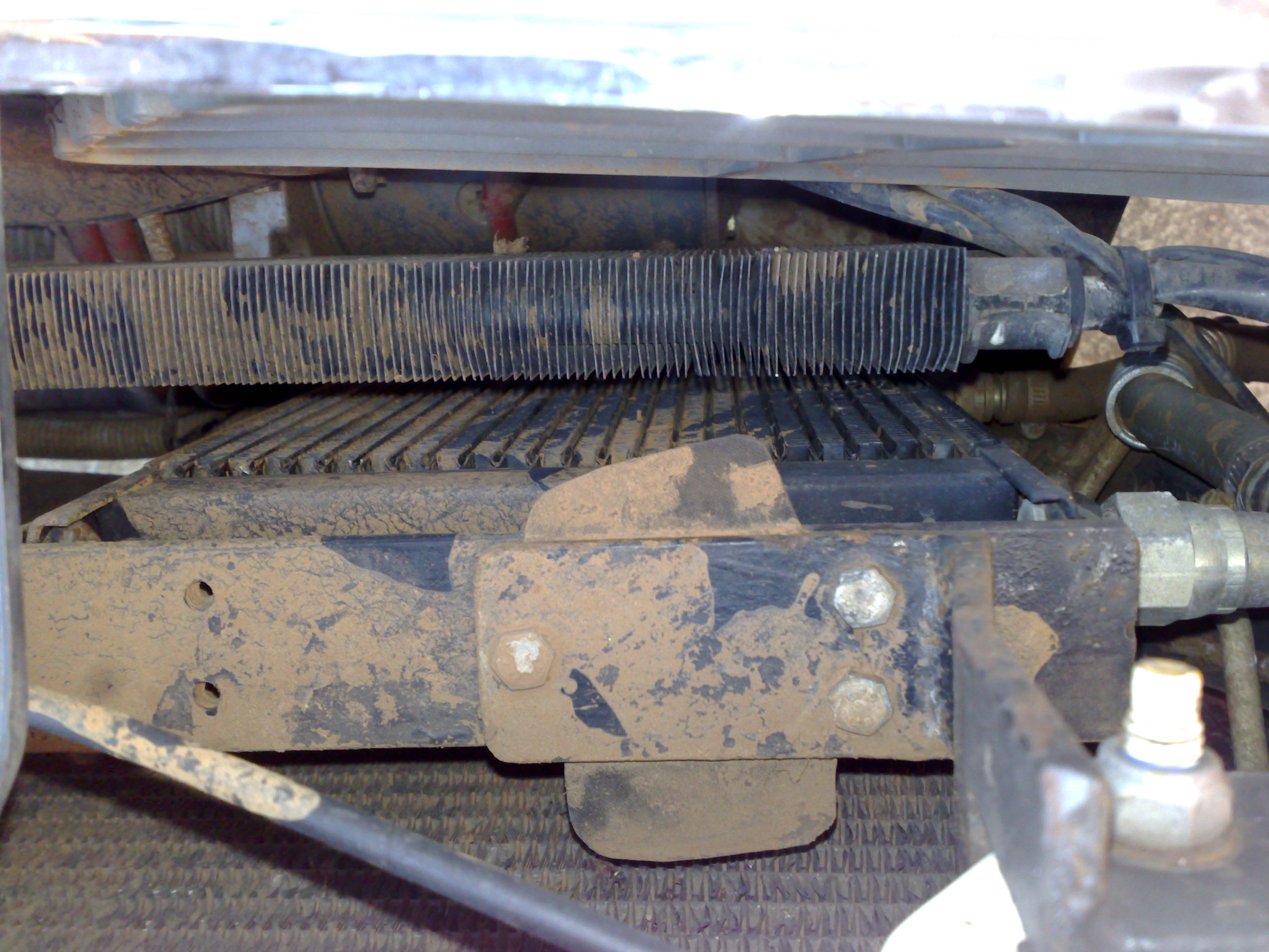

Ok ....on to the external oil cooler...mine is fitted infront of the aircon radiator, but behind another small radiator( not sure what this cools)

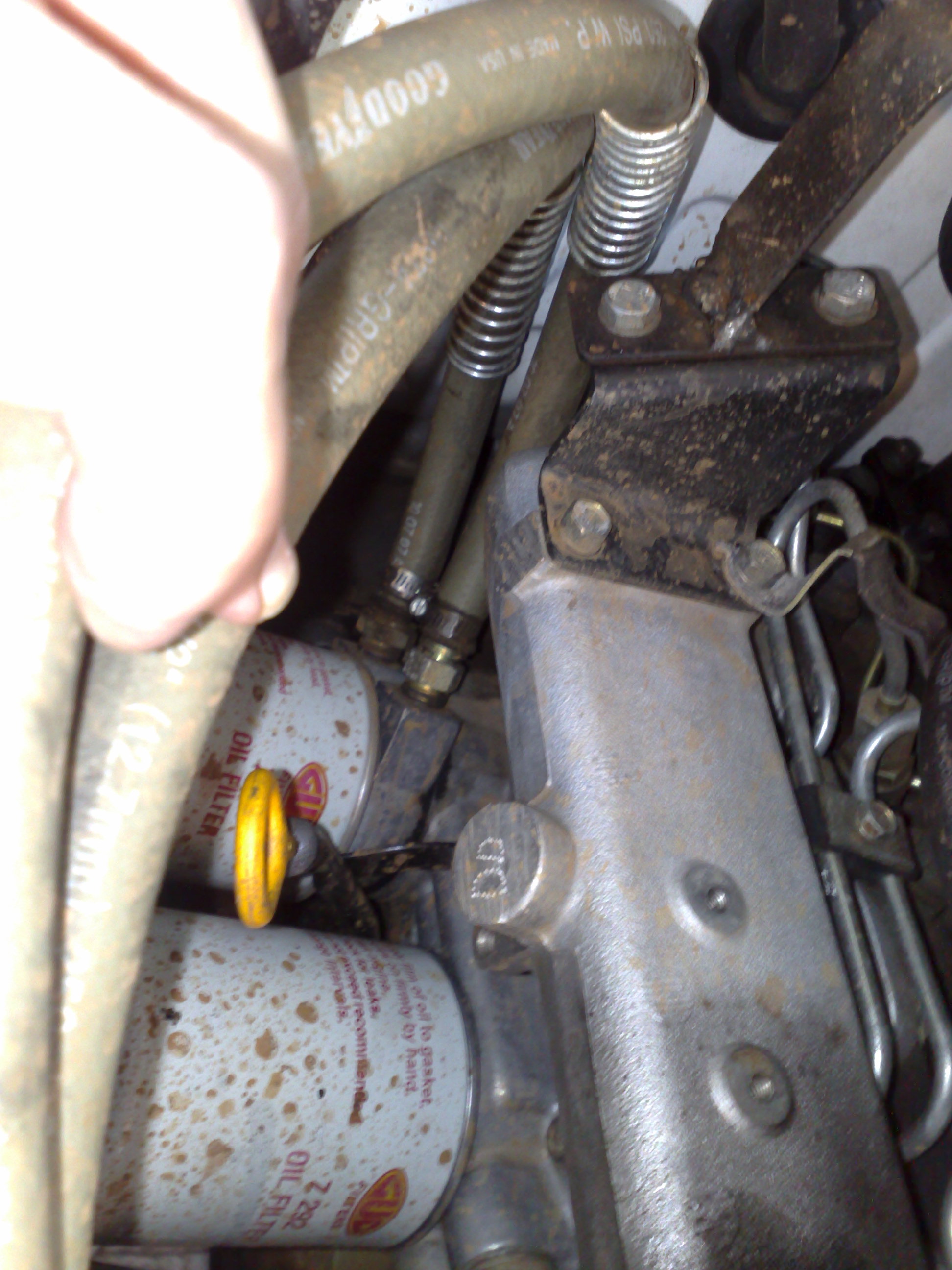

Mine has rubber hose from the adapter plate between the back oil filter and the block that come forward to some contraption (see 2nd pic). I presume there is a sensor/thermostat that opens up when the oil is hot to allow it to flow through

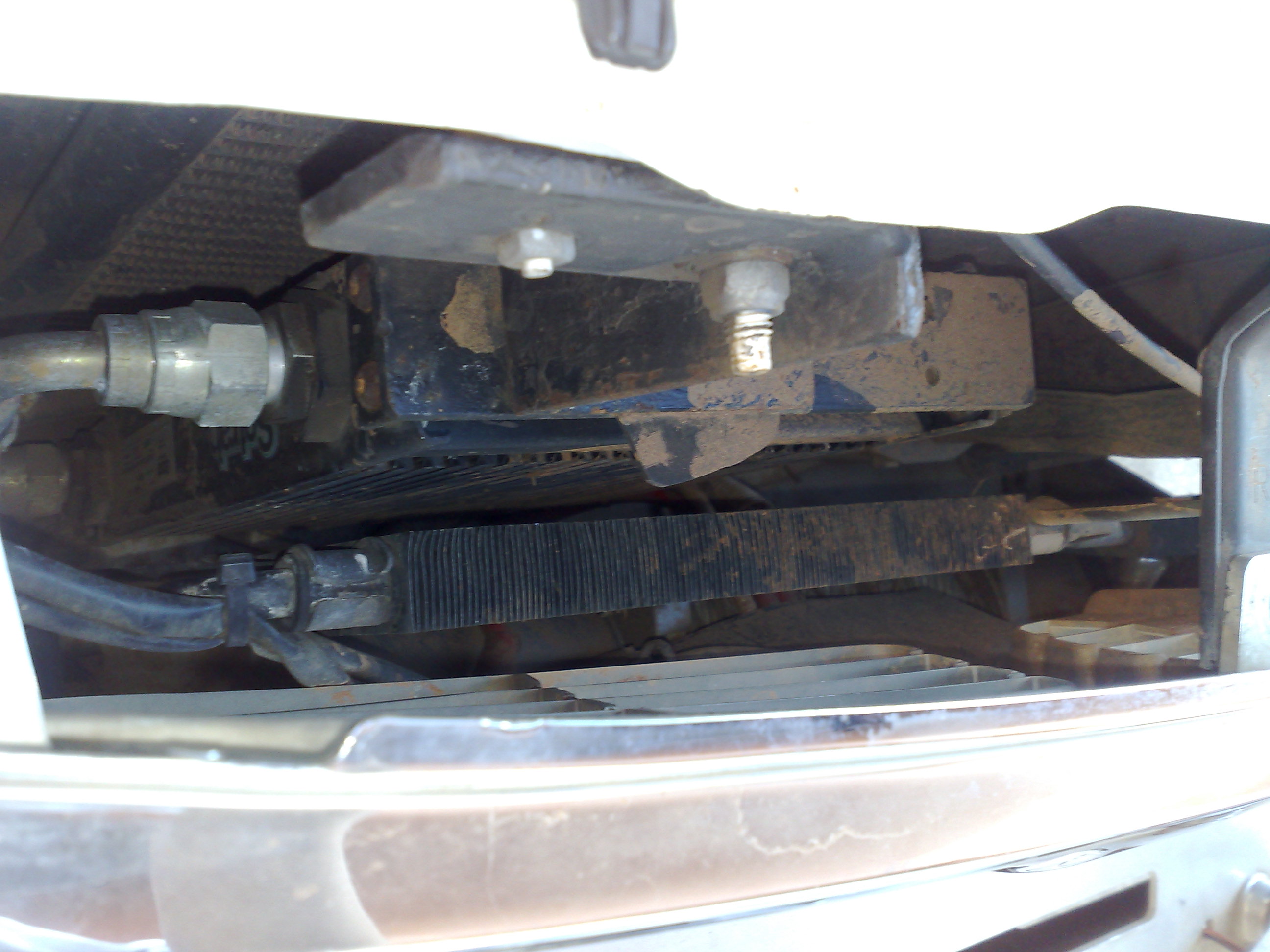

the 2 pipes feed through to the oil cooler (195mm wide and 290 mm long), one pipe fitted to the top and the other pipe sits at the bottom. The cooler is held on by a bracket across the top of the cooler.
Like I said before, I bought the Maiden with all this stuff on...so I'm not sure if it helps..... BUT.... my temp gauge on the dash has never climbed over half !! (even though its just measuring the water temp)
I have a CHT sensor that is connected to my EGT gauge, and the highest temp shown on there was 106 deg C..... and that was on our way back from Mozambique waiting at a roadworks roadblock for 30 mins with the aircon on on a flippppppping hot day.
I hope this helps

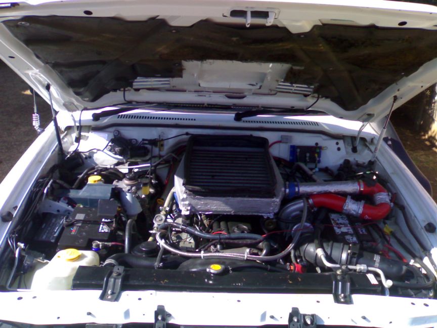

here are a few views from on top and underneath..... please excuse the mud.... haven't had a chance to scrub out the engine bay after Nissan 4x4 club play date at Bosvark... work is wild at the moment ....Sunday was a working day
