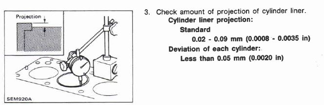

Jip, I'm going to rebuilt the motor every step of the way now with the engineer so as to double check him and to doublecheck myself. I really hope that things work out this time. Cos another rebuild will break my bank completely!! Thanx michael seeing that I'm forcing the engineer to resleeve with a sleeve protrusion I might not need the shimstock. Now the question arises how is that sleeve supposed to look with the protrusion??
Re: head coming off again
Much like the pic on page 11, just that the sleeves have a slight bevel on the ID and OD
