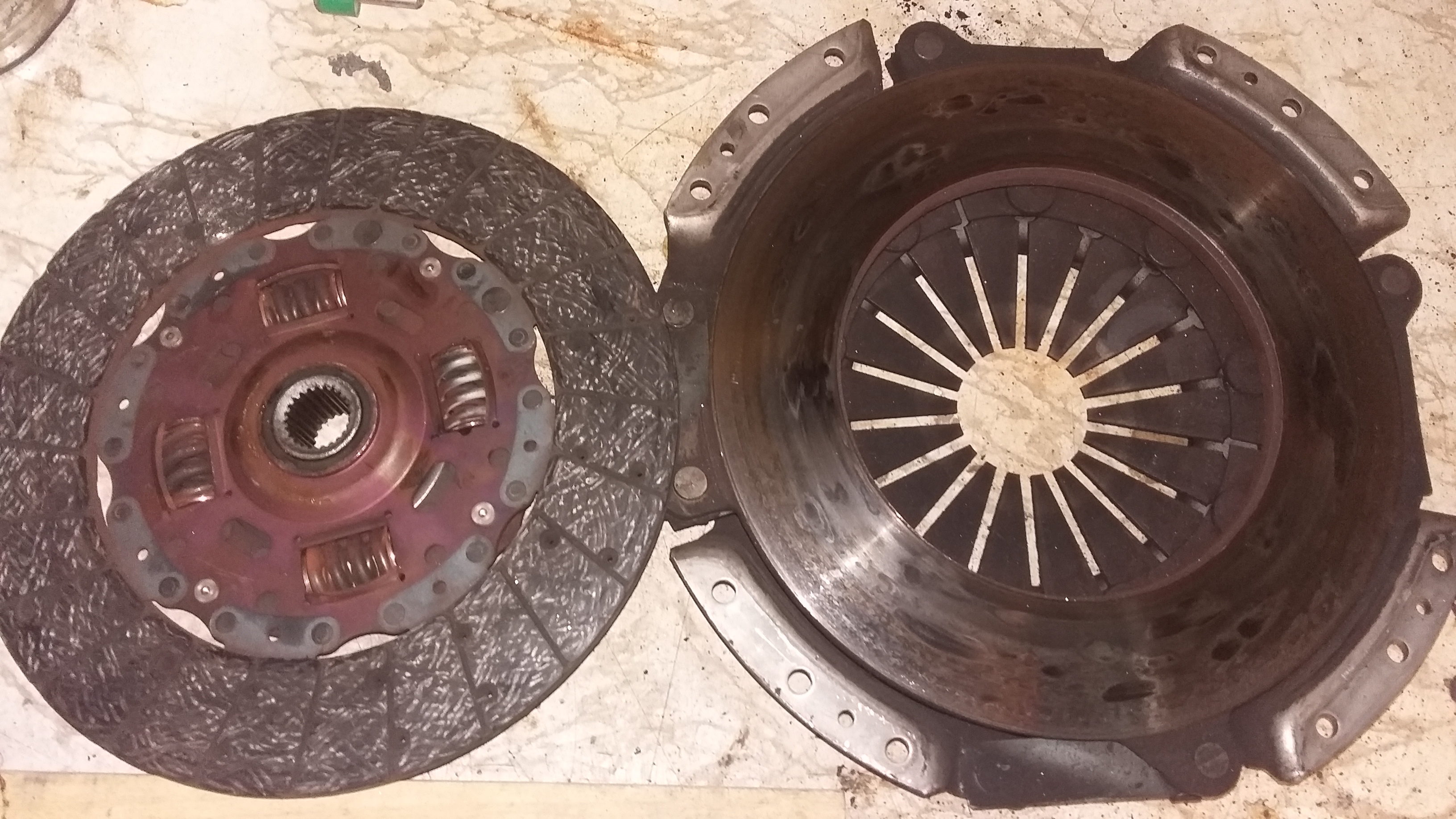

Here's what a 19 year old (original) clutch with 247000km looks like.
Pretty impressive it's never been changed since the car was built !
Check out the heat marks.
