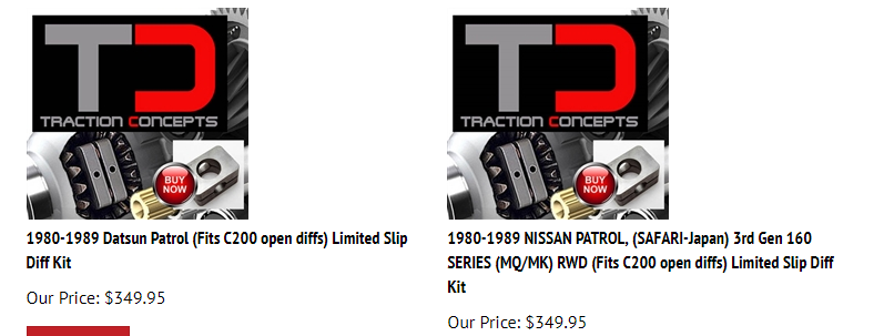

Resurrecting and old thread, but the info/question is relevant without starting a whole new thread somewhere else..
Question???... will a locker or LSD listed for a rear diff, work in a front diff of the same model. In other words, if I find a LSD for a C200 listed for a rear end, will it be able to run in a C200 front diff.
I found via a drifting forum, a LSD listed for a R200 diff from the old skylines and Z cars. The internals are supposedly the same as the C200 diffs. Following the breadcrumbs, I came across www.tractionconcepts.com who cover a massive model range. I sctratched around a bit and got these results for the old 1980-83 Safari bakkies and Wagons.
https://www.tractionconcepts.com/search ... ol&Submit= They however do not specify if you can use the device in the front as well.
Based on this, I scratched around the Lokka site, and found some options for the C200, but they all seem to be listed for the rear end. So again the question, can this Lokka be used in the front C200 diff? $300 odd sounds a damn side better than the ARB R26k option. Any experts here that can tell us if these units are direction specific.

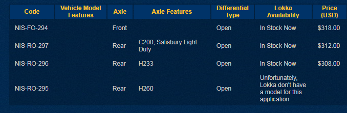

Thanks Malcolm. I also worked out the Lokka will end up cheaper. I think you are right in the difference being the spline counts. And I think if the Lokka works in reverse, I see no reason why it can't work in a front diff. I have attempted to fill in the vehicle details, but I don't know exactly what they were, and have even less chance of tracking down the VIN number. I could ask Reenen if he happens to still have it, but he stripped that Safari down as far as I know.
I sent Lokka an email query on their site yesterday, but have not got a reply. I suppose I also need to pull those shafts and do a spline count so I know what to ask for in the first place.
I have manual freewheeling hubs, and they will be unlocked on any tar surface, so I won't experience that locking and unlocking you did. My fear is that I am running out of time before Lokka decides its no longer viable to keep these units for a 40 year old diff model.

Just found this in my spam box now.... Seldom check, so lucky for me.... Email from Lokka
David,
Sorry for the delay - things are very busy here !
Your inquiry has prompted me to check the integrity of our model listing !!
The Lokka model you mention is listed for a 4 pinion C200 differential (for a Navara rear) - yet the internal parts we list to build that kit are for a 2 pinion C200 - and that makes no sense to me.
The Lokka model NIS-FO-294 is what you would need as far as I am aware - that is failry standard globally I think. - Its a 2 pinion C200 differential
One of the problems is that the manufacturers often released quite different parts and differentials in one world marketplace than they did in another world marketplace
We often only find out when something that should fit, doesn't fit !
The model I believe is suitable is in stock and would be the default selection on the online Lokka Wizard
Patrol, Safari
Global
K160, KR160, TR160, Y160 MQ MK Series
Front
1980-03
Open
NIS-FO-294
C200 2 pinion Salisbury
Looks like I have an option for the front end after all. I have requested confirmation of the spline count for that kit they have. Now I suppose I must pull stuff apart on mine to check the spline count here.
This will be the second Lokka I import, and the price works out nearly identical to when I went through this process in 2008. And I was also trying to import for my C200 rear end I had in the Sani. We somehow got it wrong, and I ended up with one for the H233.
MMmmmm, now to find R5500 for this little upgrade...
David,
Patrol, Safari
Global
Front
1980-03
Open
NIS-FO-294
