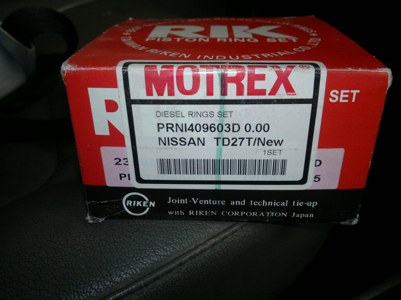

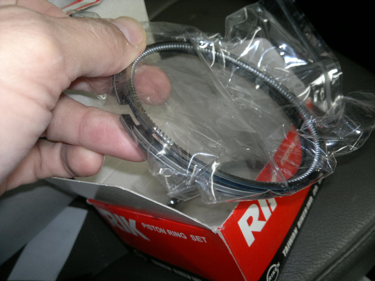

Morning all,
Here is the alfin rings part number. I still have 2 sets, so if you get the identical type you are welcome to take these off my hands....doubt I'll ever need them again...
As for the shimstock..... I hunted through my garage like a madman..... Eish..... I think my kids got hold of it or something, cause she is not there by the place where she was when she was there...
